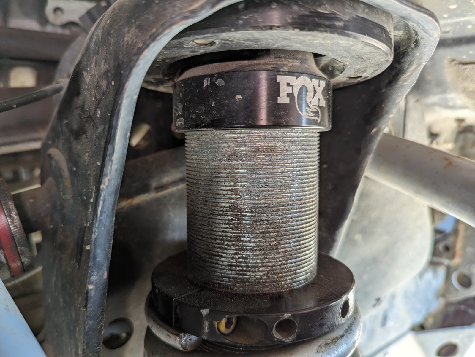

    What’s up guys,
    I was wondering if anyone with the fox 2.5 resi have been able to adjust the preload while still installed on the truck? I have the fox spaner wrench but it doesn’t fit with the resiviors. Or will I have to get them taken off the truck to adjust them. I want to crank them down a few turns to get 1/2” to 1” more lift.
    Thanks for any info or advice.

    At the very least you will want the weight of the truck off the suspension. So jack it up safely till the suspension hangs, or put it on a vehicle lift. You should be able to turn it then.

    Cometspop here I tried adjusting mine while on truck with susp. hanging,did'nt work out ,messed up the adjusting nut and it takes many rotations to get that 1'' of lift you want.I removed it built a jig ,bolted it to jig ,screwed jig to workbench & still needed to have a friend hold the coilover strait up & down.I cranked about 7/8'' installed them the ride was horrible like no susp.at all.Did it all again put that all back where the smart guys set it at FOX & learned from it.those coilovers look too bitchen to mess up .good luck

    Buy a t handle coil over adjustment tool. It goes in the holes on the adjustment ring and gives you a lot of leverage. 1/4 inch on the coilover translates to 1/2 inch lift, 1/2 inch on the coil over translates to 1” of lift.

    Yes. I just actually did this. I had to lift my UCA up so that I had enough space to use my Spanner Wrench. However, if I need anymore pre-load, I’ll have to take them off and use a compressor with the spring.

    Ditch the spanner wrench and get a punch set from harbor freight. There is one (I forget the size) that fits exactly in the holes. Jack up the truck to take the weight off, loosen the collar set screw (but not too much or you will jump threads) and then turn. A little lube on the threads doesn't hurt either. I've done this numerous times and mine turn pretty easy.

    @LDS 77 yes, you CAN do it. Doesn’t mean it’s the recommended way. If you decide to try, droop the suspension off the ground so you remove the spring force as much as possible. There’s a small allen screw, 3/16” I believe, that you’ll need to loosen but don’t loosen it too much. If you back the allen screw out too much and try to turn the collar, there is a possibility that the collar will skip threads and you’ll have an entirely different issue on hand.
    As stated, you may want to try a punch or other tool than the spanned wrench as the coil bucket limits your access.
    The recommended way would be to remove the spring entirely and adjust the collar but that’s obviously more work.

    Spray the threads with lube, lift the truck up enough to get the wheels off the ground and give it a go.

    That is the plan! I was hesitant since the threads are aluminum and some folks say you can stril the threads or the preload disc can skip some threads. I've also heard from a buddy and a few on this forum that it is done pretty easily. Thanks will update. This is where the shop put my preload a year or so ago lol

    Don’t back the set screw out too far and you’ll be fine. I’ve gone up and down a few times without a problem. But I’m careful about it all.
