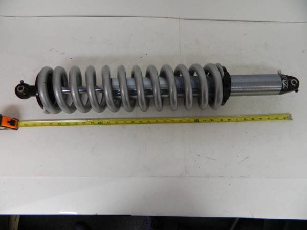

    Found these online for sale at a pretty good price and not quite too good to be true, he has lots of pics.
    My question are these worth the gamble of fitting them on my Tacoma? I won’t know the weight of the eibach springs and I would need to find the top “adapter thing” (not sure what it would be called) to fit the truck. Anything I’m missing, otherwise I’ll take a shot and see what I get. I’ll post more pics and measurements if it helps.

    what's a pretty good price? you'd probably need different misalignment spacers on the lower mount as well

    those are not the right shocks for your truck.. the Fox 2.5's non resi look like this.
    I am not sure how you would even mount those safely in your truck.

    Haha pretty much what I figured but I wasn’t sure what I’m looking at.
