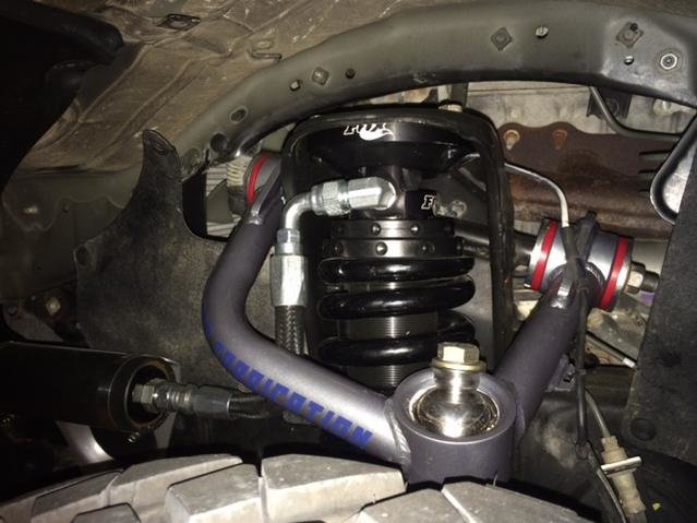

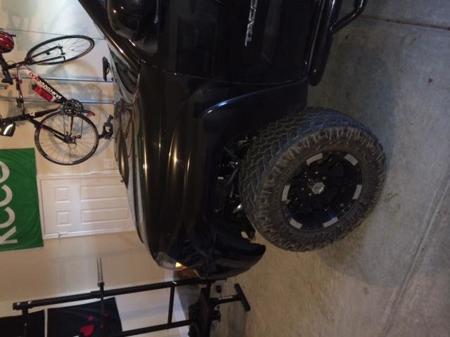

    MadMedic35
    MadMedic35 [OP] Well-Known Member
    Jan 12, 2013
    #95000
    129
    Sandhills, NC
    09 TRD SPORT DCSB
    Fox 2.5 coilover, TC UCA, FOX 2.5 res rear shock, OME leaf pack, SCS Ray-10 gold, Nitto Ridge Grappler, SoftTopper. On order: Relentless Fab Summit Bumper, HC rear bumper with tire carrier, sPOD, Powertray,
    How is it worthless without pictures? There are numerous threads on here of 2nd Gen Tacoma with Fox Shocks and Total Chaos Uppers. It's not a how-to thread; just me closing up a discussion I started this summer while deployed.
  20. Nov 25, 2013 at 1:28 PM
    #20
    MadMedic35
    Jan 12, 2013
    #95000
    129
    Sandhills, NC
    09 TRD SPORT DCSB
    But here you go..
