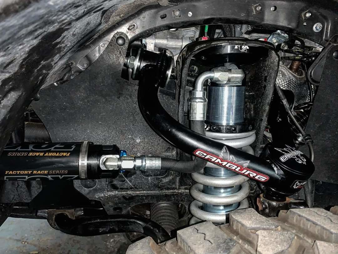

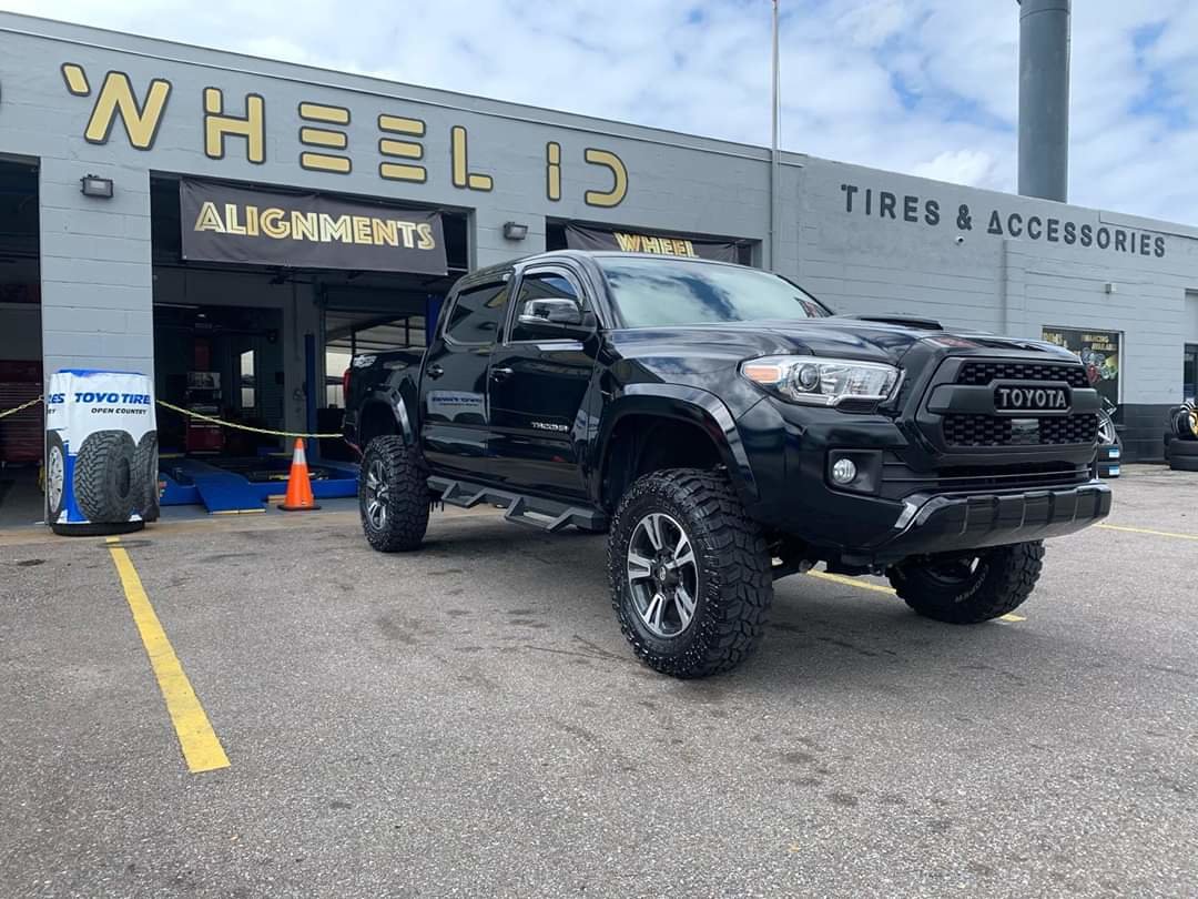

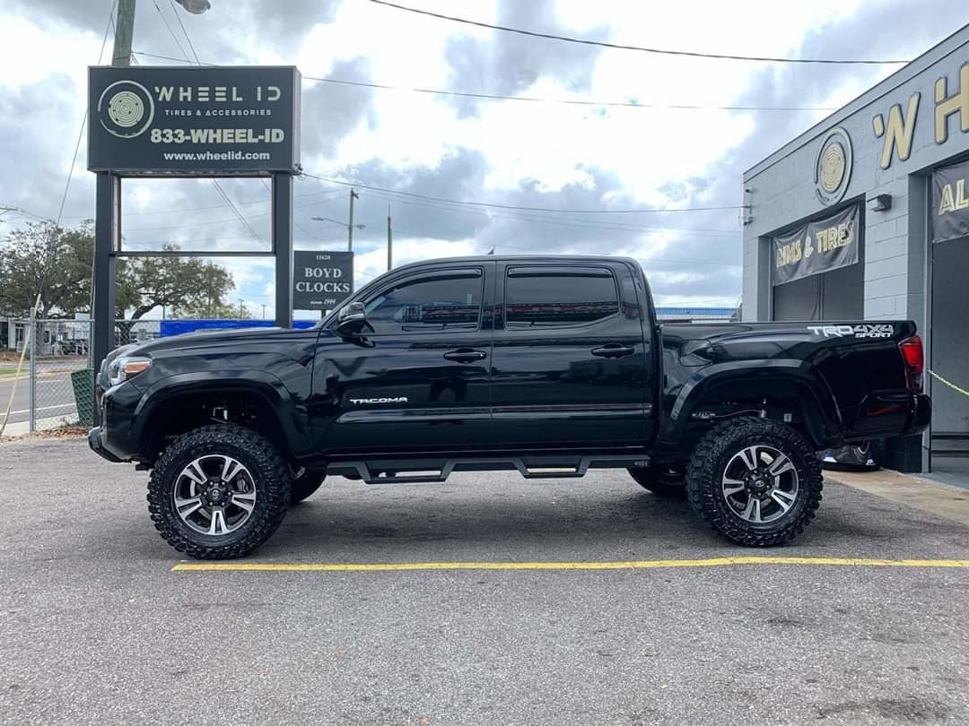

    32 threads showing on Fox 2.5 coil overs DSC at first a little rougher than factory but than playing with the adjustments it is better than factory I called fox they didn't recommend going that high but I did get 3 inch's over stock which that is what I wanted I have a 3inch block in rear Fox 2.5 coilovers dsc front with camburg upper control arms non uniball and Fox 2.0 adjustable rear love it.

    Looks like you got a lot of preload. Height looks nice but ride will suffer..
    @AccuTune Offroad these guys are always helpful if you have any shock related questions..

    Ride is way better than factory and yes got ECGS DONE

    Looks freakin great by the way.

    Definitely looks like too much preload, but if the OP doesn't have an issue with the ride then :thumbsup:

    You may want to rotate that remote reservoir some more, see the fox logo better and easier to adjust the DSC.

    Accu tune send me a pic of that drivers side because I didn't think it fit right on that side my passenger side looks just like yours on the pic perfect !

    Same bracket, just different side.
