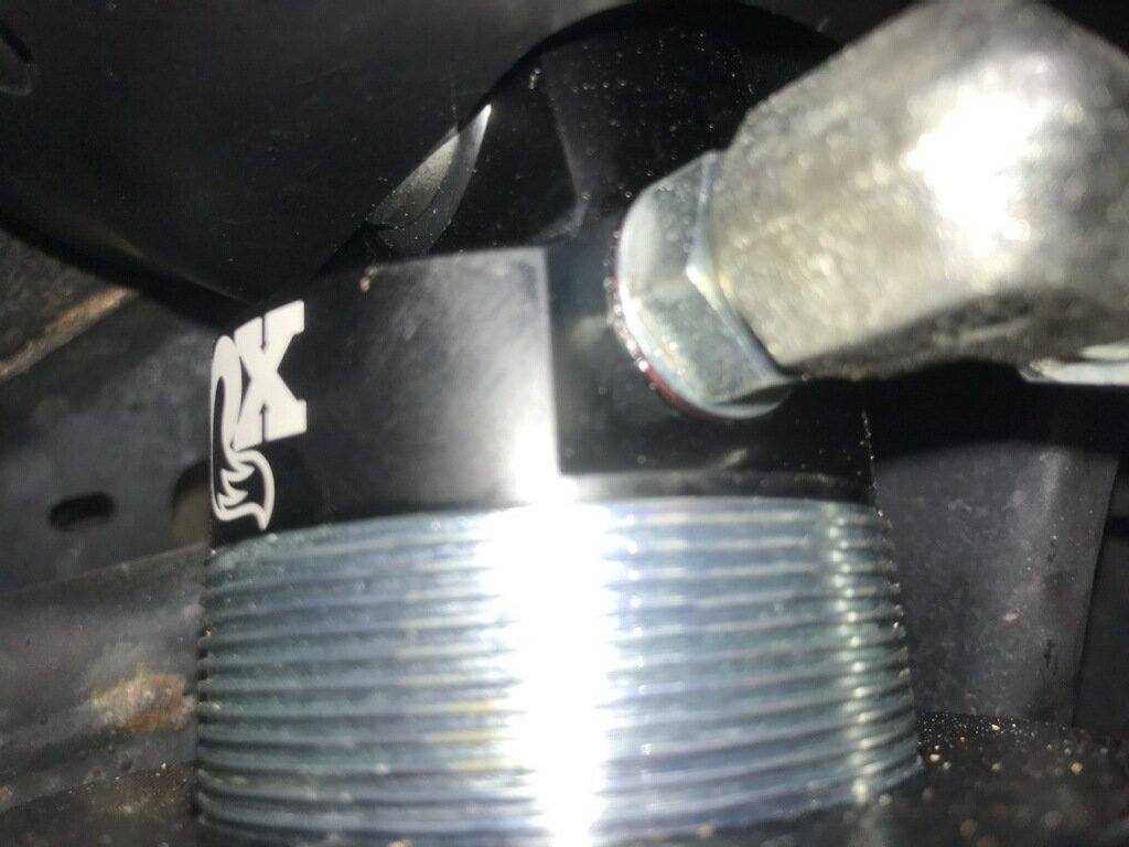

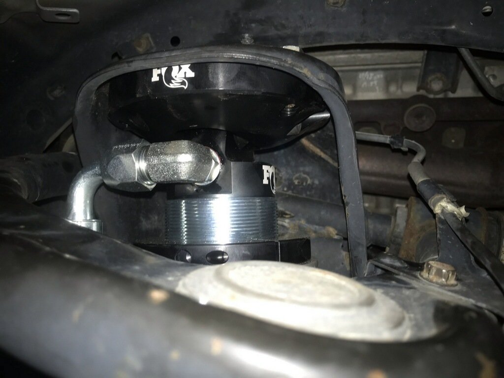

    Just finished installing my BRAND new fox coilovers and took the truck for a 1 Mile trip and the hydraulic fitting coming out of the shock body is leaking! Is this normal?

    I wouldn’t call that a leak. It could be the assembly grease they put on the o-rings during assembly. That grease will start to solidify when heated up.
    Is there a a puddle of oil anywhere?

    Looks like grease from assembly... as it heats up it will weep a bit... if you clean it up it shouldn't come back unless it is actually leaking. But if in doubt just put a wrench on it and snug it up if needed. My sockets also fit that bolt fine, maybe find a thinner socket... my garbage freight socket fits.

    No Puddle, I don't think its anything too serious, just a small amount of oil around the fitting. Looks to be static in size, so probably just grease.

    Sounds like it. Wipe it off and keep an eye on it. If you notice a drip line then I’d be concerned.
