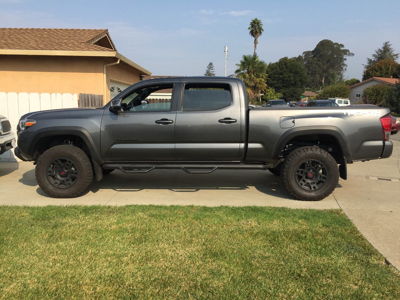

    Before lift:

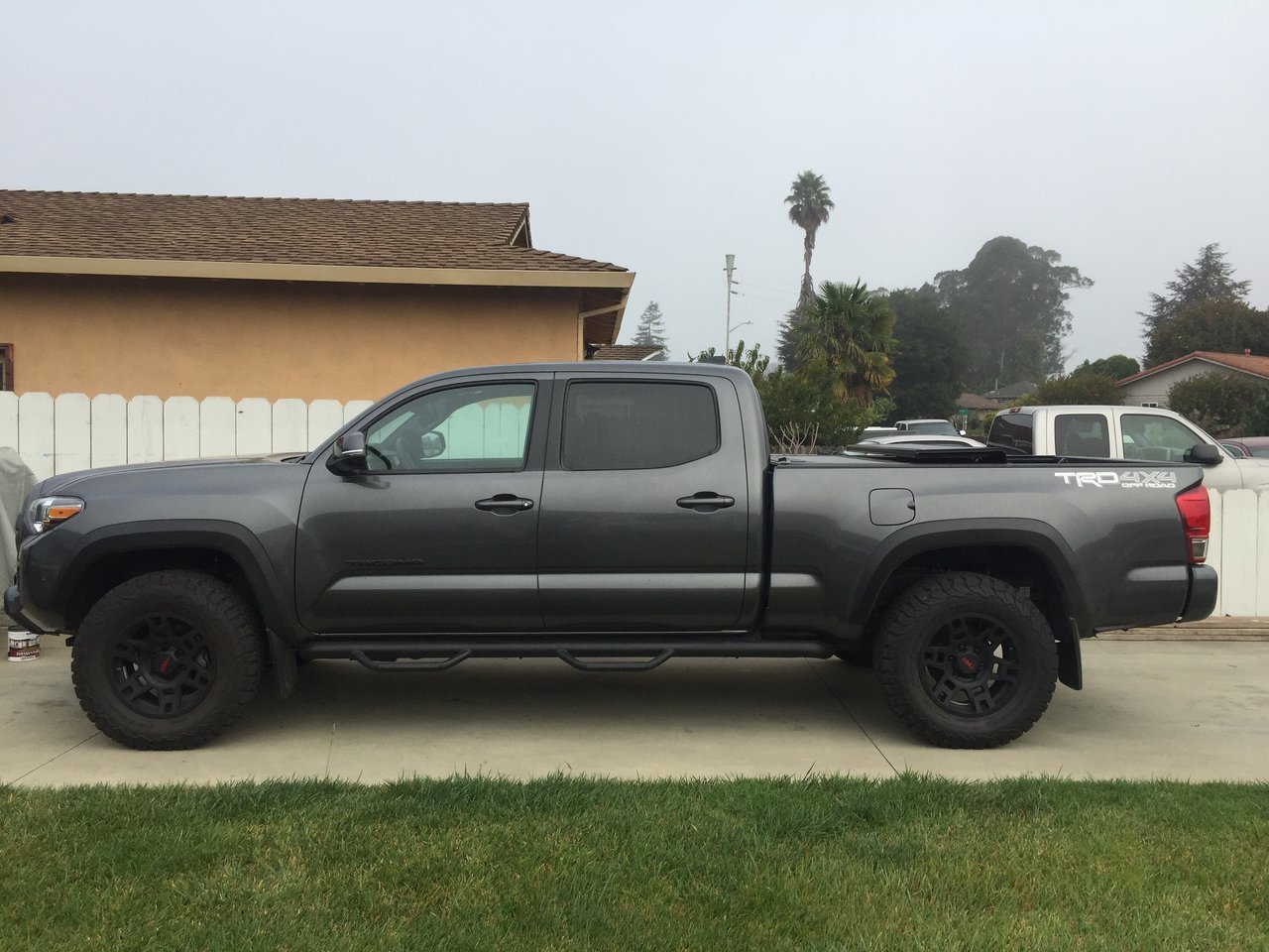

    After Lift:

  12. Sep 20, 2017 at 8:49 PM
    BlackTacosMatter92
    BlackTacosMatter92 Well-Known Member
    Dec 22, 2016
    #205518
    611
    Jay
    2017 DCLB Tacoma
    King Suspension SPC UCA's Dakar Medium Leaf Packs Nitto Ridge Grapplers 255/75/16 VTX Vipers 16x8 (-12) Mobtown CMC plates Mobtown Sliders Smittybilt X20 10k Synthetic Factor 55 Fairlead & Flatlink MBRP Off Camber Fabrications Front Bumper MBRP Black PowderCoat Exhaust RX350 Projectors TRD Pro tail lights Truxedo Lo Pro QT Tonneau RCI Bed Rack Total Chaos Bed Stiffeners ARB CKMA12 CustomCarGrills Grille Line-X'd Grille 20% Window Tint (Front/Back) 75% Windshield 5% Visor Debadged
    Thanks! Looks great! What did you do for lift in the rear?
