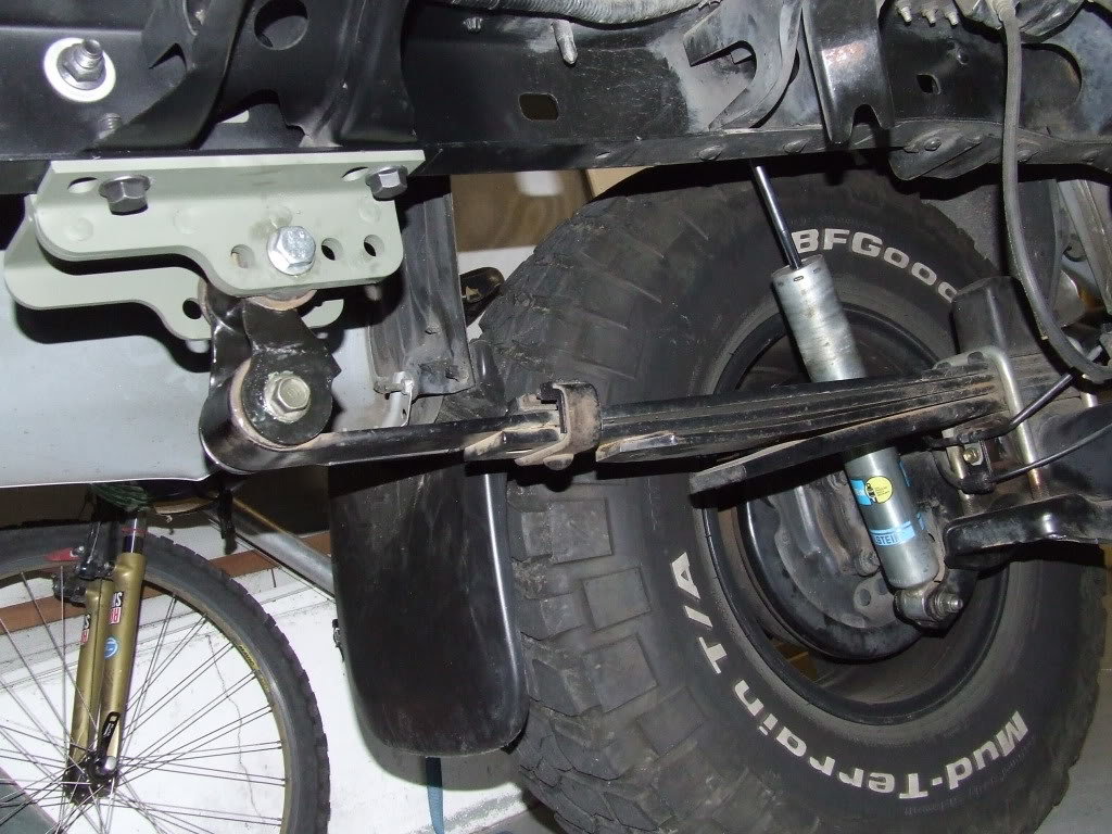

    U-bolts face up instead of down, so you dont have them dragging on the rocks/dirt.
    Stock shackle
    See how the bushing that's connected to the the leaf spring is on top?
    Shackle flip
    This adds more rear ride height and more droop/flex. As others have said you do have more negative arch on your leaf pack (you can see in this photo the leaf springs are basically flat), but I think that's generally with just stock leafs. Aftermarket leaf packs or a progressive leafs wouldn't have an issue. Also, I've been told that your rear can feel more floaty on-road. Which is why Toyota inverted it on the 2nd gens + to help on road feel.
