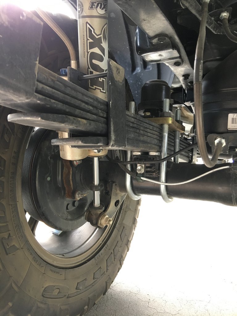

    wouldn't the bump stops limit wheel travel? or are they made smaller.
    And can't tell from pic but did the sway bar connect to the reservoir?
    And got a link for which u bolt flip you used?

    I wanted to avoid bottoming out the shock. Not sure if it would without them but you can see in the pic how much they compressed by the rubber ring on the shaft. I had the 3/8" spacer but took it
