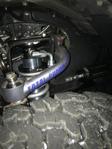

    I just installed some fox 2.5s and got her all buttoned up. The coilovers came adjusted for 1" lift over factory. Obviously I want to go more, This is where my question comes from.
    Fox recommends using a spring compressor before adjusting the preload ring. Problem is the coilovers are on the truck and it would be a pain to remove them from the truck over and over again to adjust. The body of the shock looks too close to the coil to even fit a spring compressor on them..
    Can I get away with taking all the weight off the front end, and using a spanner wrench to adjust? or is the compressor necessary? whats everyone doing? any tips for me?IMG_1473.jpg IMG_1468.jpg

    Adjusting the spring preload on your coil over shocks is no different than adjusting the spring preload on an adjustable spring preload coil over motorcycle shock, which should be done by lifting up and unloading the suspension, which you should do to take the load off of the threaded aluminum shock body and the preload adjuster nuts so you don't strip the threads on either of them
    So IMHO, jacking up the front to take the weight off of the springs is all you need to do and you do not need to compress the springs with a spring compressor. A good tip is to always thoroughly clean off the dirt from the threads on the shock body and then apply some lube to the threads prior to adjusting the preload nuts, then clean off the lube when your done so as not to attract dirt.

    I just jacked up the front, and sprayed a little bit of WD-40 on the perches. Spins freely with no issues.

    Perfect. Thanks guys.... i was super scared when Fox recommended a spring compressor... there was no way that would work..
    any tips on a good spanner wrench? the fox one is $50, pretty pricey.. I see some guys using 1/4 punches, i tried that and its making the holes oval shaped. i don't wanna keep cranking with that and ruin the collars.

    Measure the OD of the preload adjuster nuts and try and find either a fixed or adjustable spanner wrench to properly fit the notches on the adjuster nuts, and never ever adjust the reload nuts using a screwdriver or a punch and a hammer, as with one wrong slip, the tip of a screw driver or punch can easily damage the threads on the shock body, then your adjustment days are over, plus it just makes the aluminum preload adjuster nuts look like hell.
    If you don't want to spend the $50 that Fox want's for their spanner wrench, McMaster Carr sells a large variety of sizes of fixed and adjustable hook style spanner wrenches, but you may find that its an odd ball size and you'll need to just but the wrench from Fox, and it's always best to have a fixed hook style spanner wrench as opposed to an adjustable hook style wrench which are more likely to slip out of the notches on the adjuster nuts than a fixed style wrench that is made to fit the adjuster nuts.

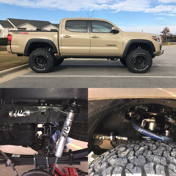

    Yes I lifted the rear with some OME Dakar leaf packs.
    The whole set up is night and day better over the stock TRD off-road suspension. Much more plush and smooth. The rear leafs are a little stiff while unloaded. But still much better.B68CF48C-9AD7-4961-8CB5-B419516F6D45.jpg
