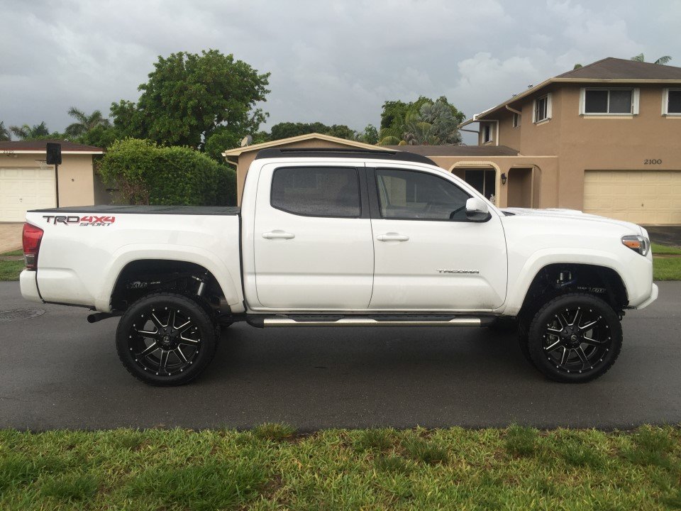

    this is 265/50/20 nittto with the front CO 37 1/2 from floor to fender

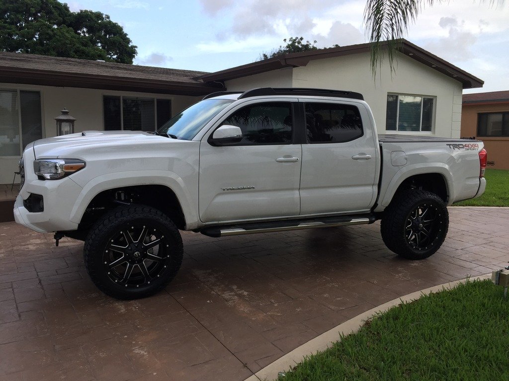

    this is 285/55/20 with open country. I preloaded some more. know I'm 38 3/4. I totally like how it looks know with 285. and yes some trim was needed.
