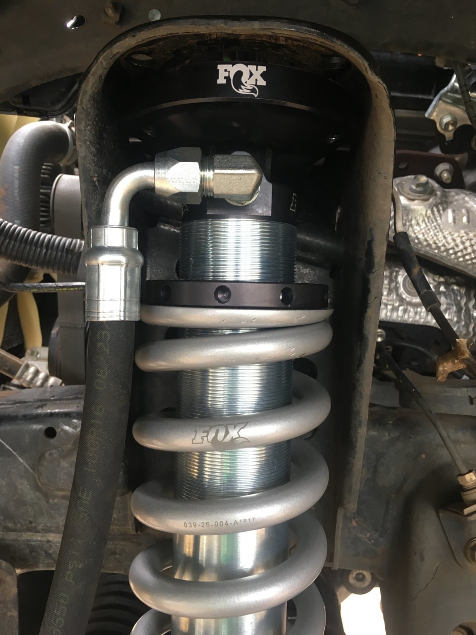

    Ok just to clarify, I CAN loosen the keeper nut while the coilovers are off the vehicle to move it outward?

    Yup done it a ton of times

    Thanks! Worked perfectly. I just turned the keeper nut outwards for now, will adjust my height after I get the rear done

    This is exactly what I experienced. Had to take the coilovers to an offroad shop that used a spring compressor to compress the spring and adjust the collar.
    Glad you got it sorted out! :thumbsup:

    Just a heads up for everyone that hasn't installed yet.
    Loosen the screw on the adjustment collar. Put the coil overs on your truck. Once they're installed, spin the adjustment collar to whichever direction you choose, so that the screw is accessible once they're actually on the truck. Count your threads, and match each side then tighten them up.
    Now you don't have to take the coil overs off to make height adjustments.

    same thing happened to me. I think I tried to warn you bout that... prolly too late now? but if you're still in pause, loosen the set screw and turn that thing 180 before you bolt it in. or loosen the set screw, install the coil and torque it down, then turn the collar to desired height and tighten the set screw.

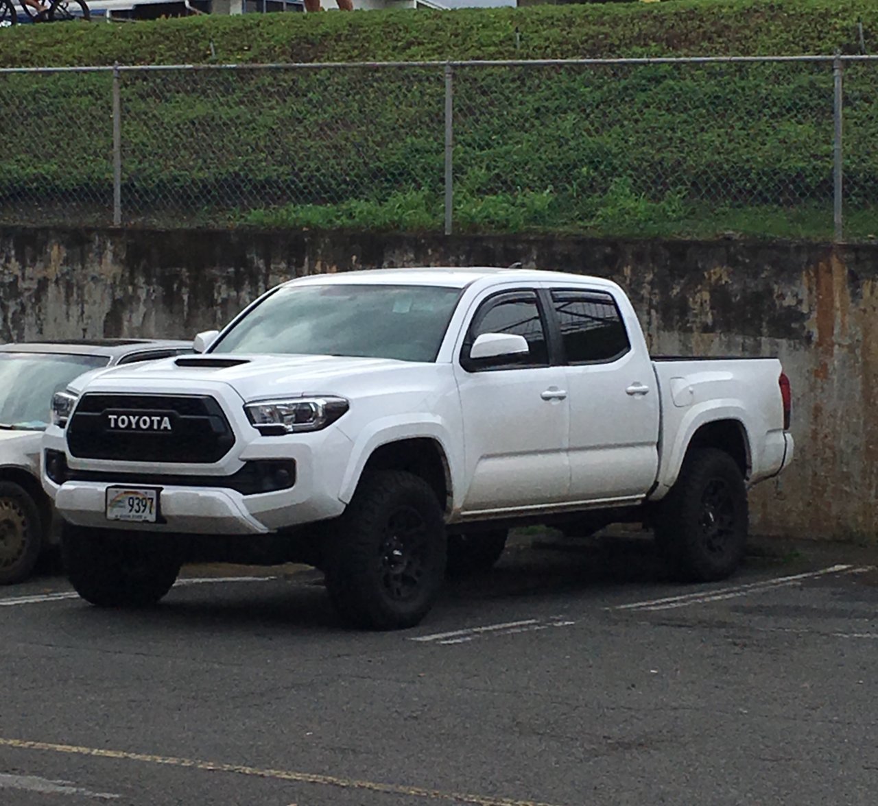

    Finished my install, its too late for pictures right now. I took it on a test drive down a pothole filled dirt road and noticed some rubbing when hitting deep bumps. Is this likely an alignment issue? Currently running 265 k02.

    Yes, alignment needed. Bump your caster to at least 2.5 and you should be golden.

    Waiting for alignment. I haven’t taken fender to hub measurements but after install my front end looked leveled, then settled to a slight rake. I’m going to leave it at preset height until i upgrade to bigger tires.

    What size tires are on right now? Truck looks awesome as is.

    265/70/17 K02 on TRD SEMA. My original plan was to set the front at 2” but it looks perfect to me as is. Will definately crank them up to 2.5” when I upgrade to 285’s.
