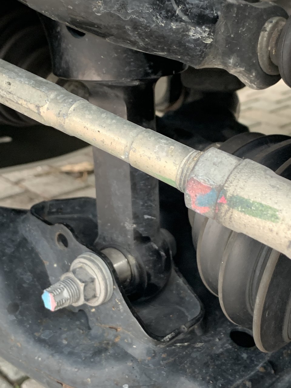

    Has anyone run in to this issue and figured out a solution? Seems to be some rubbing on the back side as well :/. 3rd gen fox 2.5 extended.

    I’d assume that’s from the install.

    Do you have a misalignment spacer on both sides of the rod end? Looks like you only have one...

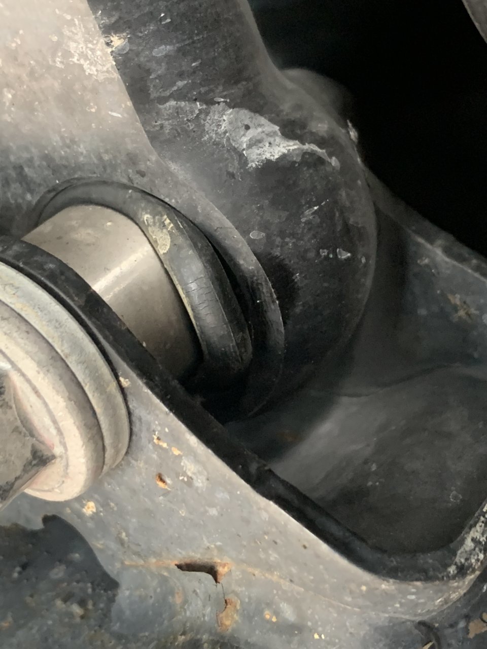

    I know it’s been like 3 years from your post but I’m having exact same issue on the passenger side after only 6 months. I was wondering if you figured out the cause of it? Thanks

    I assume your looking at it because it's making a noise? I have done several trucks where its been crooked. Nothing to worry about. Ended up replacing that lower bushing or heims because they go bad and squeak.

    Well actually mine doesn’t squeak just looks like yours on the picture kinda squeezed out rubber and it’s only been like 7 months and 6k miles. I was just doing tire rotation and noticed that. I’m honestly not looking forward to replacing bushings twice a year. So any idea what is causing it? Driver’s side is perfect. Maybe when I was adjusting coilover eyelet wasn’t perfectly square against the lower arm seat? Thanks for your time. It’s really slim to none info about this.
