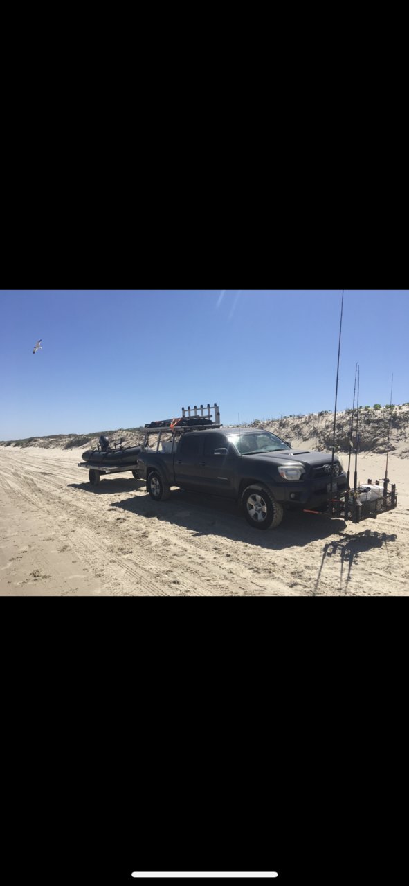

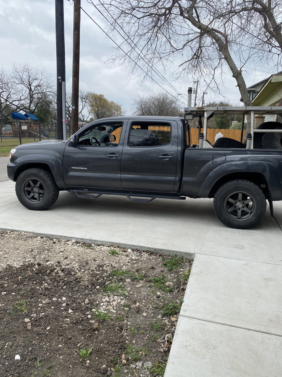

    I’ve been reading threads for months and still feel undecided.
    2012 LBDC 4wd 165k miles. Stock Suspension is gone. Rough country roads and highway driving. Offroad driving consists of beach driving 15-40mph through soft sand and washouts. Just looking for 2” or a little less if front. 1.5” in the rear. Don’t want to upgrade uca.
    Fox 2.5 front 0-2”
    Fox 2.0 w res rear
    Icon aal
    $1958
    vs
    6112/ 5160 3rd clip w/ spacer
    Headstrong aal.
    $1411 assembled.
    Around a $550 difference. Any and all options appreciated
