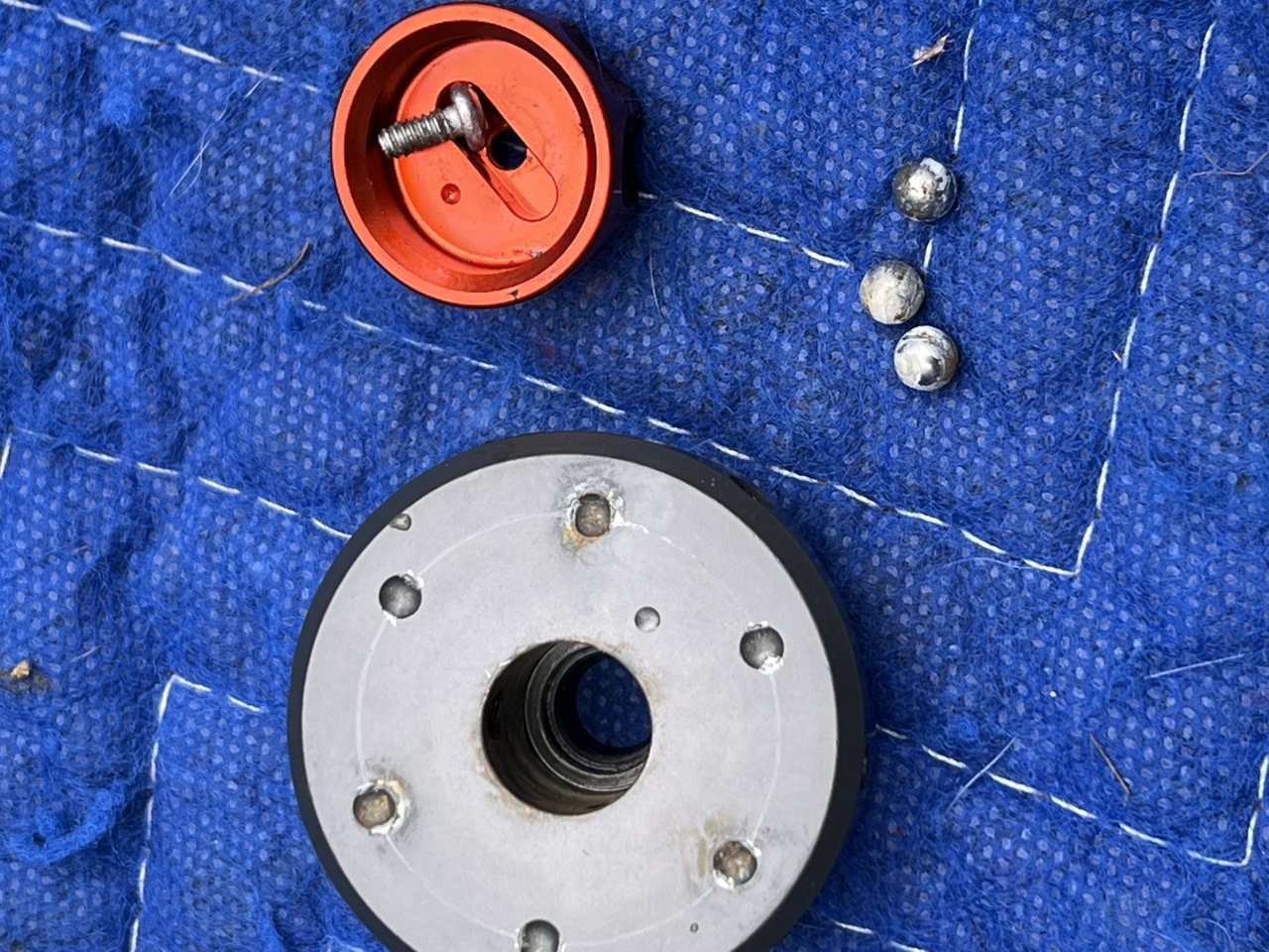

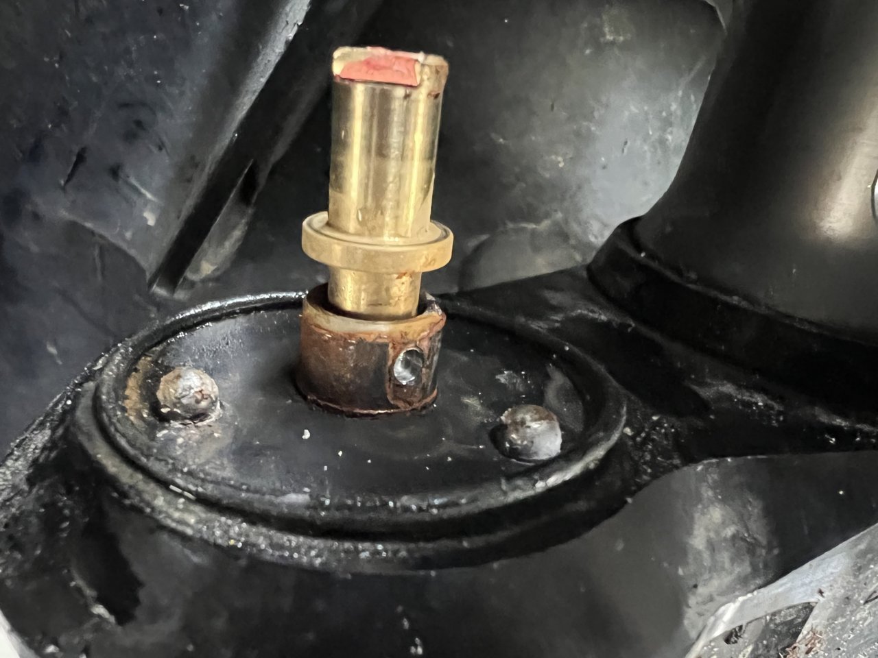

    Edited 3/29/22. Here’s what I think is the issue. A chemical is causing galvanic corrosion and the residue is depositing on the ball bearings. Or perhaps residual cleaner present at time of assembly is causing the corrosion. Either way, the corroded ball bearings make the HSC adjuster difficult to turn. Corrosion between the HSC adjustment shaft and LSC adjustment shaft is making the LSC adjuster difficult to turn. The solution is to open the adjusters, clean the parts, lubricate with Slick Honey , and reassemble. Be careful with the adjusters removed. The LSC shaft is retained by the HSC adjuster. If you thread it out too far, it will come out with 200 pounds of force if you haven’t relieved the nitrogen pressure.

    My experience is that it will work for a while. But once corrosion starts, there’s no stopping it. By forcing the movement with the range helper, the stuck balls are casually causing grooves in the bottom of the adjuster. Eventually, it won’t move.

    Edited 3/29/22. I can’t guide you on that unfortunately, but it couldn’t be worse than no grease. The balls and detents are only there to add the “click.” So it’s not overly critical as long as it lasts and doesn’t gum up, or cause corrosion. Anything with a pH other than neutral could contribute to corrosion.
    I asked Fox and they confirmed they use slick honey. Here’s a photo of the front shock I just got. They use what appears to be Slick Honey. We use that on mountain bike shocks and forks, and it’s available online. I’m not confident it’s a long lasting weather resistant grease. It doesn’t last long on mountain bikes.

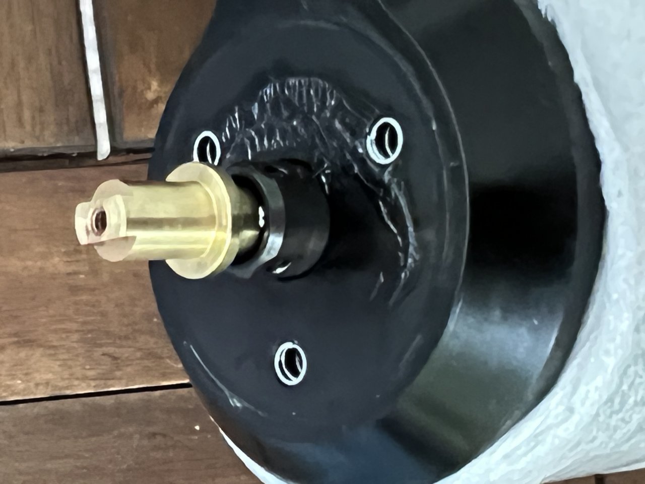

    I’m not sure that I understand your question, but I’ll try to answer. The low speed adjuster is a brass shaft. The high speed adjuster is a hollow shaft around the low speed shaft. The high speed knob has three threaded holes for the set screws, and the high speed shaft has a place for the high speed adjuster set screws to clamp onto.
    Because I accidentally unthreaded my low speed shaft with the high speed knob off, I learned the hard way why it’s important to relieve nitrogen pressure before doing this work. The brass shaft shaped like a bullet shot out with 200 pounds of hydraulic force, and so did most of the oil, covering the underside and side of my Jeep. the high speed knob prevents the low speed shaft from being unthreaded too far.
    luckily, Fox repaired it. I think they are also curious to know what’s causing this. They said they haven’t seen others corroded like mine. So if anyone sees corrosion like I saw, be sure to send photos. But!!! And I stress. Do not unthread the low speed shaft when the high speed knob is off. It could kill you.
