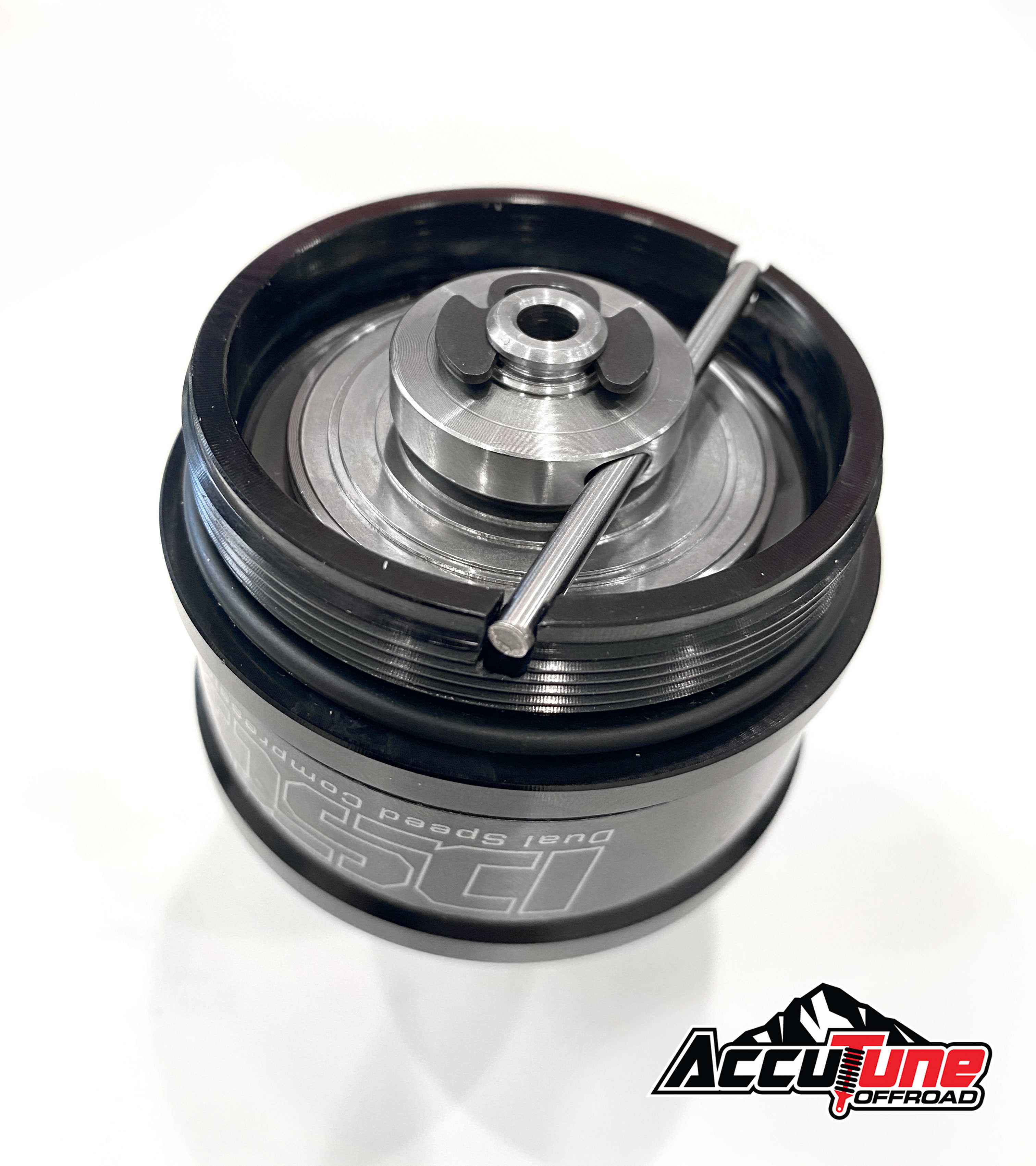

    If that high speed knob is spinning freely, definitely something going on inside. The c-clip and cross bar are holding that all together, so could be a few things wrong. Only way to find out, is to open it up. **not recommended unless you have experience and the correct tools to do so**

    My biggest concern is separating the DSC assembly from the IFP body. During my rebuild the wiper seal end cap was a nightmare to take off. The galvanic corrosion practically welded that shit together. What do you recommend as a non destructive wrench to spin the IFP body and DSC apart?

    This can be tough to do, we clamp the reservoir in a vice using aluminum body clamps, use a strap wrench to open it up.
