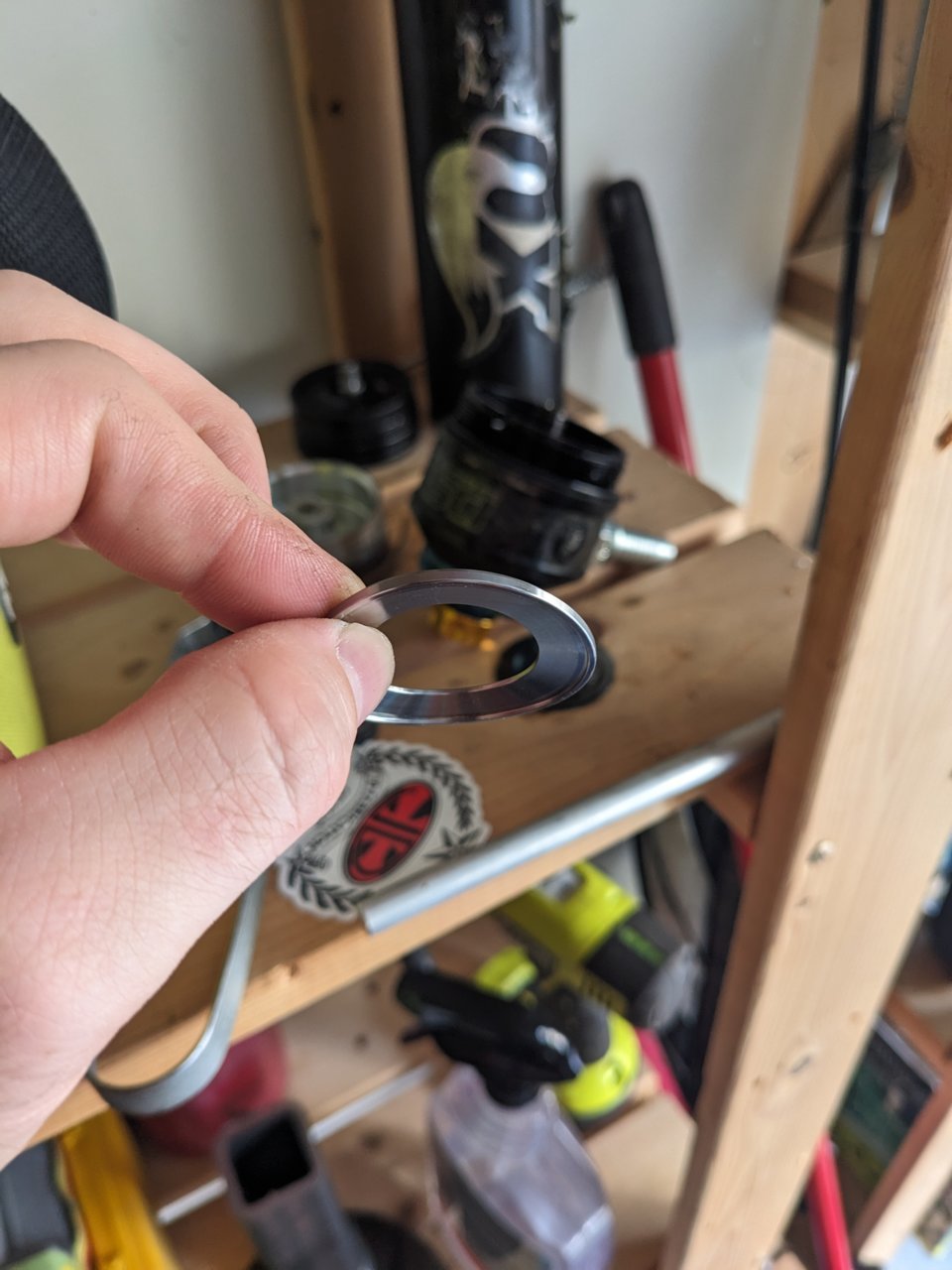

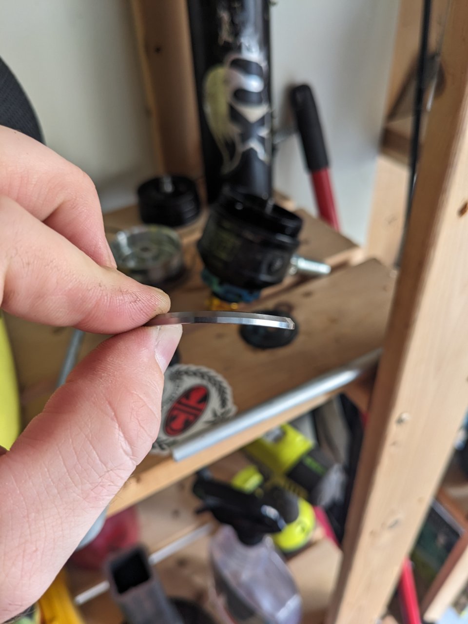

    Soo.. I found this inside the second resi.. PXL_20230713_011400754.jpg PXL_20230713_011402517.jpg

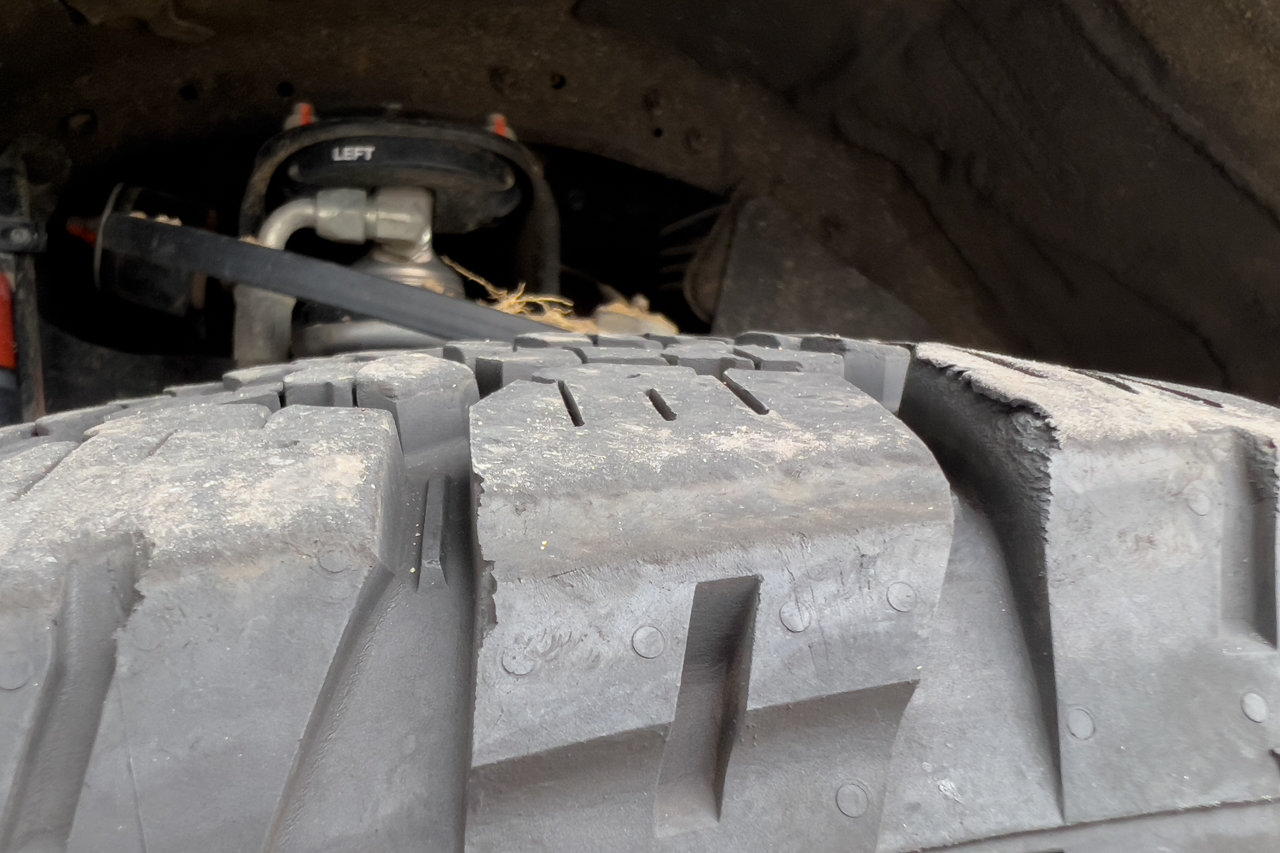

    I don't want to blame my DSC yet as a culprit for problems, however when I installed a full set of PES shocks last year my front driver was always a little suspect. I have left the adjuster alone for a good long time thinking if I don't mess with it things would stay status quo. Now I have a tire that is cupped like crazy in the same location as my suspect DSC, and the shocks are beyond the initial warranty so now it's on me. 25k on tires with regular rotations and the other 3 look fine. Hooray.
    Moral of the story is if you are having issues probably a good idea to get it taken care of ASAP. Now I get to learn how to rebuild mine after only 14k on shocks and mild offroading and see what fun things I find during teardown.
    Edit: Or maybe not, couple people now mentioned the SPC BJ might be to blame. Will have to take a closer look.

    You are always welcome to send the shocks into us for rebuild. We can go through everything to make sure they are 100% in working order.
    @wi_taco "I don't want to blame my DSC yet as a culprit for problems" I agree. Tire cupping can be caused from a few things you may want to check out first before servicing that shock. Looks like you may have SPC arms, which have been known to wear out the ball joint prematurely. Inspecting those & alignment would be a starting point if it were me. If the shock was causing the cupping, I would except there to be leaking oil or no nitrogen charge and both of those would be very noticeable. I believe you bought those shocks from us, so you are eligible for 25% off labor for a rebuild if thats a route you would like to take. Let us know if we can help!

    Thanks, someone else mentioned the SPC ball joints being a culprit which I hadn't quite given enough consideration. I didn't find any play last time I checked but I'll have to go test/measure them more closely.
