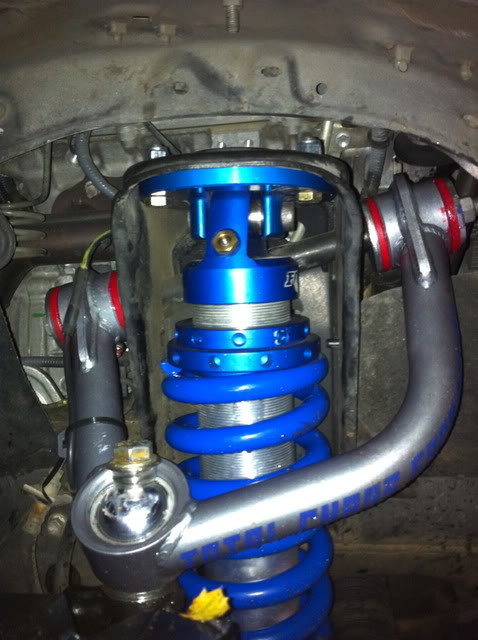

    Is this installed right?
    I cant seem to fit it through the coil bucket to bolt it in.
    If it is installed right any tips to get it in

    Upside down

    yup...should be the other way

    they look upside down to me, but i dont own a pair of these so i may be wrong

    Flip them around and your good. That top spacer should be flat up top so it can fit in.

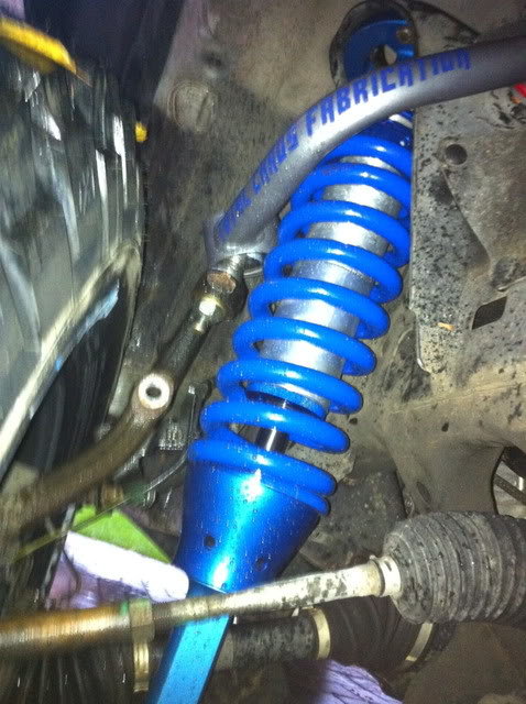

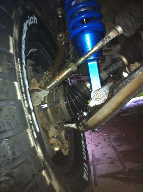

    ok so I reinstalled it and got everything back together, but the weird thing is Im sitting at 5 inches of lift:eek: and spring coming contact with the UCA
    Should I take out the factory preload on the shock or is there something im missing completely. This is the correct shock for the truck right?

    Dial some of that preload out of the CO.

    daaamn those seem like too long maybe!?! Yeah definitely take out some preload from the spring and see if you can get it down. Looks like its sitting at full droop in those pics! :eek:

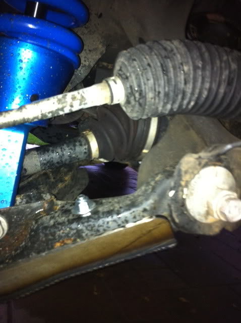

    i've seen coilovers cranked down a lot more that dont sit like that. did you measure that right after you took it off the jack? if so, it will sit a little high untile it settles, but i dont think it would sit THAT high. your cv's look like there sittin at a bad angle also.

    Something is DEFINITELY not right. Those CV angles are fucked.
    Start by double-checking the model # and make sure you have the right CO for your vehicle.

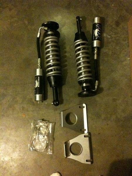

    I bought them from this guy
    http://cgi.ebay.com/ebaymotors/ws/e...0642885624&ssPageName=ADME:X:eRTM:MOTORS:1123
    I met him in person he is 10 minutes away from my house.
    the part numbers on the ebay say 980-99-362-A/ 980-99-361-A
    I have no idea how to get the top collar loose, its so tight the spanner wrench i ordered is the wrong size and Ive broken 2 drill bits.

    Can you measure how much shaft is showing with the shock drooped out? If it measures 8" they are LT coilovers. Also I had fox coilovers once and they had a different top hat than those, but maybe it's different now. Do the springs have any numbers on them? Weird deal for sure.

    can I measure when they are off the truck cause i just took them off?
    oh and I called the guy he assured me that they are the right application straight out of the box, so like this
    Im going to meet up with him tomorrow to figure it out, but i dont see how I could fit that in without grinding out the coilbucket a little bit
