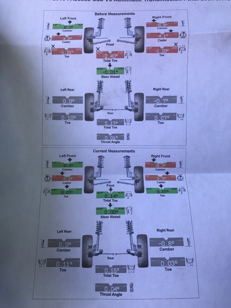

    No rubbing the resi at all. I have 4.0" back spacing (-12mm offset) on my wheels though.
    That being said, I am getting rub on the rear of my fender well, where the mud flaps would be. That wasn't there before. So I'll be looking at my caster and camber to see what's up. Here's my alignment numbers FWIW...IMG_0588.jpg

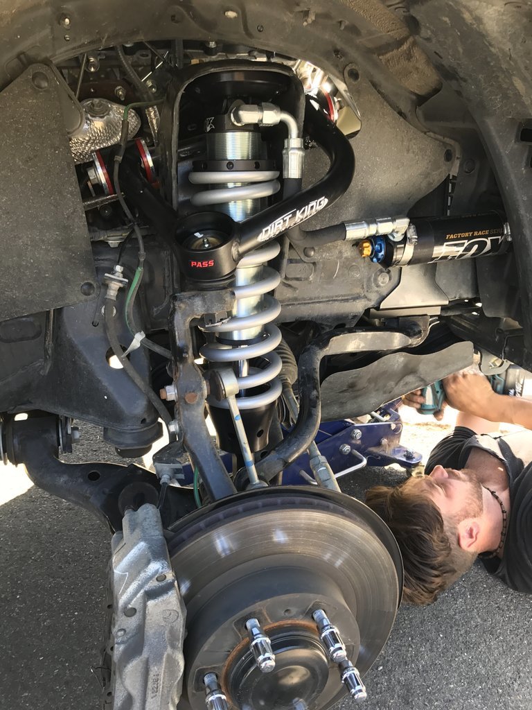

    And from the thread in third gen section I made concluded the shop mounted the reservoirs upside down. So my 90 on the resi is not at 6 oclock and is more like 5 oclock, and regardless of which its supposed to be at 12. So going to be going back on tuesday to have them correct that.
    I figure I could do it but that's their mess up. Let them fix it.

    figured it out though its from the way the reservoir was installed. so going to have the shop that did the install correct it.
