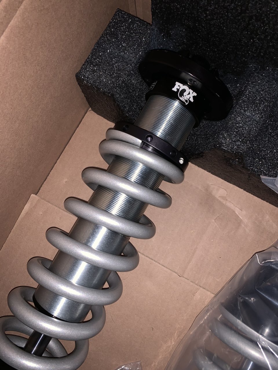

    Some of my Black Friday loot from Wheelers Off-road came in. Just 3 more boxes to go.
