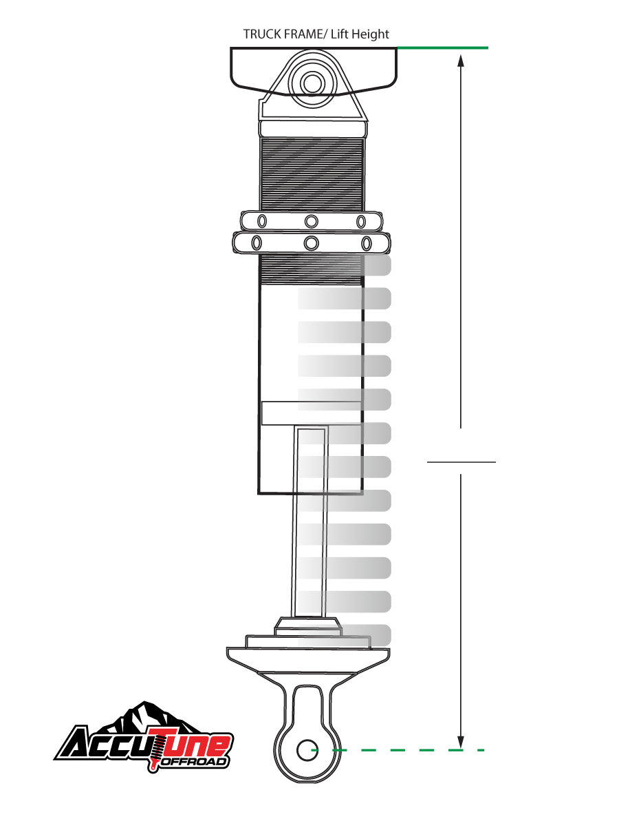

    Sounds like the general consensus for 2.5 EXT ride height should be 21" or less from the center of the lower eyelet to the top of the tophat.
    2 questions:
    Is that correct?
    What's the minimum dimension that should be?
    I just installed some newer, heavier springs (700#) and would like to make sure I've got both enough down and up travel.
  3. Dec 12, 2019 at 1:00 PM
    #2023
    AccuTune Offroad
    AccuTune Offroad Well-Known Member Vendor
    Jan 28, 2019
    #281012
    1,657
    El Cajon, CA
    Correct. We install a lot of these and based on the shock travel, that is the max height we like to see them at, without causing issues.
    Not really a minimum height. You will be limited on how low you can go
    • Product Extended Length: 22.480
    • Product Collapsed Length: 17.590
    • Product Travel: 4.890

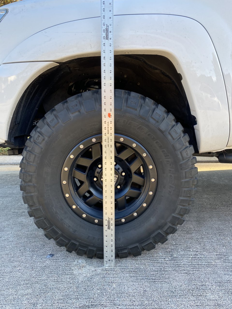

    Ok I’m fed up with searching for the correct way to measure the lift I’m getting out of my fox 2.5 dsc coilovers. Can someone help me please?
    Do you measure the threads? Or count the threads? Or measure from center of hub to bottom of fender?
    I really don’t wanna skim through pages and pages of threads.
  5. Dec 22, 2019 at 8:17 PM

    Also do not exceed 21" from lower shock eyelet to the top of the top hat.

    21” while installed in truck..?
  8. Dec 23, 2019 at 9:04 AM
    #2028
    AccuTune Offroad
    Jan 28, 2019
    #281012
    1,657
    El Cajon, CA
    Correct. That is the max length we recommend at ride height.

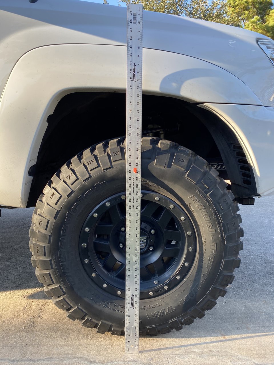

  9. Dec 23, 2019 at 3:01 PM
    #2029
    cdex8357
    cdex8357 “Everybody gotta die sometime”
    Apr 7, 2018
    #249677
    1,004
    “Dex”
    H-Town
    2013 Taco OR
    Mid travel FOX 2.5 Coilovers FOX 2.5 secondary bypass FOX 12” Triple Bypass
    Hard to find a some what level service around here and it’s flat all over..
    Does this look right..trying get 2 -2.5 in of lift.
    I’m gonna try again on a flatter surface. As of now.
    32” tire. Center should be 16” subtract that from 37” (both are 37” how the measuring stick is laying looks different). 37-16= 21
    im also 1.25” of threads.. measured from bottom of collar to top of threads.
    counted roughly 19 or 20 threads.
    21 inches from bottom to top hat of coilover.
    My truck is nose down. Want to level it as much as possible.
  10. Dec 23, 2019 at 4:37 PM
    #2030
    AccuTune Offroad
    Jan 28, 2019
    #281012
    1,657
    El Cajon, CA
    If you're at 21" from the top of the top hat to center of lower shock bolt, you're about as tall as you can go. If you increase preload to add lift, you will top out the shock very quickly resulting in a harsh ride. You may need to consider a different rear spring option. What rear leaf/lift are you running?

  14. Dec 24, 2019 at 11:58 AM
    #2034
    cdex8357
    Apr 7, 2018
    #249677
    1,004
    “Dex”
    H-Town
    2013 Taco OR
    thanks man..
    I got my height fixed.. problem was all measurements I was not on a level surface.
    21” from center of ring to top of coilover as described by @AccuTune Offroad.. check this like 10 times with my ocd
    38” from bottom of tire to top of fender.
    About 28 3/4 from center of hub to fender.
    thanks for the help @RangerComa and @AccuTune Offroad
