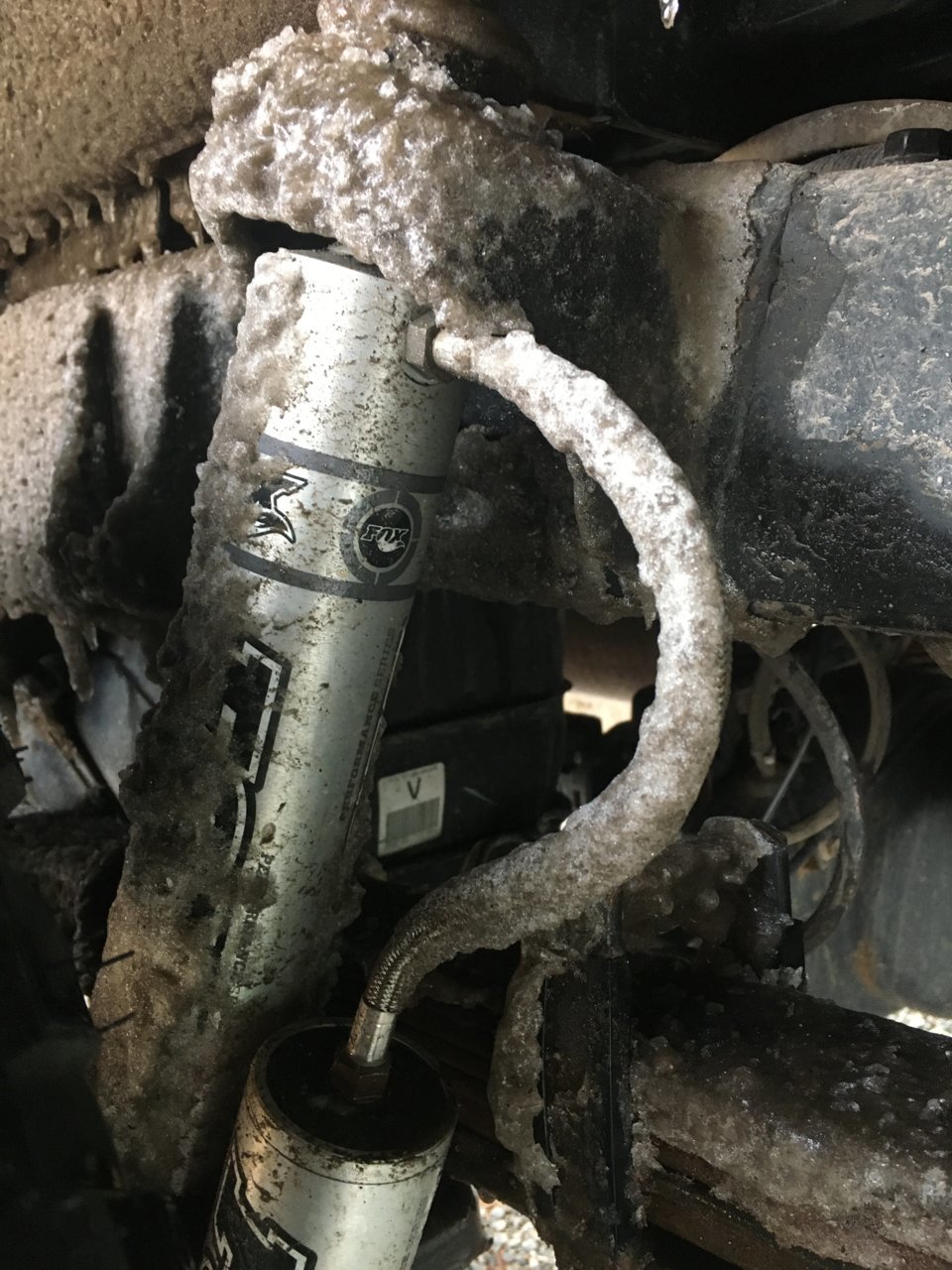

    '12 DCSB TRD-OR
    Fox/Dakar with Relentless goodies and stuff
    Filthy Fox
