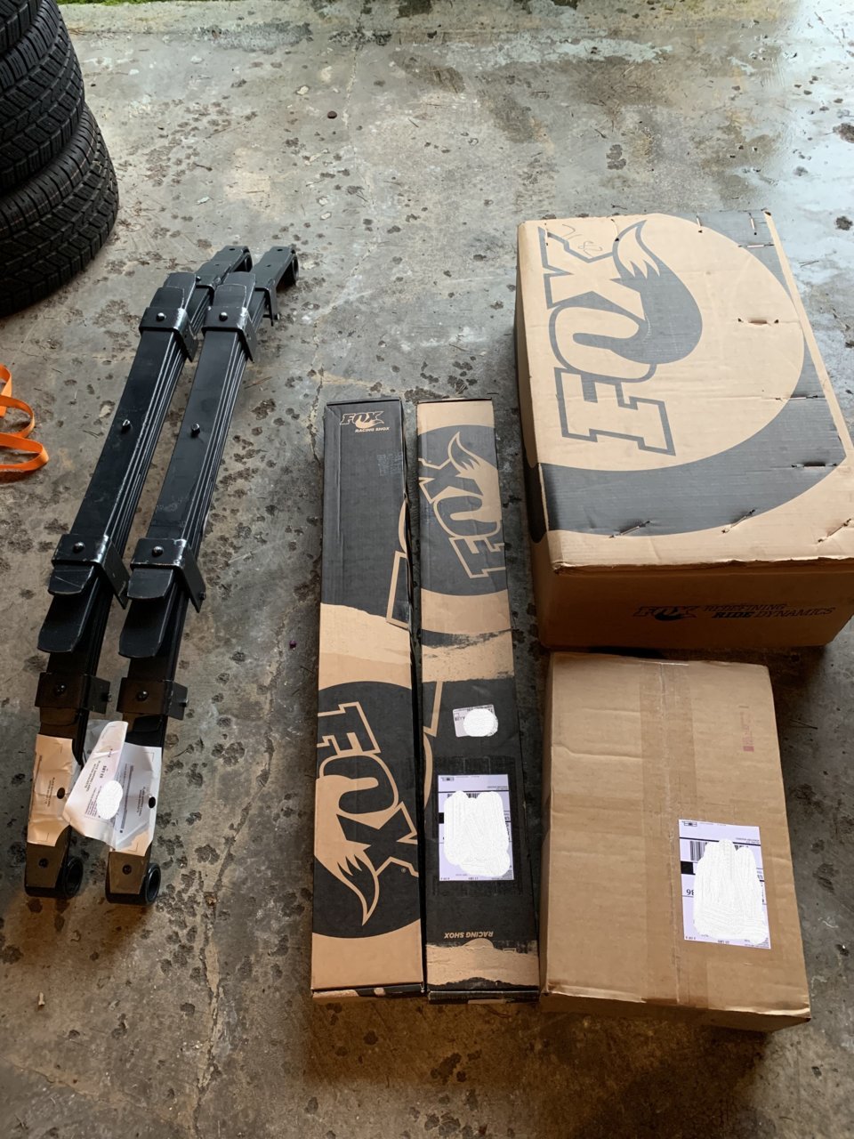

    Very excited to join the club. Just came in the mail:
    --Fox 2.5 extended travel coilovers w/ reservoir and adjusters
    --Fox 2.0 rear shocks w/ reservoir and adjusters
    --SPC UCAs
    --Medium duty Dakar leaf pack
    Jpiskura and TVH475 like this.
