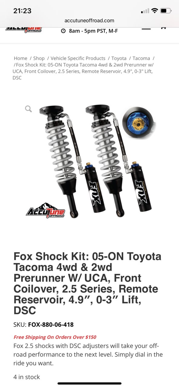

    I’m looking at getting these Fox 2.5 Coilovers on my 2019 SR5 with the 600# springs. I want about 2” of lift or maybe slightly more. Does anybody have these on their 3rd gen? I’m trying to find out what preload you have yours set at to get the same lift I’m looking for. Thanks guys!

    That’s who I’m ordering through. They can’t say exactly where to set it at. I’m looking for answers from somebody who actually installed this setup on their 3rd gen.

    We’re gonna need a lot more info then. There’s a lot of variables. Start reading through this thread. There’s a lot of info already posted with what you’re asking. Short story is that every truck is different, some vastly so. For instance, my buddies stock 4x4 off road has 14” 650lbs coils pretty much maxed out and he’s at 2”. I’m also on 14” 650lb coils but I have bumper and winch in the front and I’m at 2” and only showing 5 threads. Some have 700lb coils. Others are fine on 13” coils, and yet others are running 14” 600lb coils.
    Are you stock? Plan to add weight? Running without sway bar?
    in general, I think it’s safe to say that you need 14” 600lb coils for a stock third gen. The 13” coils are crap. 650’s if you have moderate weight and 700’s if you’re a pig.
    threads showing is going to vary widely however.

    You’re doing it right, with stock weight 14” 600#’s are gonna ride great. To clear up any confusion on preload though... It doesn’t matter where the spring preload collar ends up on the threads of the shock shaft. You’re not changing the length of the coil when you turn the collar to expose more threads. The only thing that’ll compress the coil is the weight of the truck - or more accurately, any down force exerted on the coil - that is why you want to pick the proper weight coil for your truck.
    when you are spinning the preload collar to set ride height, you are actually setting up the proper sag, which is making sure the shock shaft is in the middle of the stroke length. For the DSC’s the stroke length is about 4.9 inches. So you want about 2.5” of up travel and 2.5” of down travel. That way you don’t top out over light bumps and don’t bottom out over small g outs.
    getting your sag set properly will be the major factor in greeting a good ride.
    Ballpark for you: exposed threads for 2.25” lift on your set up is gonna be about 12 threads driver side, 9 threads passenger side. If you’re going for a specific lift height, you will have to play with the collar after a few hundred miles due to settling of the coil. I highly recommend you invest in a couple of 5/16” punches and the Specialty Products spring compressor listed at the bottom of the page. You will never get it right the first time.
    Hope this helps, these shocks are super nice and offer a great ride when used properly.

    Is this 12 and 9 threads estimate for a 14” spring? I understand that preload doesn’t affect the ride but can affect shock travel. That’s why I was asking about the best spring size for a 2 1/4” left. I’ve heard of others changing from 13” to 14” spring on a third gen.
    Thanks again for the awesome reply.

    Just to be clear, a Fox coilover with DSC does not necessarily mean it has 4.9" travel. Just needs to be an extended length coilover (0-3" like shown above is an extended lenth shock). 50/50 split on travel can work for some, but not a universal rule. Max shock length we recommend is about 21" from top hat to lower bolt, which leaves about 1.48" of shock droop. With the motion ratio, this provides plenty of wheel travel for someone wanting a max height. I imagine getting a 2" lift, the shock length would be somewhere around 20-20.5". This of course would need to be measured once the weight of the vehicle is on the coilovers.
    @TacoTime850 are you trying to fit a certain size tire on the truck? Or looking to get the most lift height with that coilover? If you're looking for max height, I would shoot for that 21" from the top of the top hat, to lower shock bolt.

    Spring length wont affect the lift height for these OEM fit coilovers. You will need the same amount of preload on either a 13" or 14" spring, you will just have less threads showing on a 14" spring. Preload often times gets confused with the amount of threads showing on the coilover, which is not accurate. The Fox 2.5 coilovers come with 13x600, so a 14x600 would be an upgraded cost.
