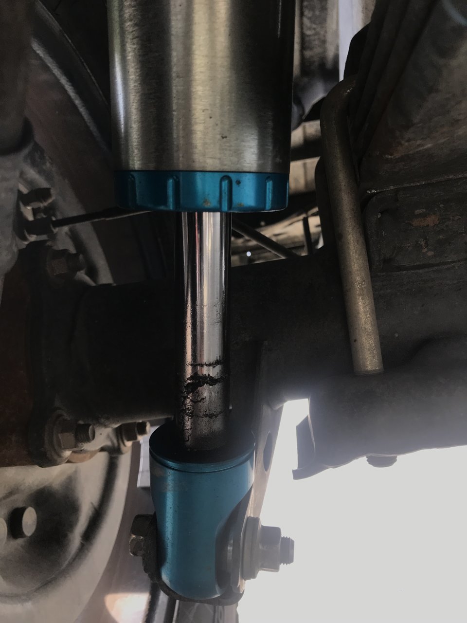

    So, I jumped on the hype bus and got a set of king 2.5’s with adjustable resis. Only to have them leak both oil and nitrogen. Twice! They’re currently at king hq getting looked at . Down a truck for however many days they decide to look at my suspension. To be fair. I turned them in the week after “King of the Hammers”. So I understand where the priority lies. But as I stare at my truck I can’t help but wonder if I should have gone Fox the way I went with my mountain bike

    From what I’ve read and suspension shops I’ve talked to, King shocks are not up to par with Fox, ADS, and Elka

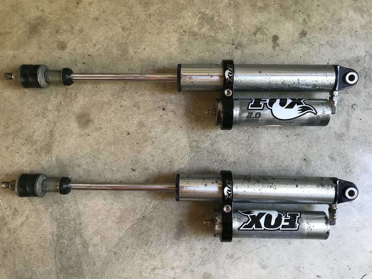

    Anyone by chance have the part number of either of these guys? Can’t seem to get a straight answer, and just trying to figure out with rebuild kit to buy and the stamped # on the bottom doesn’t correlate to any current number. Rears are 2.0 piggybacks I believe and fronts are 2.5 RR with IBP, worth rebuilding?
    AccuTune Offroad likes this.

    You can't get an answer because the fronts are a Fox Military shock. Buy a 2.5" IBP rebuild kit.

    We can get you the rebuild kits needed for both. Shoot us an email with those pics and we can get you an estimate. Definitely worth rebuilding vs replacing. They don't look too beat up, so shafts are probably fine. Sales@accutuneoffroad.com
    Jpiskura, su.b.rat and commonsense87 like this.

    Email coming your way, appreciate the help!
