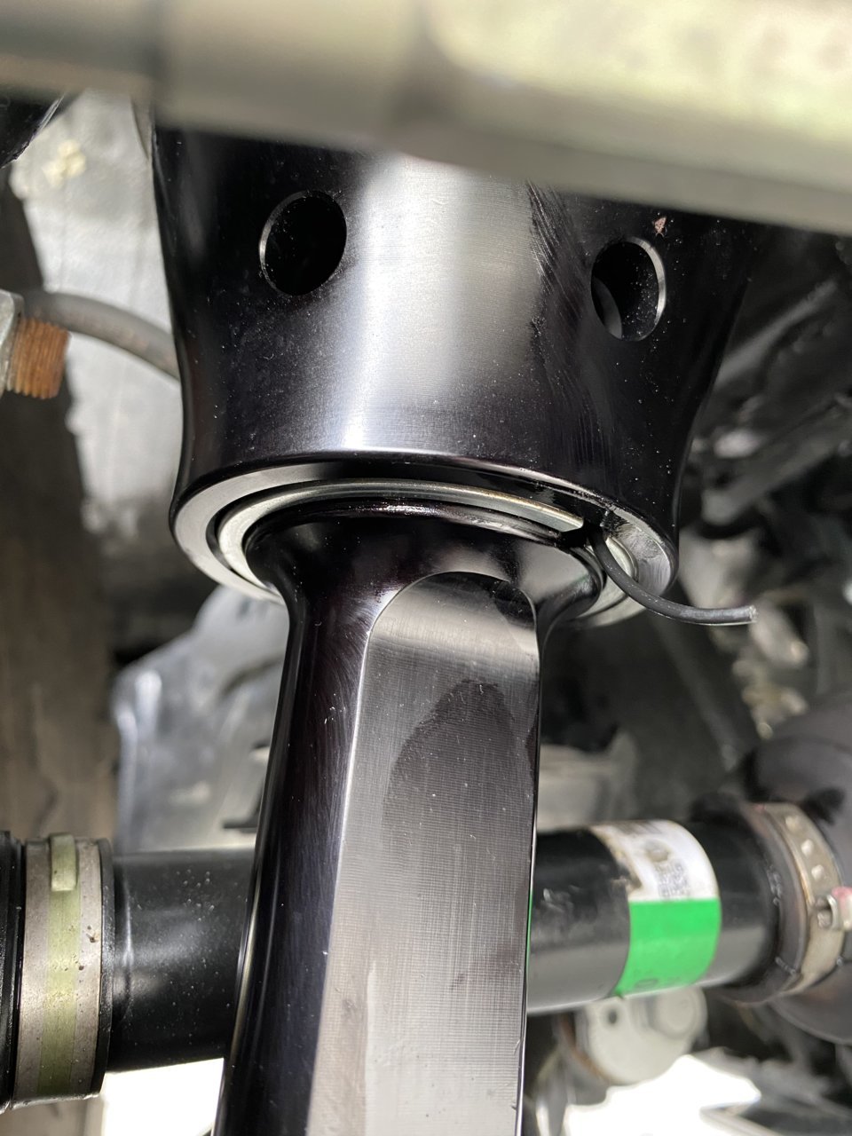

    What in the holy hell!! It’s always something isn’t it?!?! Can someone please tell me how and why this would’ve happened? Im about to pull the rest of my hair out over this suspension...there’s no reason this o-ring should be hanging out. 782FE7C2-FE64-49AE-BBD9-F268A63B4DEB.jpg

    That o-ring is only there to keep the "c-clips" together during assembly. Once the spring retainer is in place it serves very little to no purpose. That o-ring is also very prone to dry rotting after time and a lot of guys remove it during servicing.
    It likely got pinched during assembly. Did you just purchase those or get them valved?

    I purchased them and they have about 6,000 miles on them with little off-road time due to being away at a military school. So that o-ring doesn’t serve a huge purpose that would affect anything internal with the valving or future performance? Nothing premature I should worry about or is there a way I can get that o-ring replaced without actually having to rip out the entire coil-over?

    No, that o-ring has nothing to do with the internals of the shock and/or its function. It’s just a nice feature for the assembly process as far as my knowledge goes.
    The spring retaining clips appear to be in the proper position in the picture so I personally wouldn’t the worry about it. You’d have to remove the shocks and remove the springs to replace it.

    If it makes you feel any better, mine did the same thing.

    Cmbondo, did you experience any underlying or issues in the future after discovering it? Just want a little reassurance that it’s something I don’t have to address.

    No issues. As someone said above, to the best of my knowledge it is just there to hold the retaining clips in place during assembly. It has nothing to do with the internals. Mine has been like that for quite a while.

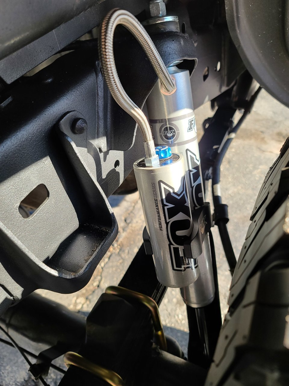

    Finally finished my Fox lift kit and am super happy with the outcome. I did Fox 2.5 remote resi with dsc adjuster up front with the Fox 2.0 remote resi with adjuster in the rear. After some fine tuning and adjusting came out to 3 in lift I was looking for. Added the spc uca and some FN FX Pro wheels with some BFG Bro 2's 285-70-R17 and could not be happier. Only thing I ran into was having to do a skid plate bracket drop kit bc my sway bar was very close to the brackets for the skid and would hit over bumps. Me and a buddy made up some 1/2in spacers and I powder coated them to keep it clean. Came out looking beautiful in my opinion. Love this setup and could not have done it without the help of you awesome people of Tacoma world :fistbump:20200327_174906.jpg 20200327_175321.jpg 20200327_175137.jpg

    hard to tell by your pics, but you may need to change the position of your rear reservoir so it doesn’t contact the axle at full compression.

    Thanks for looking out Matt. I have done plenty of measuring to make sure it is all good. With the 3 leaf aal and the resi where it is the axle is no worry,the bump stop hits and still leaves almost a full inch of compression on the shock seeing as its the extended travel shock .Also I can't rotate it do to having a roost guard to protect the shock shaft. I did put both roost guards on just because I got the set and I like to keep things clean and even :fistbump:
