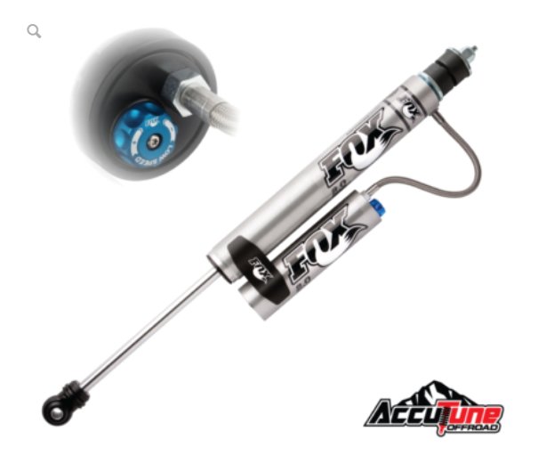

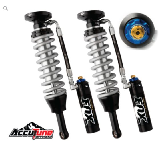

    So I'm looking at getting Fox 2.5 w/ remote reservoir DSC 0-3" lift in the front and Fox 2.0 w/ adjustable remote reservoir in the rear. I have a 2019 TRD Offroad and what I have heard is that the offroads come 1'' lifted already. So really I will only be getting a 2" lift in the front. Is that correct? If that is the case do I only want to lift my rear 1-1.5" to maintain a more level look? I'm trying to decide what to do for an AAL for the rear. I just don't want to go too high. TIA
    AccuTune Offroad likes this.

    Hey nice photos!
    The TRD Pro come with a 1" lift. You could do our Stage 2A kit, using the shocks pictured above with an add a leaf in the rear. If you want the 0-3" front coilovers, you will need an upper control arm.
  14. Apr 16, 2020 at 8:40 AM

    So what you are saying is the offroad doesn't have the 1'' lift? So I should get 2.5-3 inches of lift from this kit? With the aal will I be getting 1.5-2 inches if lift in the rear? And from my research I knew I was going to need an UCA. But thanks for the heads up.
  15. Apr 16, 2020 at 8:51 AM
    #2335
    AccuTune Offroad
    AccuTune Offroad Well-Known Member Vendor
    Jan 28, 2019
    #281012
    1,657
    El Cajon, CA
    Correct, quick google search got me here
    Front you should expect 2.5" lift and rear about 1.5" lift. We do not like to max out the front to a full 3" because it will start to hurt ride quality.
    If you have a preference on control arms, we have several others we can swap in also :thumbsup:
