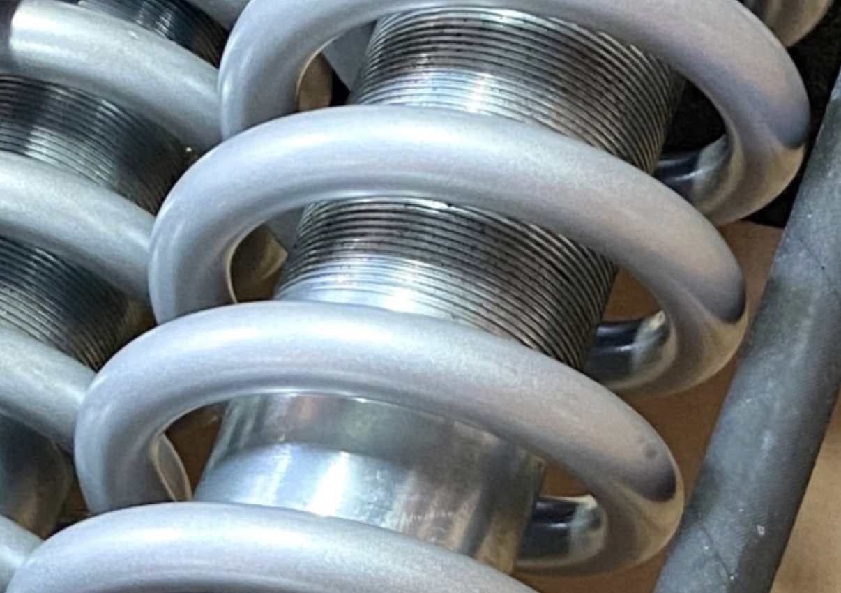

    Shop told me they would need to take the top off the shock to replace the preload nut. Does it thread off the bottom? or does one need to use spanner?
  2. Apr 24, 2020 at 2:15 PM
    #2362
    AccuTune Offroad
    AccuTune Offroad Well-Known Member Vendor
    Jan 28, 2019
    #281012
    1,657
    El Cajon, CA
    Nope.
    Preload nut will have to come off the top of the shock, which will require the top cap to be removed. The threads on the shock body end , so you will not be able to screw it off the other way. See below

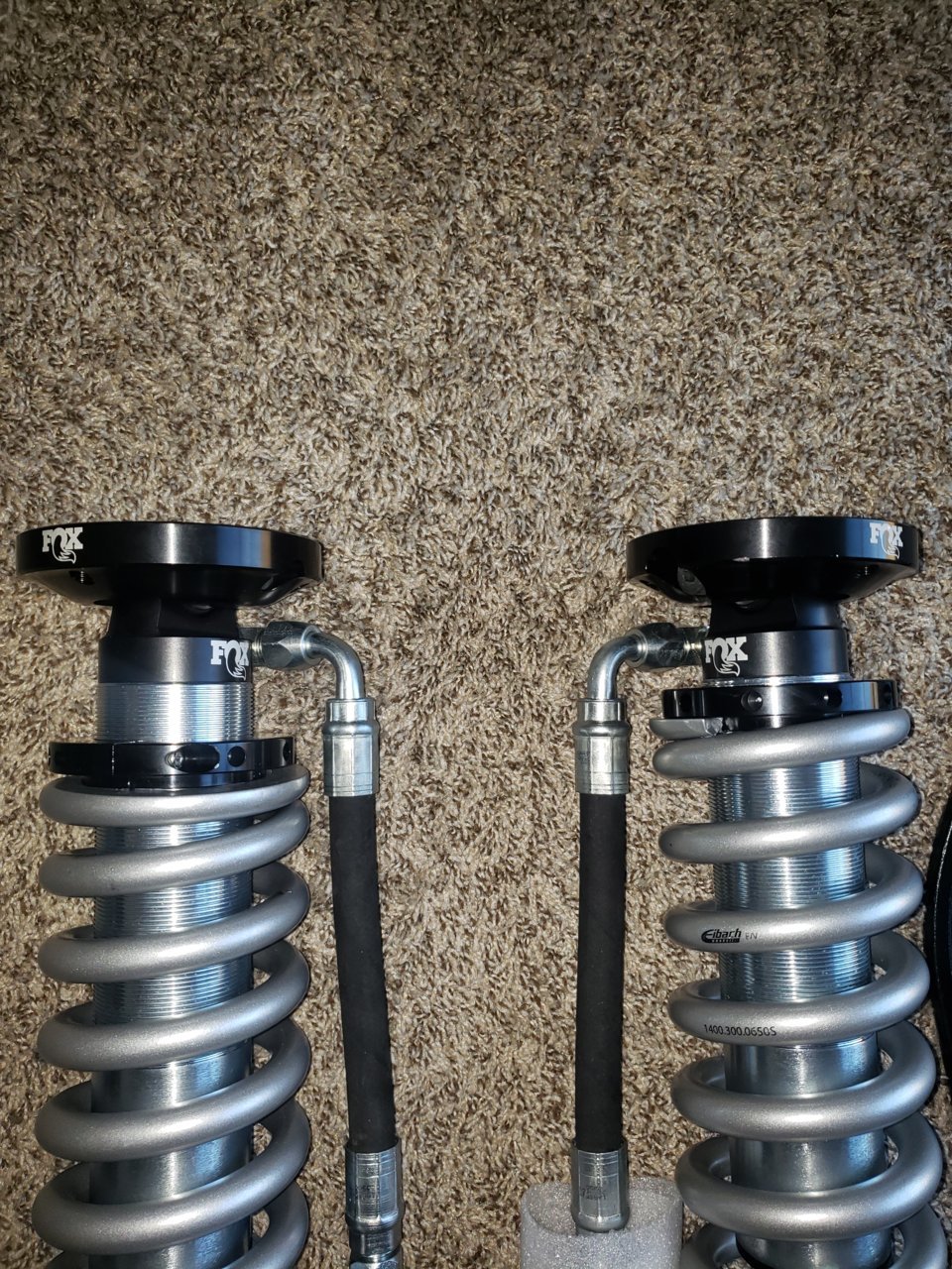

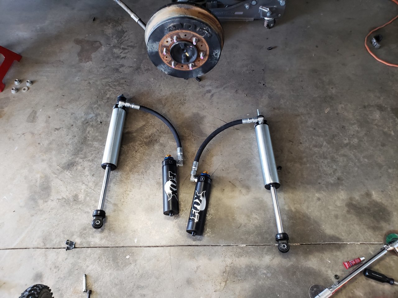

    I purchased from bilsteinlifts.com and I have to say, they have awesome customer service. Fox jacked up one of my rear 2.5s during assembly. The resi was going the wrong direction and bilsteinlifts overnighted me a new one.

    @Devinm how do you mean "jacked up a resi". Just curious? The resi can be rotated slightly to remedy some small complaints people have had like decal not facing out ward or the resi facing towards the front and needed towards the rear. Do you have any pics of the issue to maybe help someone better understand. On the adjustment question its basically all driver opinion on that and there probably isn't a magic adjustment for on and off road,hence why they are adjustable so you can quickly change from highway driving to rough off road with just a few clicks. It would be hard to answer that question so if you feel its to hard/stiff driving add a few more clicks and give it another go until your happy :thumbsup:
  10. Apr 25, 2020 at 10:37 AM
    #2370
    Devinm
    Devinm Member
    Apr 25, 2020
    #325773
    16
    Devin
    Ft Benning
    '20 OR
    The one on the left should look like the one on the right. The fitting coming out of the main body should be facing 180° the other direction.

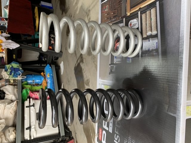

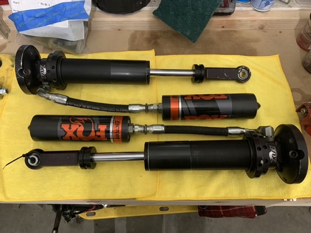

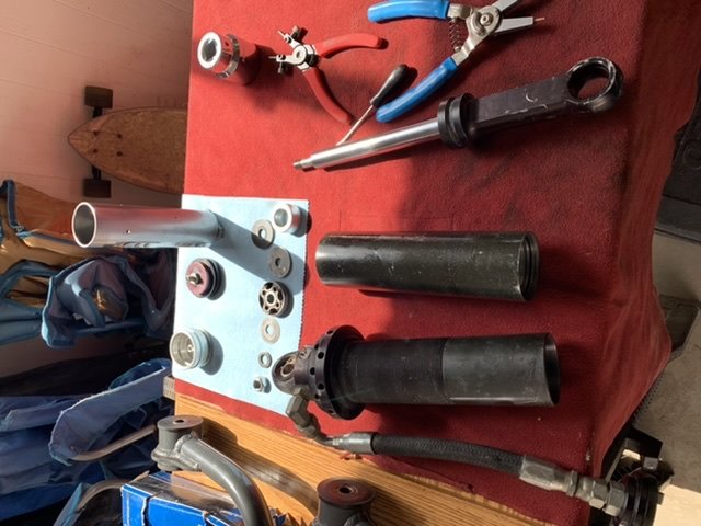

    Almost done, just need to get a spring compressor and then that’s all. Let me tell you, not a walk in the park, but totally worth it just to learn about the internals and how they’re put together. A little before and after.
    But one question, silver or black springs?
    Jowett, 1TACOTONY, TVH475 and 2 others like this.

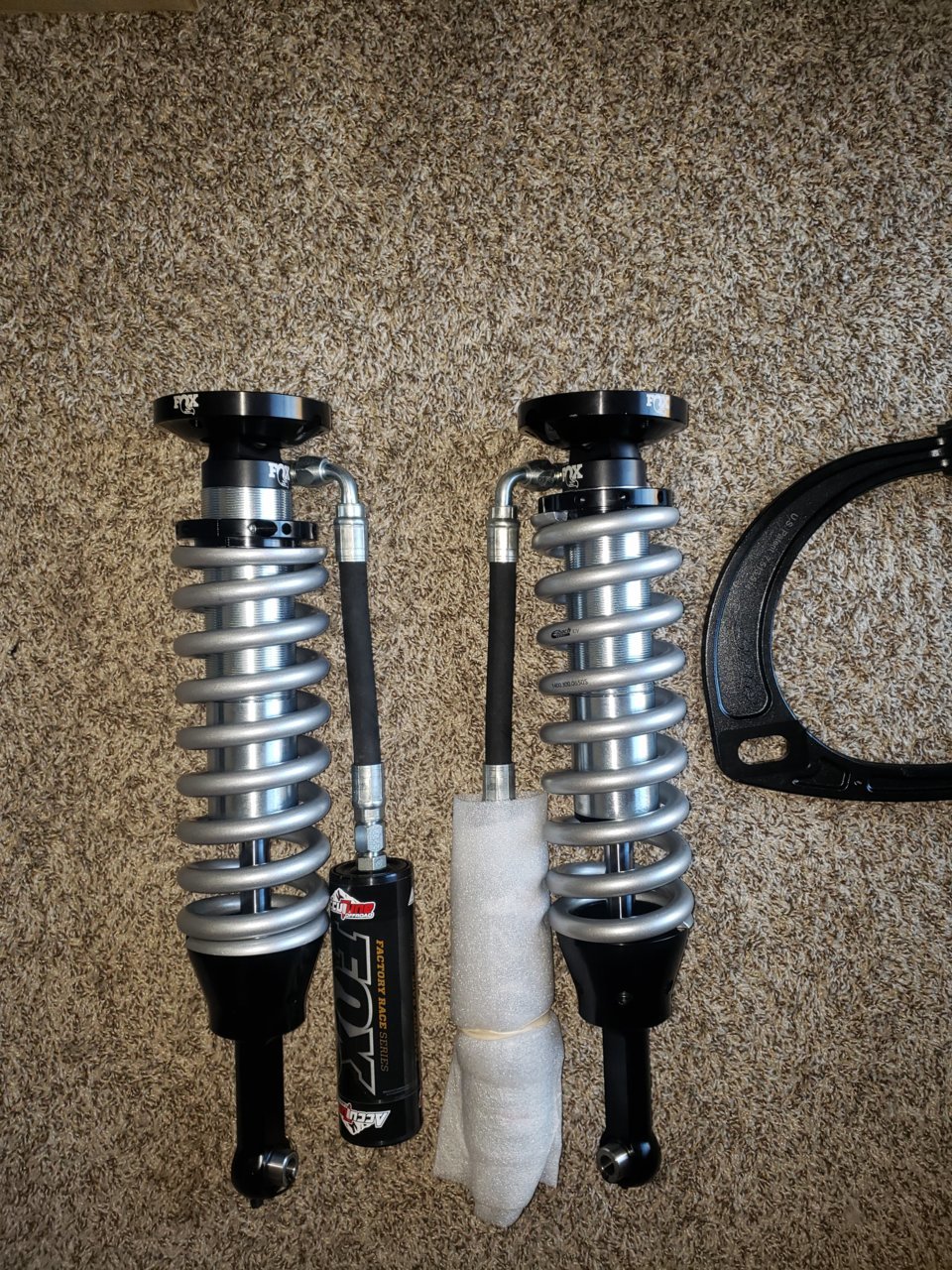

    Whats up guys? had a quick question. I just recieved my front 2.5 Fox RR coilovers from @AccuTune Offroad. Still waiting on the rear shocks with RR's. But I was wondering if I could somehow adjust the preload for a 2"- 2.5" lift before I install them on the truck? NOTE: I did have them use the eibach 650lb springs for possible added weight in the future and to possibly prevent sag.
    Id rather not have to take them off and put them back on multiple times to nail my desired ride height. I understand that my goal is to reach 21" total coilover length (tophat to bottom of shock). But Im assuming ill have to adjust them quite a bit based on how I recieved them from @AccuTune Offroad. @1TACOTONY you said about 1 3/4 on both sides? Tells me ill need to adjust this passenger down quite a bit. But may be not because of the 650lb springs??

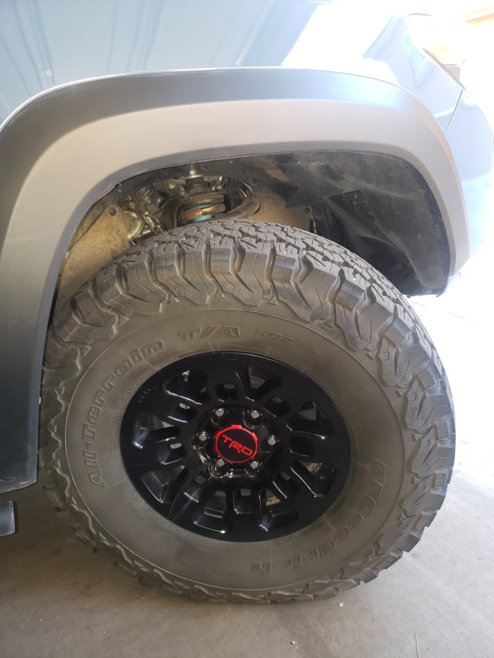

    Also, @1TACOTONY. In reference to another post. Im running BFG KO2s 285/75/r16's currently on stock ride height with minimal trimming like you did. (Air dam,etc) I used TRD Pro 4 runner rims with a -13 mm offset I believe.
