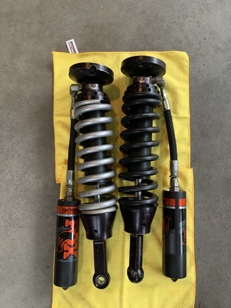

    Alright guys the the time has come to choose the coil color, need your help. Black on black on black, or keep the silver and clean them up? These are 2.5 IBP’s

    If you go with black, blackout the hose fittings as well.

    I think I'm going to stick with the silver. Painting the fittings would have me be a little concerned if I needed to change anything out in the future if I decide to keep these guys. Plus the silver with the black background looks killer I think.

    I would stick with silver but wouldn't paint, powder coat it.

    I'm going to use Steel-It, since using I've found out the corrosion resistance is just on par with powder coat but the nice thing is touch up is so much easier.

    looking at cerakote. I called fox and they suggested against powder coating and recommended cerakote because the powder coat does not dissipate heat well. looking into the elite series, i have this on a pistol and the carbon just wipes off, it also has the best chemical resistance of all the cerakoting.
    https://www.cerakote.com/project-gallery/35048/cerakoted-e-160-concrete
    with a black coil.
    https://www.cerakote.com/shop/cerakote-coating/E-100/blackout
    although the metallic look is bad ass, but they dont have that option in the E-series. got some swatches coming. i noticed your wheels were bronze, i think the body in bronze, and blacked out coil would look mean.
