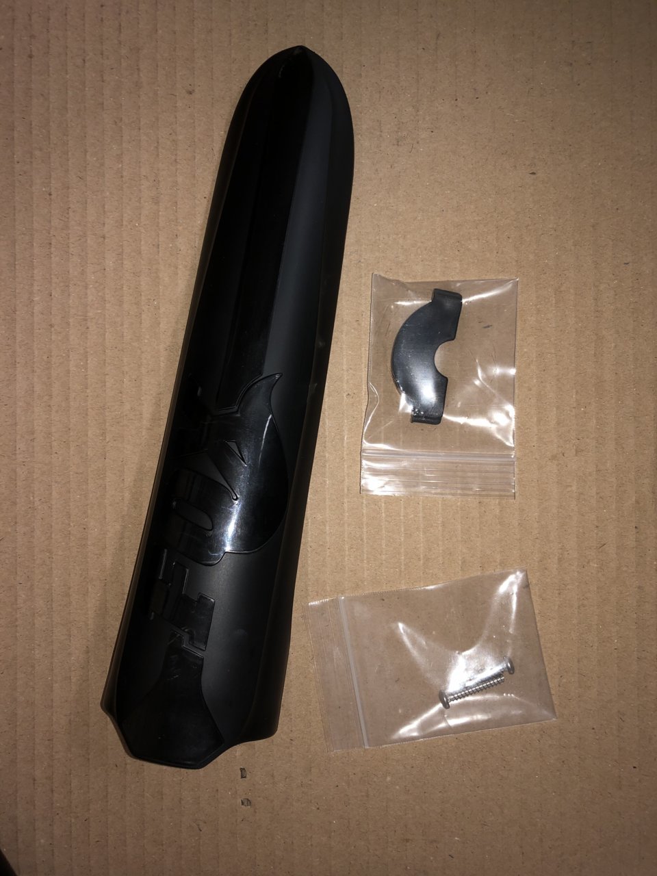

    Hey all, I have an extra shield to a fox 2.0 rear shock if anyone needs one. Save yourself from buying 2 when you only need one. AE7870D3-2524-47AD-A729-BA08E905BB8B.jpg
