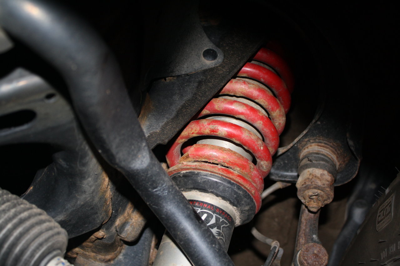

    Why would it rust this fast . .. that's a big concern, if you replace it will that one rust just as fast?

    Can you post a photo of your front coilovers as they sit now?

    There has to be more going on. Springs dont just break like that. I imagine there is some serious coil bind happening, and a few things can cause that.

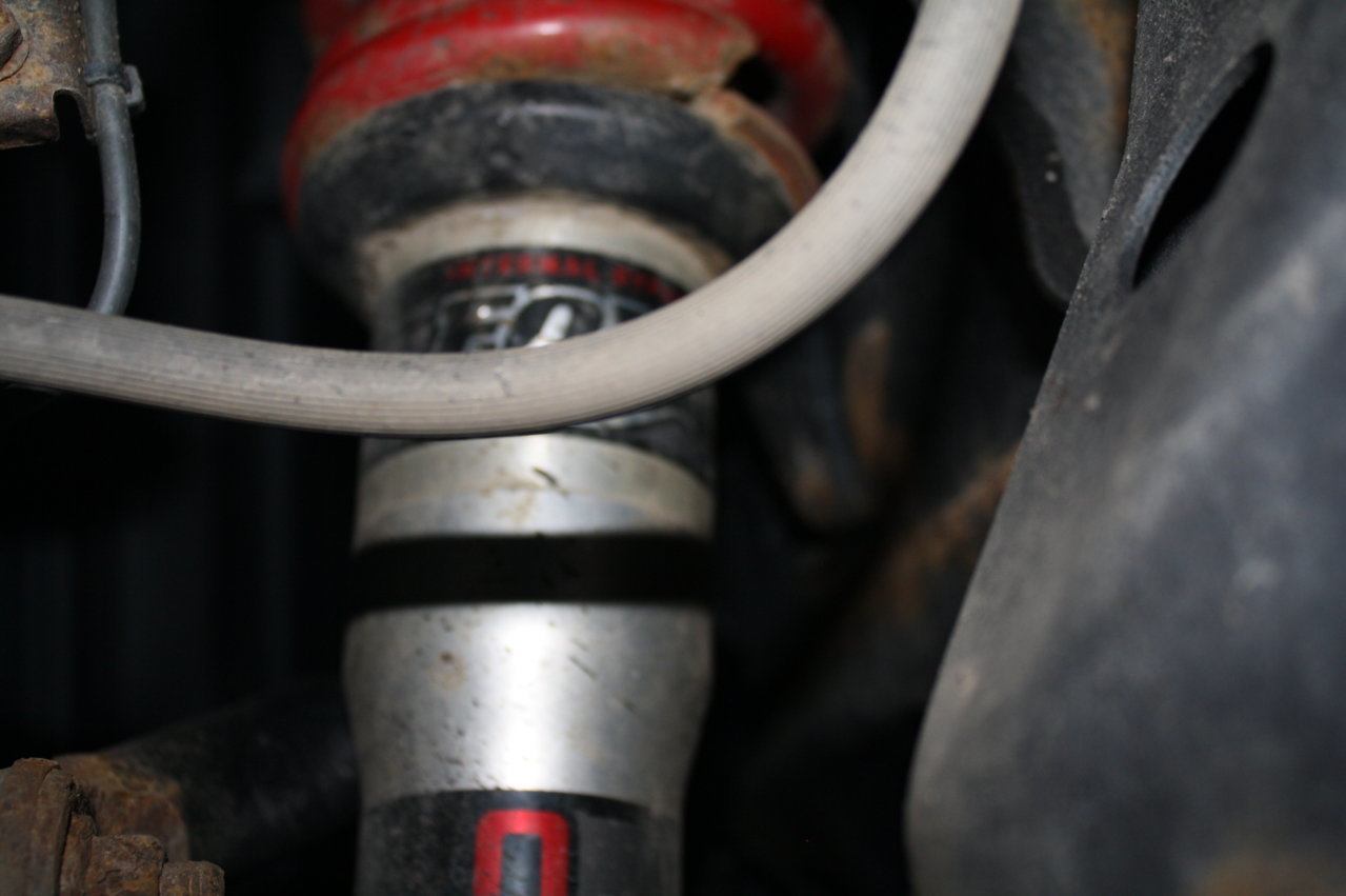

    no binding, just 3yr old OEM fox's... made me go out and take pics, after ive been drinking,, but here they are.. note 2nd pic and tell me my 3/4 spacer caused my spring to do this.. northeast pa garage kept . my 4th tacoma,,2001 whish i still had it, 2014 off road, nice, 2015 pro better, 2017 pro, still have it 3 yrs later, what does that tell ya. love this truck.. cement rocks.. .

    Damn dude. Being up north the garage doesn’t cut it. You gotta wash off the salt before you put it in the garage every now and then.
    You got some really deep rust going all over that front end.

    i do wash it all the time, especially in the winter, its a tacoma thing, other brands dont rust like that around here,,

    Sorta. The bodies of my Fox 2.5s, especially the threads, are heavily rusted but my coils are fine. Something compromised the coating of your coils and allowed salt to penetrate the surface - coil bind, chipping from road debris, etc.
