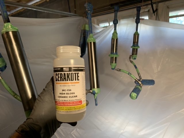

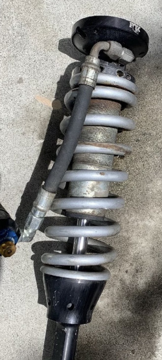

    I used a wire brush and sanding sponge after stripping the clear with aircraft remover. Cerakote clear on the body and fittings, bronze on the springs, black on UCAs. No rust so far. Fox hooked me up with new stickers. I also wrapped the bodies and reservoirs (straight sides) with 3M protective film. I keep a light coat of fluid film just as a precaution. Lots of work, but worth it in the long run.

    Those look bad ass... I would go this route with the clear if mine were not already corroded..
    Talked to fox and several companies around town, they recommend sandblasting with aluminum oxide, 180 grit, start low and the pressure and build up if needed.
    Need to get hooked up with some fox decals.. kartek are running 50$ to replace all mine.

    Just call Fox directly. You might have to cover shipping, but that's a lot less than $50. I can't believe KarTek would charge that much.

    Mine had rust spots as well. You will have to be careful around the anodized aluminum top/bottom. The sanding sponge was to give a uniform look. The wire brush was for the threads. There were areas where the zinc coating was thin, which will have a darker look. I'd say sand blasting might be too aggressive on the threads and will end up removing the zinc coating, it may not. Worth a try on a spot that won't show.
    Edit: This is what they looked like before:62051286-29EC-4958-95E0-EB0B3E4F9D2A.jpg

    i plan on taking the coilover down to the shock body and rebuilding it..
    i don’t wanna deal with it rusting again. So removing zinc coating and cerakoting the body is my plan, then applying the clear for added protection and gloss.
    Cerekote elite is bad ass I have it on a rifle and it tuff.. but colors are limited.
    you did an outstanding job, looks great.

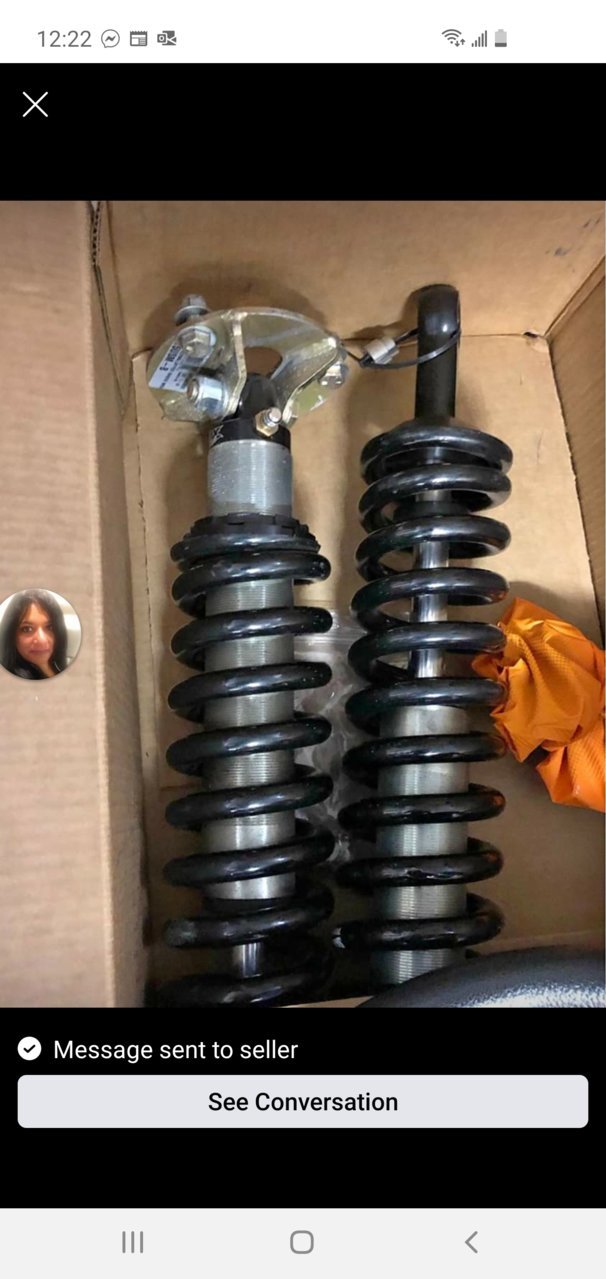

    question on these coilovers are they for 3d gen person selling say so but they look a bit off?

    I would look elsewhere. Those are not an OEM Fox coilover for a Tacoma. Also looks like an extremely heavy rate spring

    thanks so much they looked off to me!
