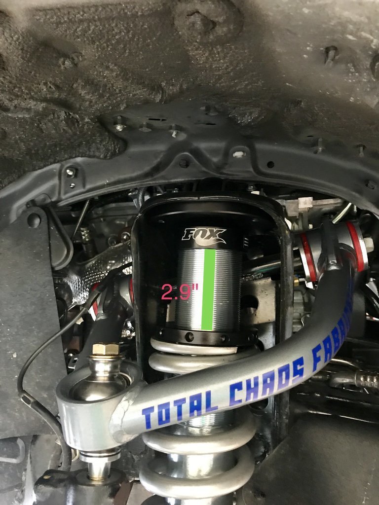

    so this would mean 2 inch's of lift on the 3rd gens, with about 2 inches of threads showing, ? because you have a 2nd gen
    i have seen so many differant answers when it comes to the preload, im getting ready to have mine put on my 3rd gen. this member has his set at 2.9 in. and got 2.75 of lift after settling. im looking at around 1 3/4 in to 2 in. max . for myself, i have preload at 2 1/4, but not sure if i will keep it before install, still looking for answers
    for every inch of threads = 1 inch of lift ..?humm

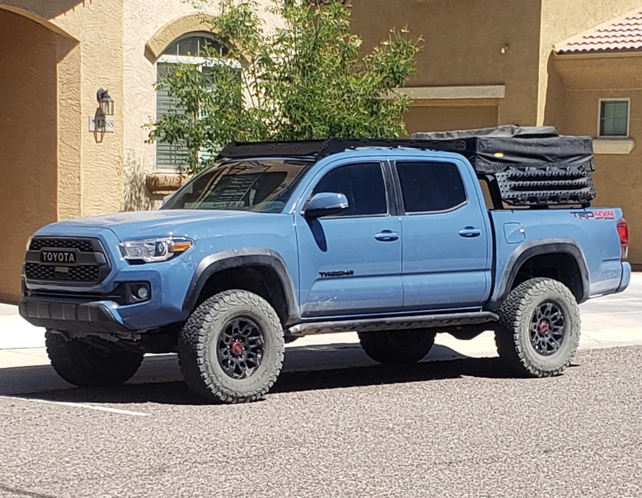

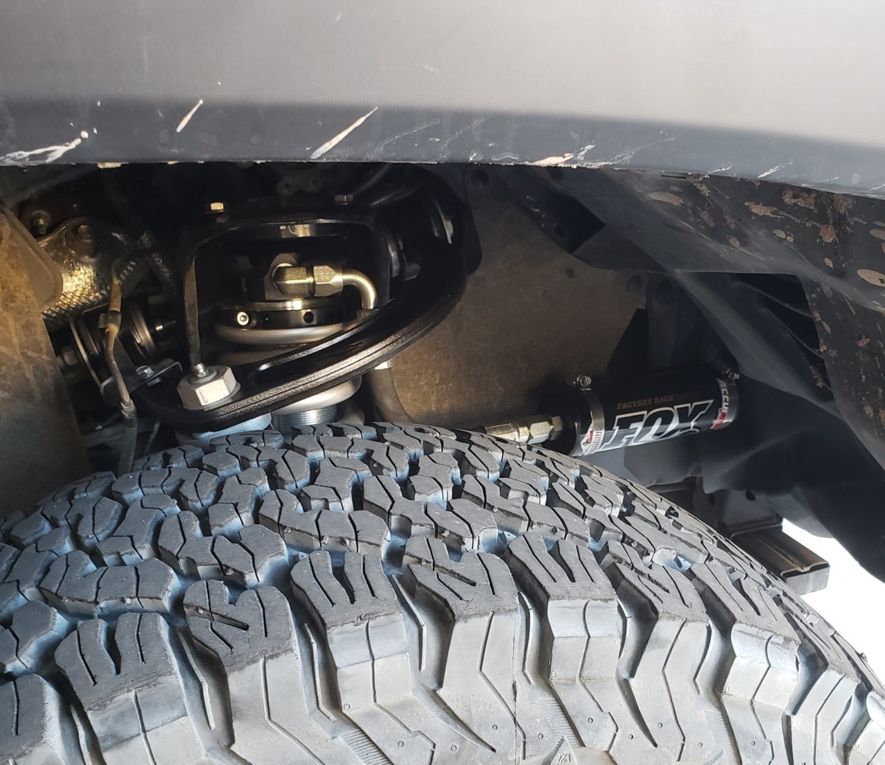

    Hey guys, just wanted to post some pics up after the install. FOX 2.5's all the way around with ICON RXT leafsprings in the back and some SPC's in front. Install went fairly smooth, didnt adjust the preload as they pretty much nailed it. Thanks again, @AccuTune Offroad.

    looks like you have no preload ? adjustment ring all the way to the top.. longer springs

    Yes, I ordered 650lb springs for @AccuTune Offroad to install in fear that the 600's would sag. Read alot of horror stories with OME. Haha

    Threads showing does not equal preload.

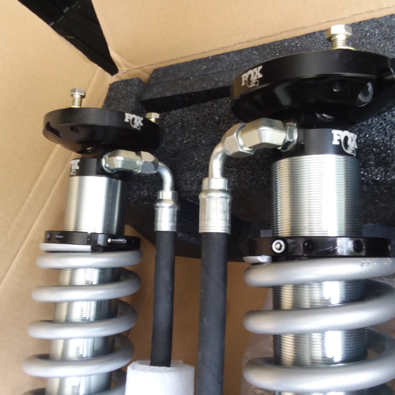

    ok so here is my preload on my 2.5's... 1 inch rear block installed. .. so many different opinions on preload and thread count. i hope im close to where i want to be after install on monday. opinions.. i have them set the same.. thanks20200614_113430.jpg

    How much thread is showing if you measure them just out of curiosity? I would say its pretty common to have the driver side showing more than the passenger side to compensate for the all to known taco lean but each vehicle seems to get different results. Just make sure you have the preload ring set screw facing out when you install them so when you do have to adjust it will be easier for you :thumbsup:. Mine has more showing on driver than passenger side and has no lean either way. I have had to adjust after some settling but it isn't difficult and I'm happy it stays looking level, even though It is close to half an inch of rake like factory but still sits really nice when I haul or load up the bed.

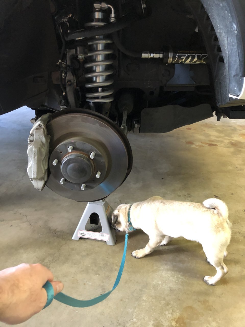

    1” of lift so 12 threads
    My puppy was inspecting my work, but that’s the best pic of preload out of the box.
