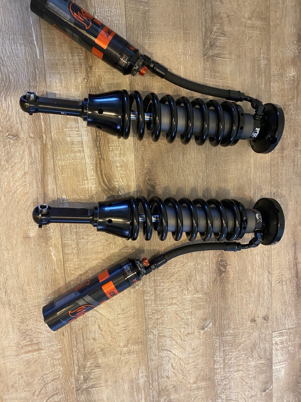

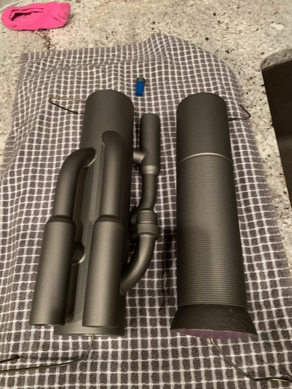

    Finally finished the overhaul of my coilovers..
    Found someone local who rebuilt shocks. Had them taken down to the bodies.
    Then sandblasted and cerakoted the bodies color is stainless. Friend of mine does Cerakote work on firearms.
    Revalved...powder coated the coils, switched out adjusted knobs and decals. Painted the fittings on the hoses. I ceramic coated them dunno how well that will work, but what the hell
  4. Jul 11, 2020 at 4:35 PM
    #2564
    desertjunkie760
    desertjunkie760 @DesertJunkie760 (IG)
    Apr 11, 2016
    #183963
    9,144
    Shane
    2011 MGM DCSB TRD Sport 4x4
    Check My Sig.
    now those look good! Nice work! :thumbsup:

    Fox sent me a set of orange decals for free. Just call them, may have to send and email. The will send you both the DSC strip and larger decal.
    for the adjusters I got from accutune. if they are not in stock try Kartek, or polyperformace.
    cerakote is H-152 stainless.. oven cured. And coil is black semi gloss powder coat.
    if you paint the fittings, use VHT epoxy paint get it or auto zone or o’Riley’s. I Used krylon and it flaked off had to clean and repaint. And do it when everything taken apart. If they are assembled taping and masking is a pain.
    bypasses are still being assembled.

    To cerakote the shock bodies I imagine there was alot of prep work..does added thickness of the coating interfere with the preload collar threads at all?
  10. Jul 28, 2020 at 4:52 PM
    #2570
    cdex8357
    cdex8357 “Everybody gotta die sometime”
    Apr 7, 2018
    #249677
    1,004
    “Dex”
    H-Town
    2013 Taco OR
    Mid travel FOX 2.5 Coilovers FOX 2.5 secondary bypass FOX 12” Triple Bypass
    Prep work is disassembly and sandblasting the zinc coating off to bare metal then Cerakote..
    Cerakote it pretty thin, but my Friend who does it sprayed it thin 2” down, then thicker on bottom. No it does not interfere, unless you spray is thick, multiple wet coats..
    I contacted fox and they recommend Cerakote..

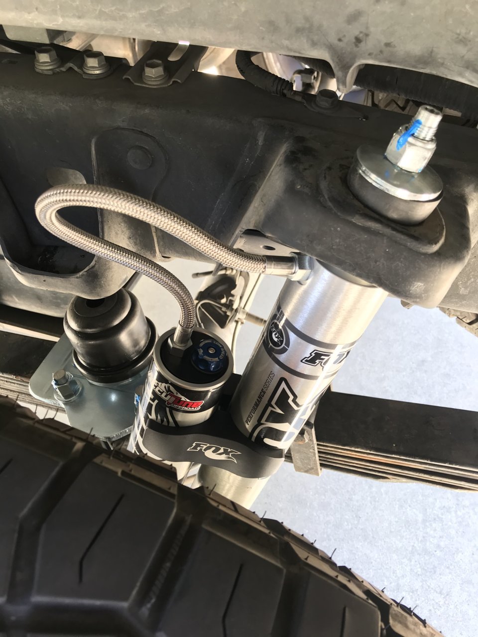

    Got my Fox 2.0s from @AccuTune Offroad all buttoned up today with the help of a local member. While we were down there we added the wheelers ubolt flip kit and super bumps up front. The ride is pretty outstanding so far. I also have some Fox 2.5 DSC coilovers getting dialed in from accutune as we speak. Can’t wait to put those bad boys on 797844E6-91AB-432E-905A-014DDBCC3747.jpg534498C9-C462-44C7-8083-CA1949CC6248.jpg
    outxider and AccuTune Offroad like this.
