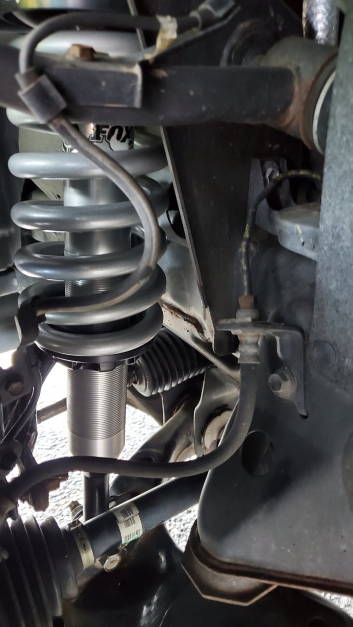

    Got my front 2.5 coilovers installed from accutune. What a difference from stock. Still trying to figure out the best setting for the adjusters but man do they ride great. 6131B0D2-E31D-4385-87C0-E868EF1270F5.jpg

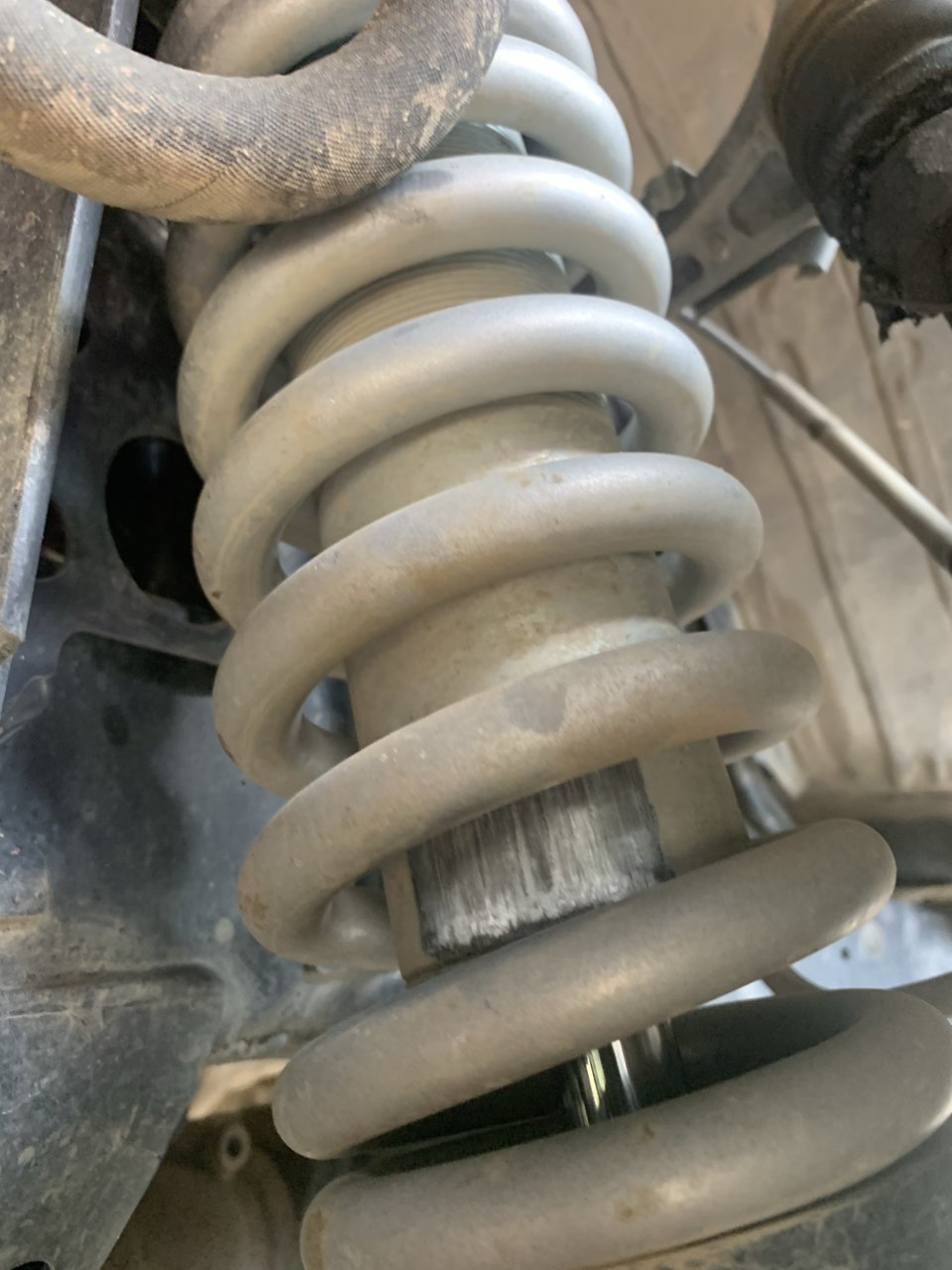

    Anyone have any idea what could cause this scoring? Fox 2.5 remote reservoir dsc. 2009 dclb Tacoma. SPC upper control arms. Not even 6,000 miles on them. Also installed by Toyota when I had my frame replaced. I’ve been chasing down a clunk when on rough roads and think I may have finally found it. B5D0AA4A-21FA-4838-9E87-FE693C464D2B.jpg

    Eww.
    Maybe Bottom uniball chingadera where misalignment spacer is.

    desertjunkie760
    desertjunkie760 @DesertJunkie760 (IG)
    Apr 11, 2016
    #183963
    9,144
    Shane
    2011 MGM DCSB TRD Sport 4x4
    Check My Sig.
    How much preload do you have?

    FR1DAYx
    FR1DAYx Member
    Feb 7, 2020
    #318569
    17
    Zack
    2009 Tacoma DCLB
    How would I go about checking that?

    NukedTaco
    NukedTaco Well-Known Member
    Jan 17, 2018
    #241559
    981
    Wyatt
    Saratoga Springs, NY
    The spacers could also be in the wrong spots, don’t remember off the top of my head which way they go.
