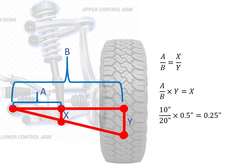

    Let's nerd out for a minute and look at triangles. The relationship between the shock adjustment to actual lift is pretty close to this powerpoint masterpiece. The distance from the lower control arm pivot point to the lower eyebolt (A) divided by the distance from the pivot point of the lower control arm to the tire center (B) is the same ratio as the change in shock height (X) divided by the change in lift (Y). It's not exact but it's definitely not 1:1. Adjusting your shock 0.5" won't get you 0.5" of lift. I rudely measured my truck and it seems the distance A is about half of distance B.
    I'd go for 0.25" of shock height will get you 0.5" of lift as a guess. But forget all this, it's mostly trial and error.

    It’s generally accepted that it’s a 2:1 ratio like you nerded out on. Kudos. And thank you. :cheers:

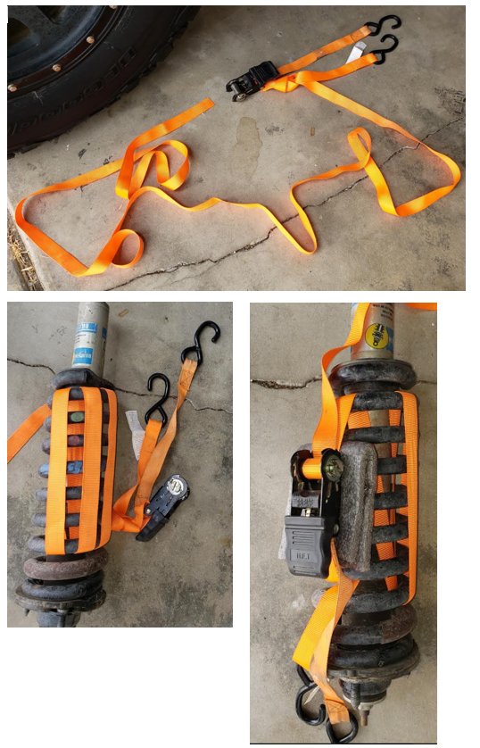

    Do you happen to have a pic of how you used the straps?

    I didn't take a pic on the truck but I snapped a few pics using my old 5100s/oem coil. I didn't use the hooks but I looped the long strap through where the short strap is connected to the ratchet and tied a figure 8 knot (top pic). I fed the free end of the long strap 4 passes around the outermost coils (second pic), in through the top, and out through the bottom. Then I fed that free end into the ratchet, put some foam behind it to protect the shiny fox coils. I tried to make it so my figure 8 knot was was inside the spring, about halfway between the top and bottom coils to avoid any hang-ups on the knot. I made sure the straps were all free of any twists as well. You want the straps to smoothly slide as if the coils were acting like pulleys (Pullies?:notsure:). This might not work so well if the fox springs weren't smooth AF. As you tighten it, you should see all of the straps moving together. I only tightened mine enough to remove any slack. I slowly raised the truck and could see the spring stayed compressed and had about a 0.5" gap to the top hat. I wanted to adjust more than that so I lowered it back down and gave the ratchet a few cranks and lifted back and it had more gap. I could just grab the collar and spin it by hand after loosening the pinch bolt. I used a tool anyway and made sure to keep my fingers clear of the spring in case the strap failed. Did I mention it was sketchy?
    On the second side of the truck, i didn't have good strap spacing so the spring did a slight banana thing. Watch out for that. Make sure the spring is seated properly before bringing the truck back down. Or, in the amount of time it takes you to read this, you could go buy/rent some legit spring compressors. I tried that at first but the ones from autozone are too fat to fit between the coils.

    Thanks, its always good to have a plan B.

    @Tacompa the specialty products compressors 40260 are great. I’ve used them on my truck, 3 other tacos, and an f-150. Def worth the investment. They allow you to adjust on the truck or to completely remove the spring to change springs or rebuild shocks. If you you have buddies in town, you can split with them. That’s what we did. Highly recommend.
