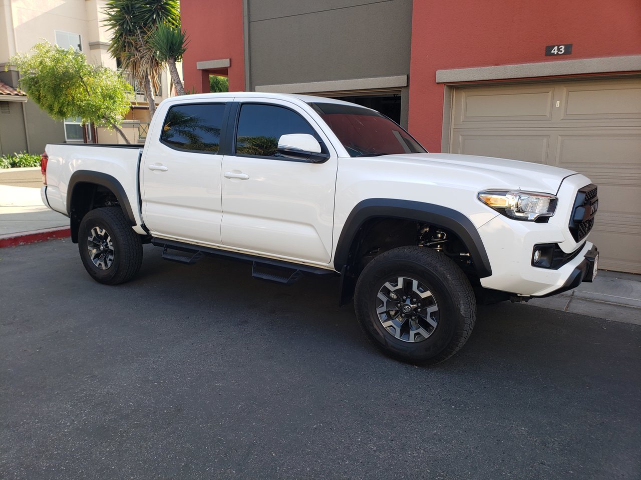

    20200918_162630.jpg But I do love the way it stands right now...

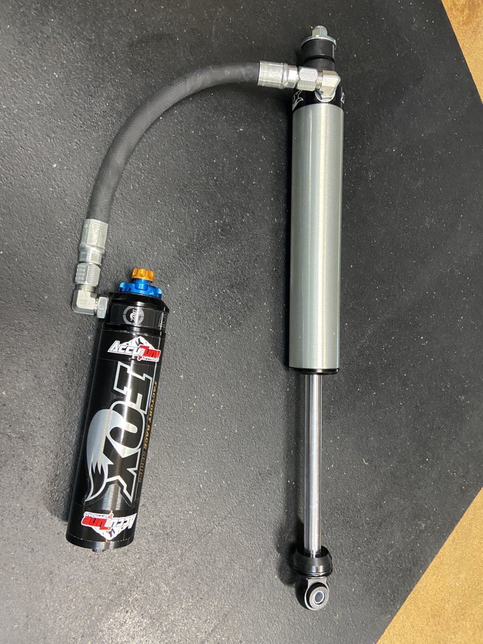

    Got my rears in today from @AccuTune Offroad! Plan on ordering my fronts in the next few weeks. Can’t wait to get everything on the truck! I underestimated the beefiness of these 2.5s!
    ig:txtaco07
    Tacompa, cmbondo and AccuTune Offroad like this.

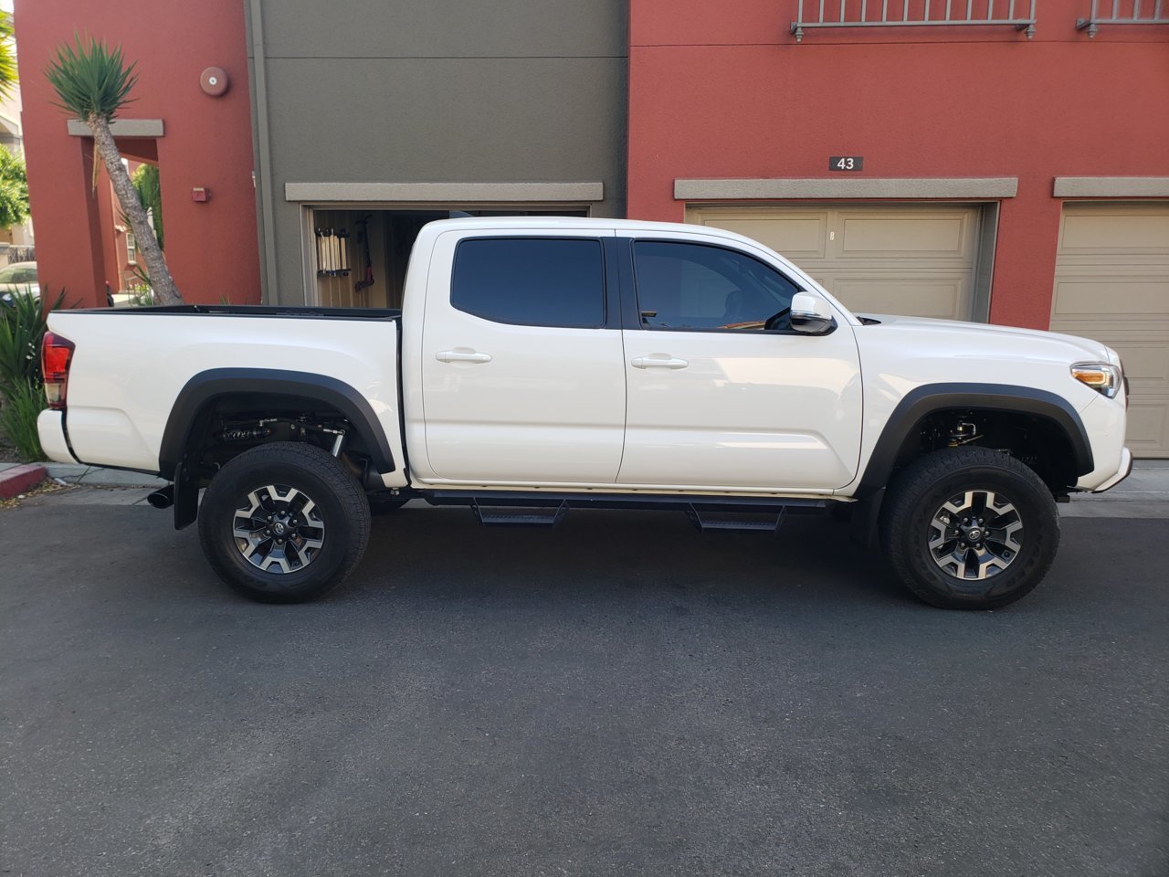

    @MGMStudioTaco I'm as stubborn as the driver side CO. Good news though, the fronts are dialed in now. I ended up using a small diameter metal pipe over the punch for leverage and I didn't F up anything. Pheew! For the life of me, I can't understand why the passenger is cake but the driver is a PITA. Fronts are all dialed in. I'm at 21" top hat to middle of CO eyelet (per ACCUTUNE's suggestion) which is ~2.5" of total lift. On my setup I cannot get a 3" lift upfront without degrading performance. I paid for performance!
    Now, I'm moving on to the rear. I'm running the ICON RXT leaf pack (option #2) with the Tundra rear shocks. I'm seeing about 2.75" to 3" of lift but the ICON documentation says I should be at 2.25". I haven't figured out why that is, it looks like I'll be trying option #1 soon.
