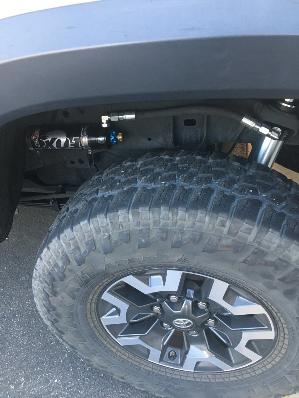

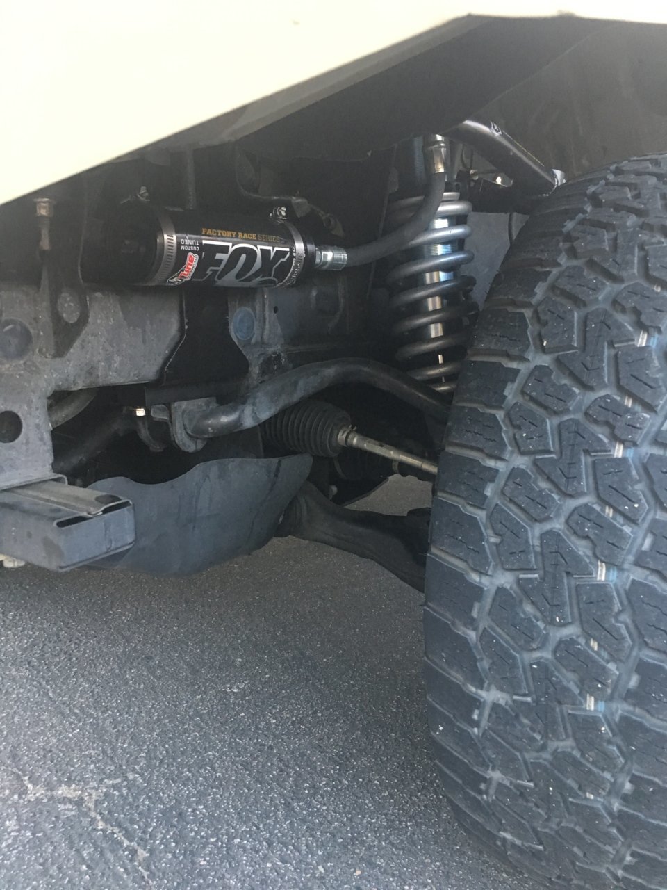

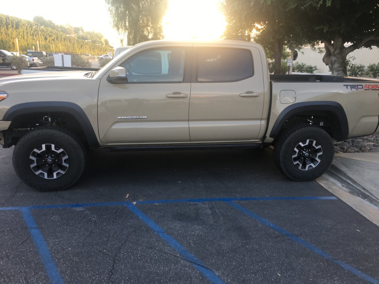

    Finally joined the Fox family..!!
    Fronts are 2.5 with RR
    Rears are 2.5 RR with adjusters
    Icon delta UCA’s
    Icon RXT’s set on option 1
    Archive garage u- bolt flip kit and super bumps.
    Bought and installed by Accutune off-road complete with front end alignment.
    Started at 20 1/2” in front
    And 21 1/2” in rear
    Currently at 23” front and 24” rear
    2 1/2” gain..!!!
    Rides amazing really happy..!!
    Had the ECGS bushing installed in advance and have no vibes from the front or rear and the CV boot fins are not touching.

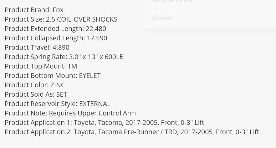

    Wondering if @AccuTune Offroad or anyone else can tell me what the full extension measurement is for the FOX-880-06-418 (2.5 RR DSC extended travel) when mounted to a 3rd gen truck at a 21" max measured preload?
    (Assumption would be this is the full extension measurement when the front tire is off the ground)
    Would someone be able to provide the full extension measurement for the TRD Pro stock front Fox assembly when the front tire is off the ground?
    This is a baseline for my planning on a 2021 TRD off-road Access Cab in completely stock configuration:
    Front Driver (center hub to bottom fender) 21 1/4"
    Rear Driver (center hub to bottom fender) 22 1/2"
    Measured shock ride height, on the ground (center lower eyelet to top of top hat) 20 1/4"
    Measured shock full extension, front tire off ground (center lower eyelet to top of top hat) 21-3/4"
    Difference between ride height and full extension on front shock 1.5"
    Max compressed front shock/spring assembly- unknown ??
    Max front shock travel -- unknown??
    Max rear droop from center of hub to fender lip 18"

    No I do not own the FOX -418, nor do I have upper control arms. My 2021 is completely stock TRD off-road. I haven't done anything yet but rather am looking for some specs which I'm unable to find.
    sorry about the confusion...
    I am looking for measurement of the FOX 880-06-418, specifically the full extension measurement (full droop) for the (2.5 RR DSC extended travel) when mounted to a 3rd gen truck at a 21" max measured preload (center of lower eyelet to top of top hat)?
    Also am wondering what the full extension measurement (full droop) is for a TRD PRO stock front fox coil assembly at full droop (center of lower eyelet to top to top hat)?
    The measurements I provided above in my initial post were the stock measurements of my 2021 TRD off-road that I just purchased that I will use as baseline prior to making suspension mods.

    The fully extended length of that coilover is 22.48". That is fully extended whether it's on the truck or not.
