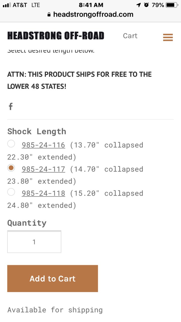

    Would like a little help from you fox guys!
    Just bought the dakar medium leaf packs, will probably net 2 inches of lift. Which part number should i go with?
    Thanks! And happy TG
  5. Nov 26, 2020 at 12:26 PM
    #2745
    RangerComa
    RangerComa 58008
    Mar 14, 2017
    #213317
    2,829
    Adam
    Marin, CA
    17 DCLB
    list is growing fast
    Go with the 118’s. That’s what headstrong recommended a few years back and what I have been running. I also have wheeler's ubolt flip kit and superbumps. You’ll get an extra .5” of travel with the 118’s over the 117’s.

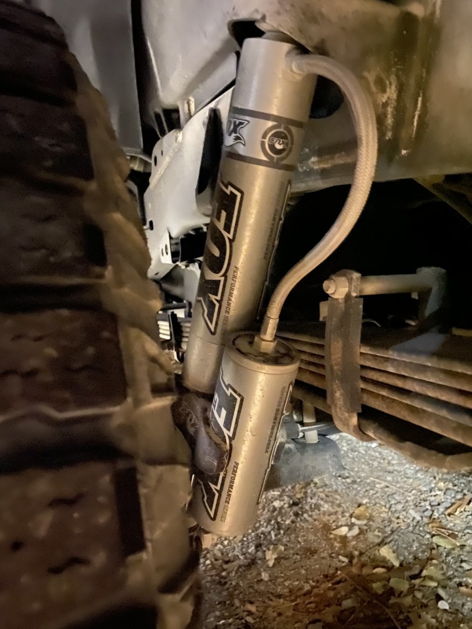

    Careful mounting the 2.0 rear resi’s.
    I Pinched the steel braided hose line the first day after install doing super light wheeling.
    The shop thinks the fox instructions need to be changed and called them and got them to replace the shock.
    Getting the new one installed tomorrow and the shop is thinking of making a notch on the bracket so it can’t happen again.
    Has anyone else had this issue?? Kind of hard to see in the pic but the hose is pinched and all the oil leaked out.
    Blown shock.

    I've wheeled mine pretty hard since installing them years ago without any issues. My guess is the shop that isn't them had that line closer to the shock mount that it needed to be. You shouldn't need to notch the mount.

    Fox 2.0 Coilovers|Fox 2.0 Rear Reservoir Shocks | Icon 1.5 AAL w/Overload | Method 305 NV 16 X 8 | Falken Wildpeaks 267/76/16 | | Diode Dynamics SS3 LED Fogs | SR Grille Surround
    how far down the shock body is your reservoir clipped on? I think they moved mine up towards the top which made the hose more curled upward.
    They were worried that the reservoir mounted down lower would get hit or something.

    Here’s a pic from afar you can see how the hose looked.

    @lorsteez, mine are lower than that so the hose comes straight out.

    Mine are mounted like yours, but turned just a hair towards the tire, so it clears the bucket. Years of use with no issues. Yours was installer error.

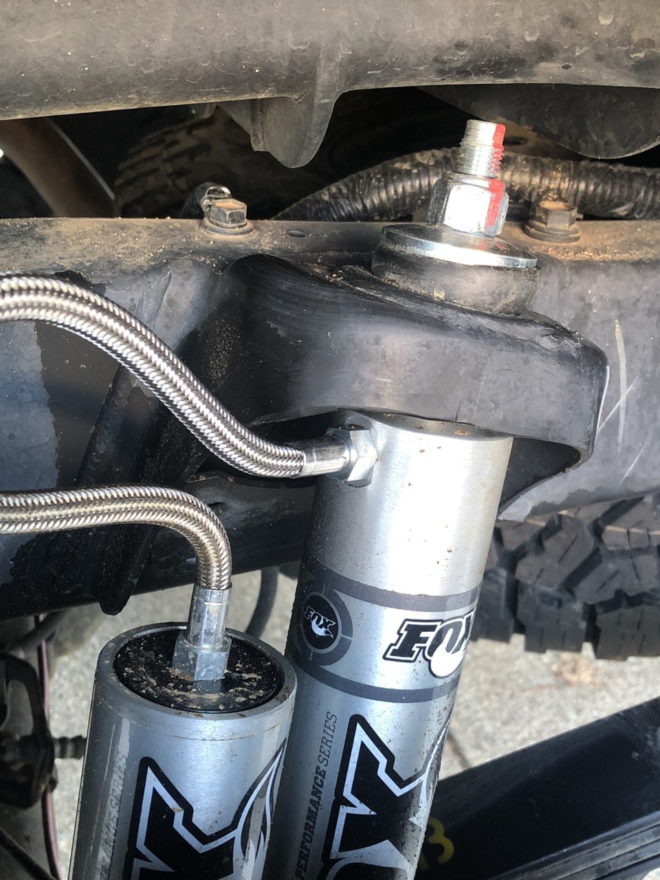

    FOX dropped the ball on mounting the resi to the body, they turn and pinch the fragile resi hose like your did. The best fix is a new resi hose, a 90* fitting coming out of the body, and to frame mount the resi. I've done 15-20 of these like this for 4runners and Tacoma's with zero issue.

    Any insight on notching so the hose can’t get pinched? That’s what my shop wants to do.

    I had the same issue with my 09 but with icon shocks. I saw this as a potential issue so I used a die grinder to clearance the area. It was just one side that was too close for my liking. I wouldn’t necessarily say this was an error on fox’s part but just a variation in how the trucks are built.

    shouldn't be a problem to make some space for the resi hose.
    A few options
    Bolt on:
    https://www.amazon.com/Fox-Shox-803-02-042-Universal-Reservoir-Mounting/dp/B00ZBB4WY8
    Weld on:
    https://www.polyperformance.com/poly-performance-weld-on-reservoir-mount-kit

    Just rotate the shock so theres a nice gap between the hose and the mount

    I have the same rear setup, rotate the nipple out toward the tire but still keep the reservoir away from hitting anything. I still have about 2” of clearance between the line and the tire and the nipple is plenty clear of the perch.
