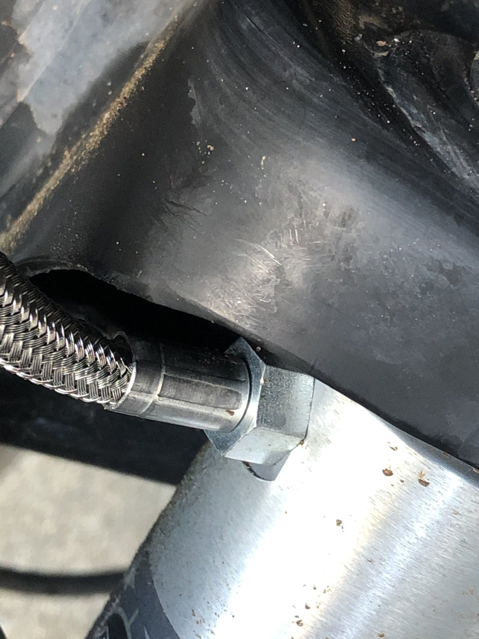

    Appreciate all the super helpful posts!
    The shop ground down the perch and rotated the shocks a bit on both sides.
    A lot more clearance now, will post a pic later.
    I can see how this issue might be worse for some than others just purely depending on how your bracket came out of the factory.

    This is a known issue and has been covered many times. Definitely a poor design on Fox's part but the shop should have also been more aware. It's obvious that the shock will move with the rubber bushing and there is little clearance between the fitting and mount.

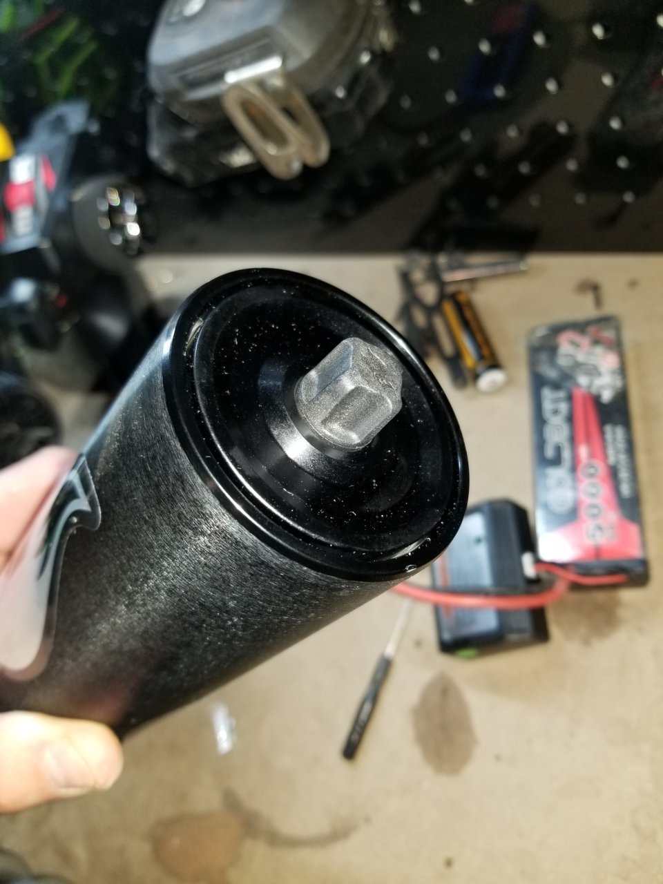

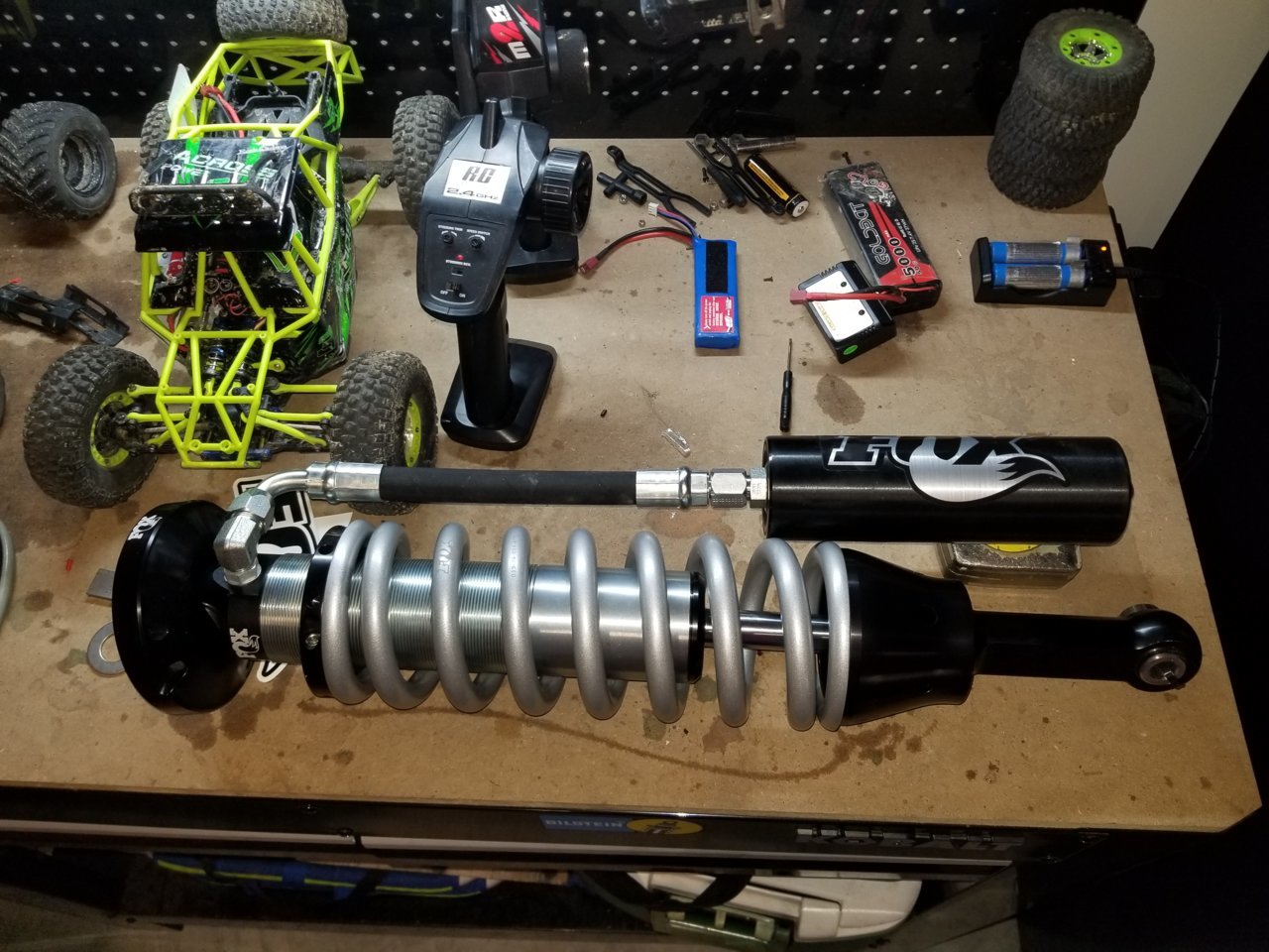

    Just got my new 2.5, resi but non dsc. They have a small black knob on the end of the resi that turns but I didnt want to turn it too far out, anyone know what this does or is for?

    Looks like a cap.

    Well what is it capping?

    Probably the head of whatever screw is under there

    A fill stem? The nitrogen needs to get in there somehow.

    Exactly. It's just a cap for the schrader valve underneath it to allow for the nitrogen charge.
