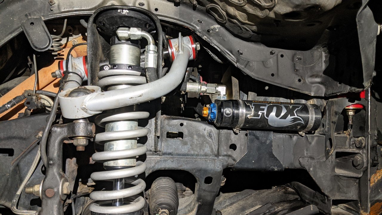

    I went with the extended travel Fox 2.5’s
    Front and rear from accu-tune
    Icon tubular delta joint UCA’s
    Icon RXT leafs on option 1
    And got exactly 2 1/2” of lift front and rear.
    Definitely go with the extended Coilovers and UCA’s
    The ride quality and extra droop is really nice.!!

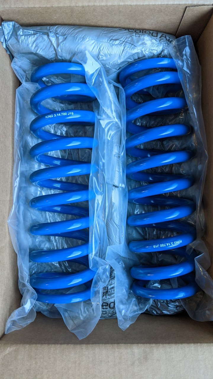

    My 700# 14" King Coils are supposed to be arriving tomorrow, would be a great to get them installed so I can ride Kox for Christmas.
    What's the best way to swap the springs out at home? Anyone have experience with this guy?
    https://www.amazon.com/8MILELAKE-Ma...&sr=8-5#aw-udpv3-customer-reviews_feature_div
    I used the clip on suicidal type rental from O'Reilly's when I cranked my originals down.
    With the 700# is it still safe to use the single set screw style top spring perch or should I order another lock ring and double up the purchase area?
    How much preload should I have on them? Fox recommends measuring from the beginning of the threaded body to the top of the lock ring, right now I have my 600#'s screwed down to Fox's maximum recommendation. (1 3/4" IIRC.)
    Can I relax the spring on the truck without hurting anything or should I compress the spring before loosening the lock collar?
    Thanks for helping a newb out with mid travel.

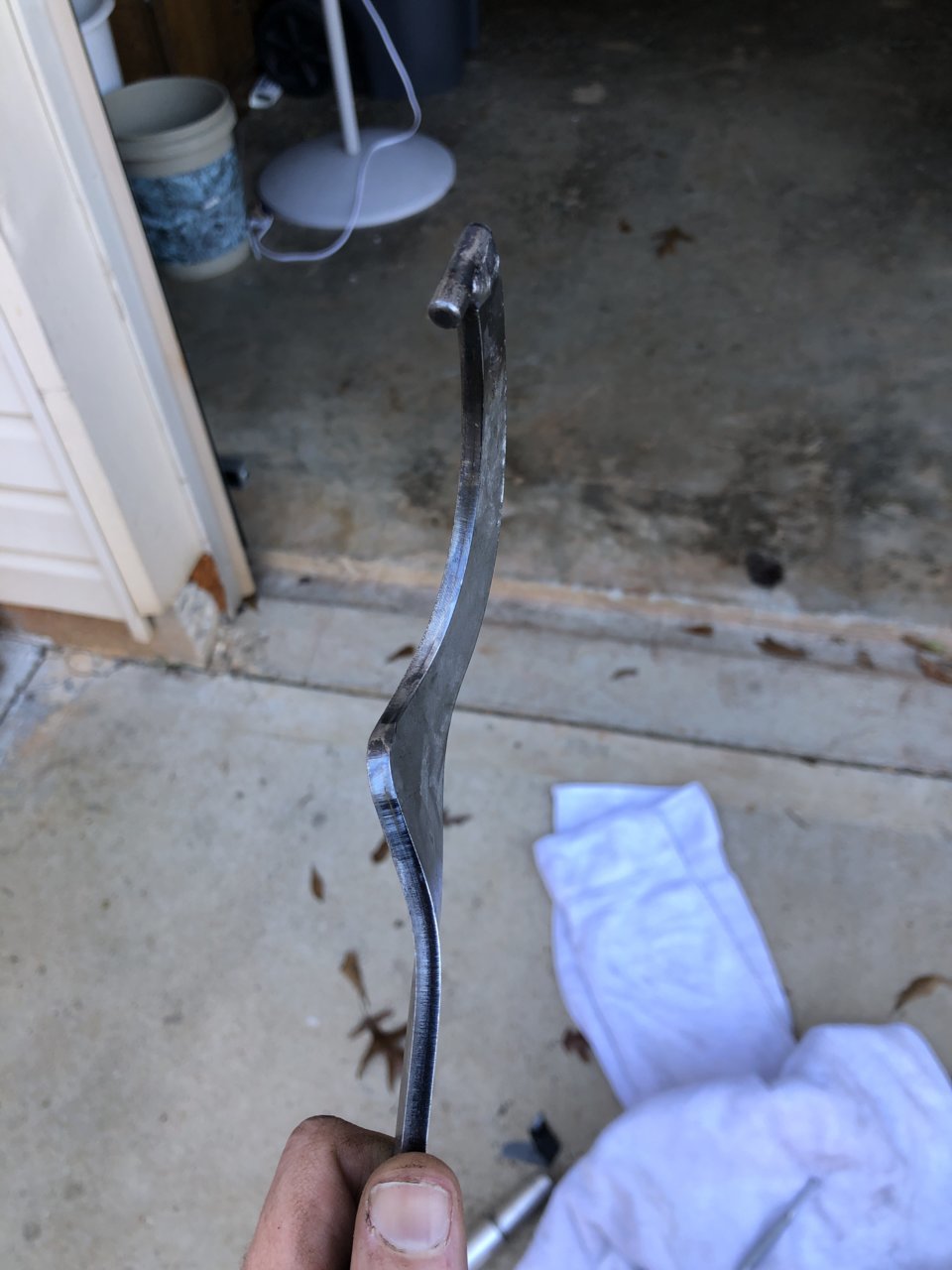

    Use a spanner wrench they said
    itll be easy they said!
    but really, ended up having to use a thicc boi punch and a breaker bar on the end to turn mine. Truck was in the air and every thing. Not sure why mine were so hard :confused:

    Yeah I used a punch to turn mine down originally. Some T-9 Boe-Sheild lube made them go easy.

    Got my 700lb'ers for Chrimmis.
    Now the hard part of installing them on my Foxes.

    Yeah mine are at max for what Fox recommends and I'm practically at stock ride height.
    For what it's worth, in my research most sources say not to get 700lb springs unless full armored with gear etc. If you don't have all the gear get the 14" 650s.
    Also consider revalving.
