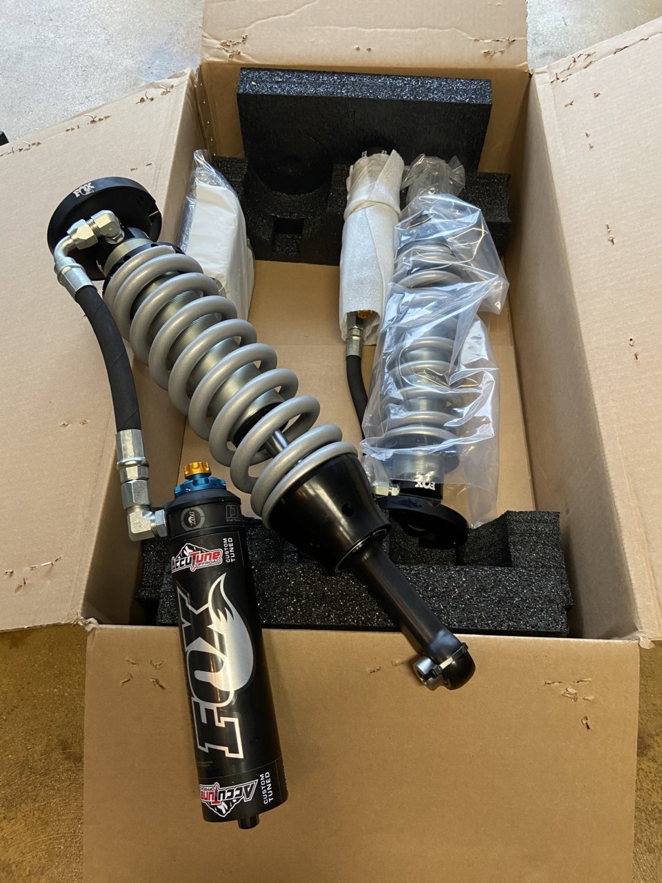

    Weathertechs Tint Led Interior Method NV TRD Pro Bilstein Suspension Icon AAL CaliRaised sliders
    Just wanted to say thanks to @AccuTune Offroad for all of your help. Can’t wait to put these on. Thanks Ryan, Kenny, and everyone else for answering all of my questions and concern...and thanks for being patient with me. Excellent service.
