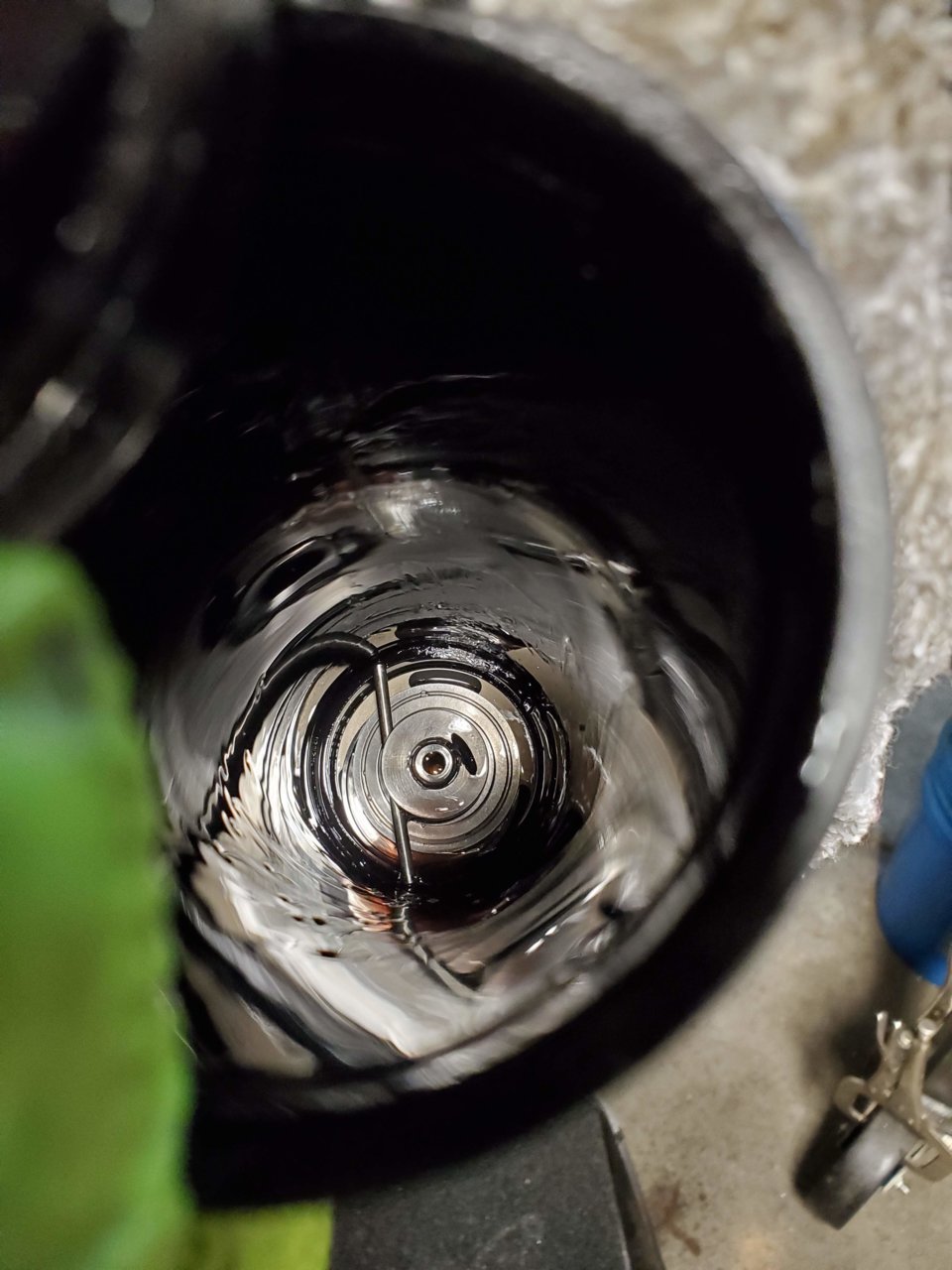

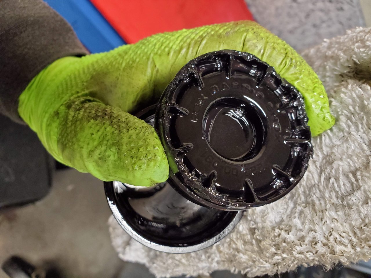

    Sounds like you were all the way out with the adjustment and broke the pin and or the housing by turning it to far.
    Get it fixed sooner than later so you don't damage even more parts and cost you more.
    A set I had last spring.
    That bar should be straight, it bent and came out of the groove that holds it.
    The IFP was running into the broken parts.
