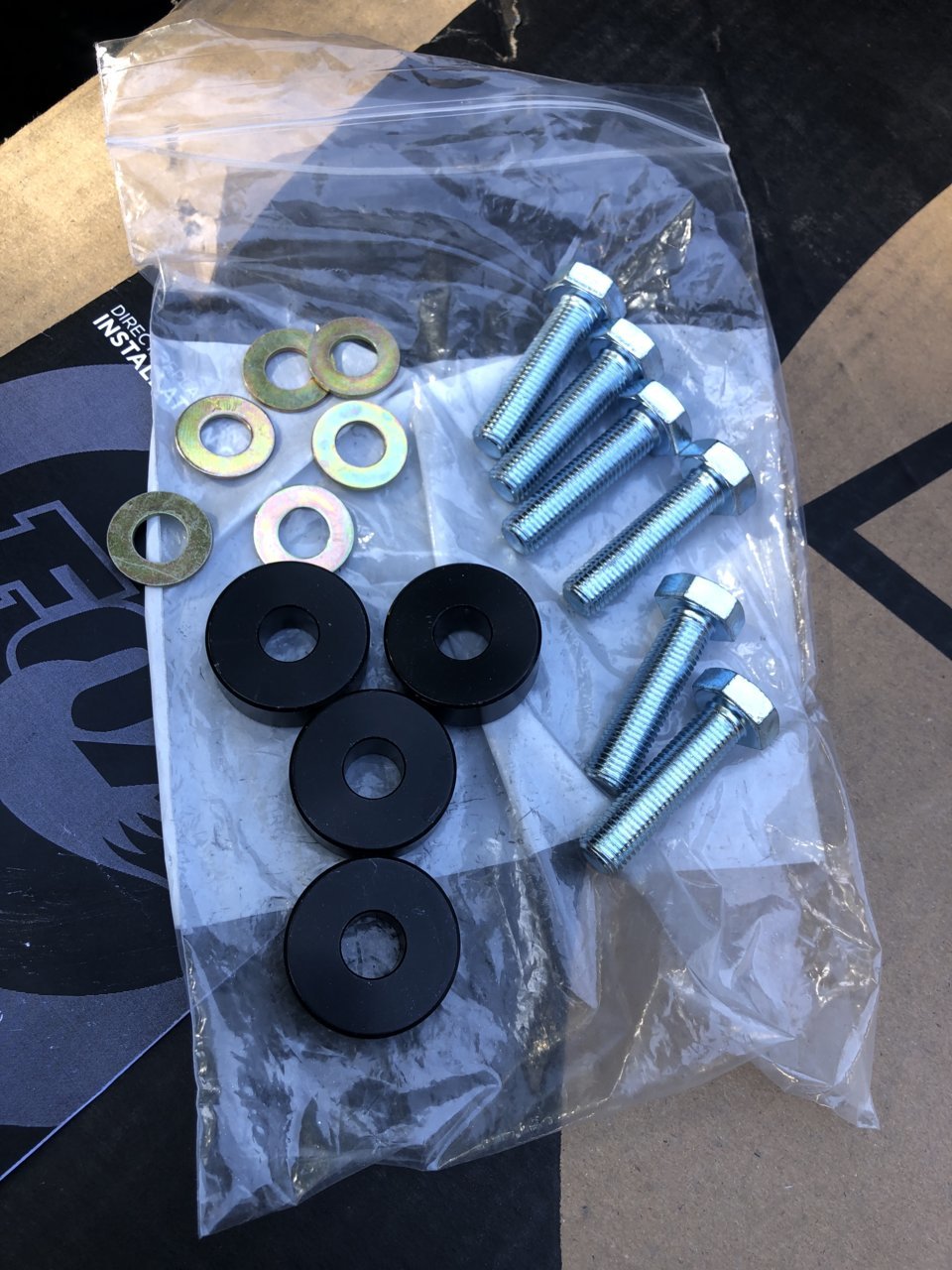

    Shock eyelet bushing spares?

    Thanks for the reply! My installer that was his initial guess but they are metal.

    I'm pretty sure I had those parts leftover as well. Truck or shocks haven't exploded yet so I'm inclined to believe they aren't needed for our trucks. If I recall, the bolts were too big for the washers and tall to hold the shock in the mount.

    There for the 4Runner skid plate brackets (I believe if the 4Runner is equipped with KDSS system) to space the skid plate brackets away from sway bar.
