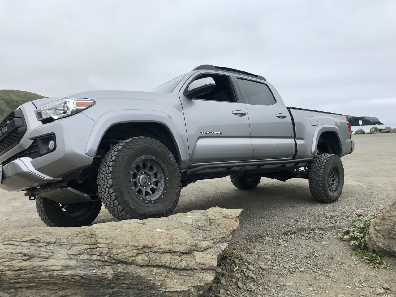

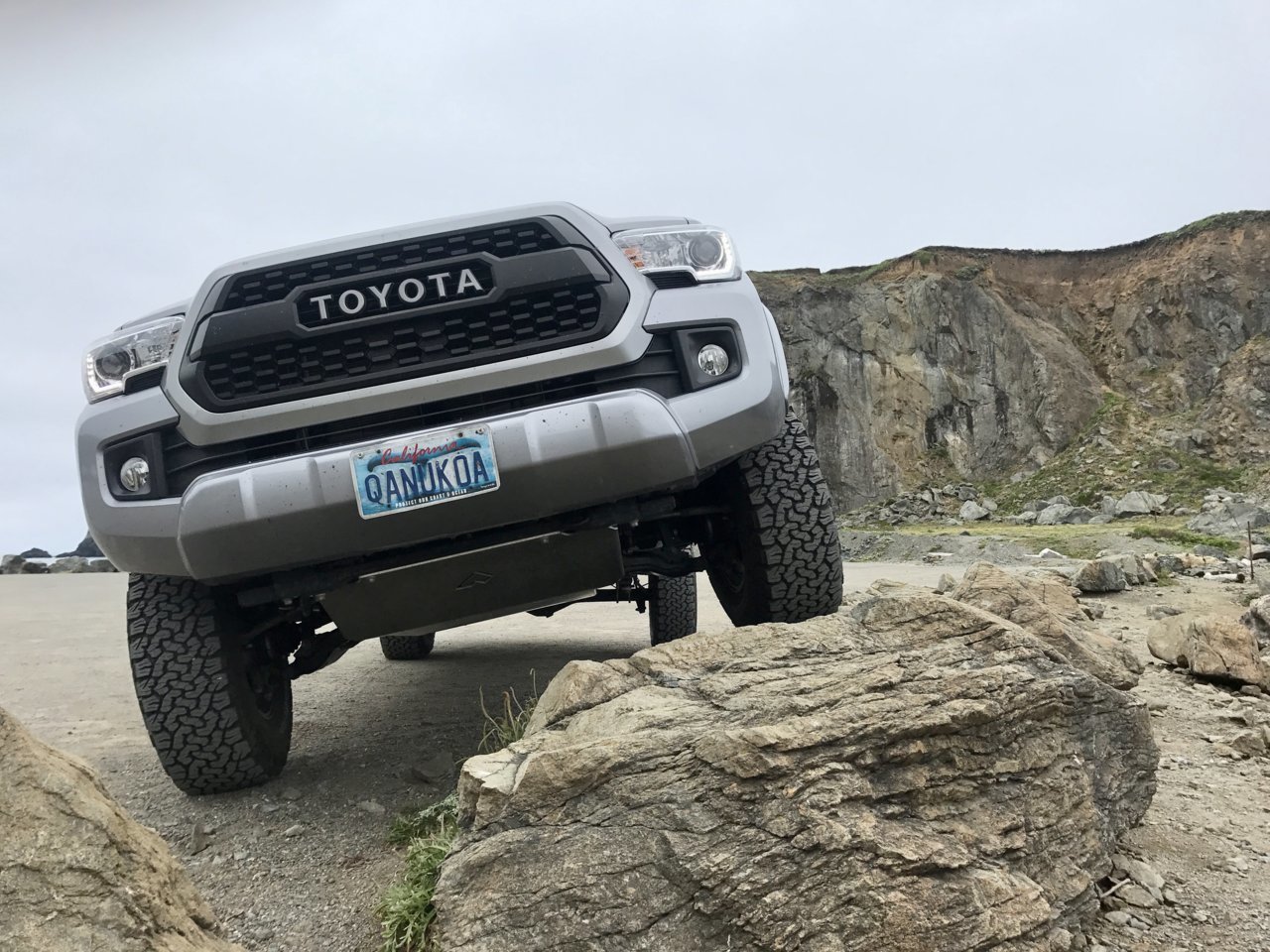

    I have a thread or two extra showing on the drivers side and some sand bags ballast on the passenger side of the bed to offset the fuel tank. My ride is pretty smooth and level bc of this.
