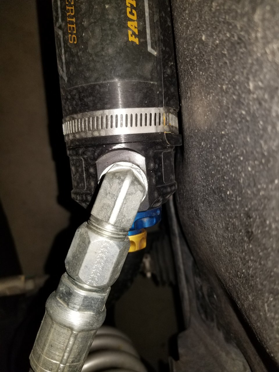

    Too much. Mine were like this and they rubbed. Of course your wheels and tires may vary.

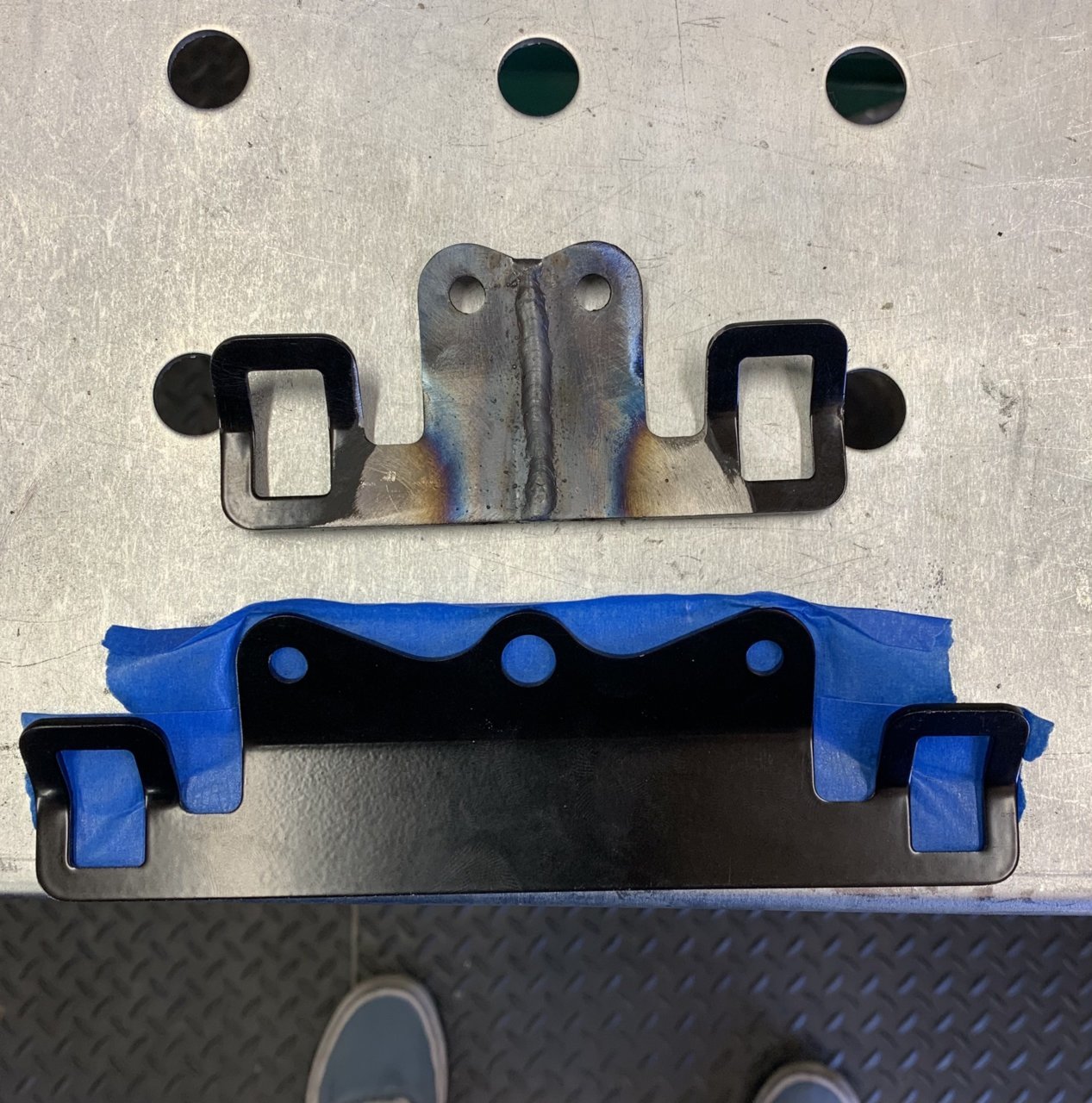

    Playing with some mounts today. Shocks will be in tomorrow, @AccuTune Offroad got me set up with some FOX-985-26-118 shocks. I’ve seen some people say the universal reservoir mount fox sells are a little to big for the 2.0’s reservoirs. According to fox the resi’s are 6” long so I cut about 2 1/2” out of the center of the mounts and welded them back together. Should fit nicely now

    Awesome work. Yes the mounts are way to Long tho. Mine look like poop
