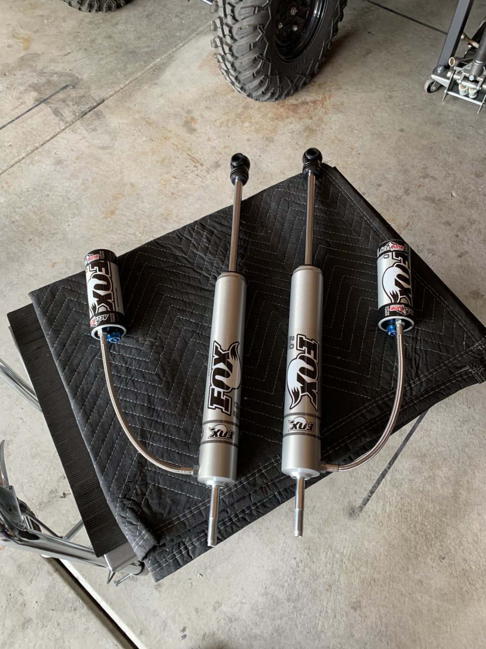

    Mother’s Day special delivery! Thanks @AccuTune Offroad can’t wait to put some miles on them.
    With the shorty mount
    Also plan on replicating this hose mod (originally posted by @TMFF) thanks again Tim for the great idea
    :cheers:
    TMFF and AccuTune Offroad like this.

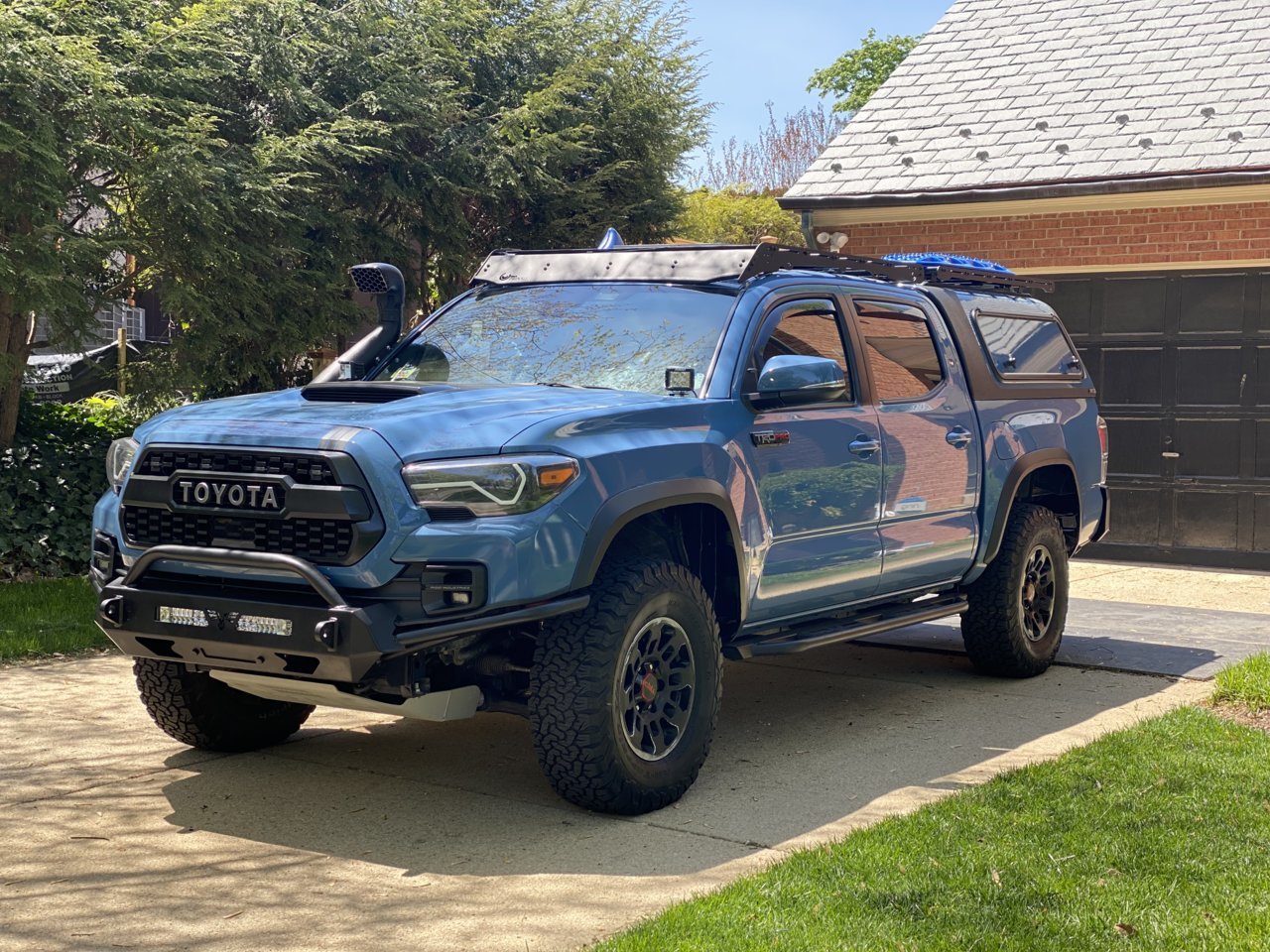

    Armor: Custom Fabricated Front Bumper (Victory 4x4 Blitz w/ full width tubing added after) Victory 4x4 Strike Steel Rock Sliders Coastal Overland Rear Bumper w/ Dual Swing Out Steel and reinforced Hitch Receiver RCI Full Aluminum Skid’s Wheels/Tires/Suspension 34” BFG KO2 (Full size spare on swing out) 17” KMC Impact (black) Fox 2.5” Front Coilovers w/ DSC Adjuster Upgraded Springs: 650 lb Eibach 14" Long 3.0" ID Coil Springs Total Chaos Upper Control Arm Fox 2.5" Remote Reservoir Shock Kit for Rear w/ DSC Adjuster ICON RXT Leaf Spring (Option 3/Heavy Setting) Wheeler Superbump Front + Rear Bumpstops ICON U-Bolt Flip Kit Body Mount Relocation ECGS 8” Clamshell Bushing (Eliminates Needle Bearing) **For Refrence: Suspension set up is equivalent to Stage 4a Acutune** Performance/Off-Road Stuff/Recovery Nitro 4.88 Regear installed by ECGS Dobson 4x4 Snorkel Differential Breather 10k lb winch (Smittybuilt) Extended rear brake lines Hi-Lift Jack w/ weatherproof cover included (mounted to roof rack, can also be mounted to swing out) Air Compressor and Air Hoses included 4 ton jack stand included Tree saver winch strap included D-Ring Shackle x 2 included Spare Parts Include: 1 Wheel Bearing, 1 Tie Rod End Interior Accessories Custom Rear Seat Delete Platform Dashtop Multi-Mount (DMM), Will include 3 RAM mounts, one radio mount and two phone mounts iPad Mount, attached to passenger seat bracket, used for navigation Headrest Velcro Pouch Kit (Blue Ridge Overland) Overhead Storage Attic (Blue Ridge Overland) Trash Can (Lusso Gear Spill-Proof Car Trash Can, 2.5 Gallon Hanging behind Passenger seat) Fire Extinguisher Mount Exterior Accessories/Storage Prinsu Cab Rack Rugged Case (47” weatherproof rifle case mounted on Prinsu roof rack) Custom Roof Rack on Camper (designed to fit traction boards perfectly with space on either side for bikes or storage cases) Tailgate Storage, custom design using deck hatch that utilizes the interior space of the tailgate where I store recovery gear. Overland/Camping: Camper Custom (see details below) Bed light Bed lighting Domestic Fan Swing Up Rear/Side Panels with Locks Roof Rack 200 watt solar panel LED Third Brake Light Rear View Camera (connects to video rear view mirror in cab) Hurricane Hinges (not in the first few pictured as it was recently installed, you can see them in the later pictures but they are now painted black not silver to match the camper, totally waterproof no leaks!) Bed Buildout/Living System Baseboard/Mounting Plate (1/2” Birch, Bed Liner Coating) Trunk Cabinet Shelf Cabinet (fits 2 Sidio crates plus top storage box w/ organizing dividers) Elevate Fridge Cabinet w/ under storage for stove/cooking gear Custom 8020 build - strong enough to sit/stand on Water: 10 Gallon Water tank with pump, two spouts, one in back seat one in the bed 5 lb Propane Tank w/ mount attached to Swing Out (likely included, final tbd) Drop down table (attached to swing out) Rear Seat Delete (custom) Lighting: Rigid Adapt 30” Light Bar Rigid Ditch Lights Quad LED Headlights Meso Dual Red/White Interior Lights (Map + Dome) Camper interior lighting Electric Dual Battery System RedArc BCDC 25a Controller 90 Ah AGM Secondary/House Battery 200 watt solar panel 2 Blue Sea Fuse Boxes to manage accessories (one under hood, one in bed) Extra fuses included Comms: Midland Micromobile GMRS WeBoost w/ extended antenna on a RAM pivoting mount Other Fumoto Oil Change Valve Bike Rack (Tire Mounted)
    Fox 2.5 w/ DSC + 14” 650 lb spring is going in soon. Don’t care about inches of lift just functionality. Mostly need to clear the 285/75r17 that will be going on (and yes I’ve trimmed, body relocated, pinch weld, etc).
    Front weight includes half bumper, winch, dual battery, sliders, rear bumper. Will be adding skids in future.
    Need advice on preload. Thinking 1 1/8” on driver, 3/4” on passenger. Thoughts?
    I know they say 21” max from top to bottom eye. That is on the truck right? What does this look like before they are on (they are still on the way so I don’t have them in front of me yet)?
