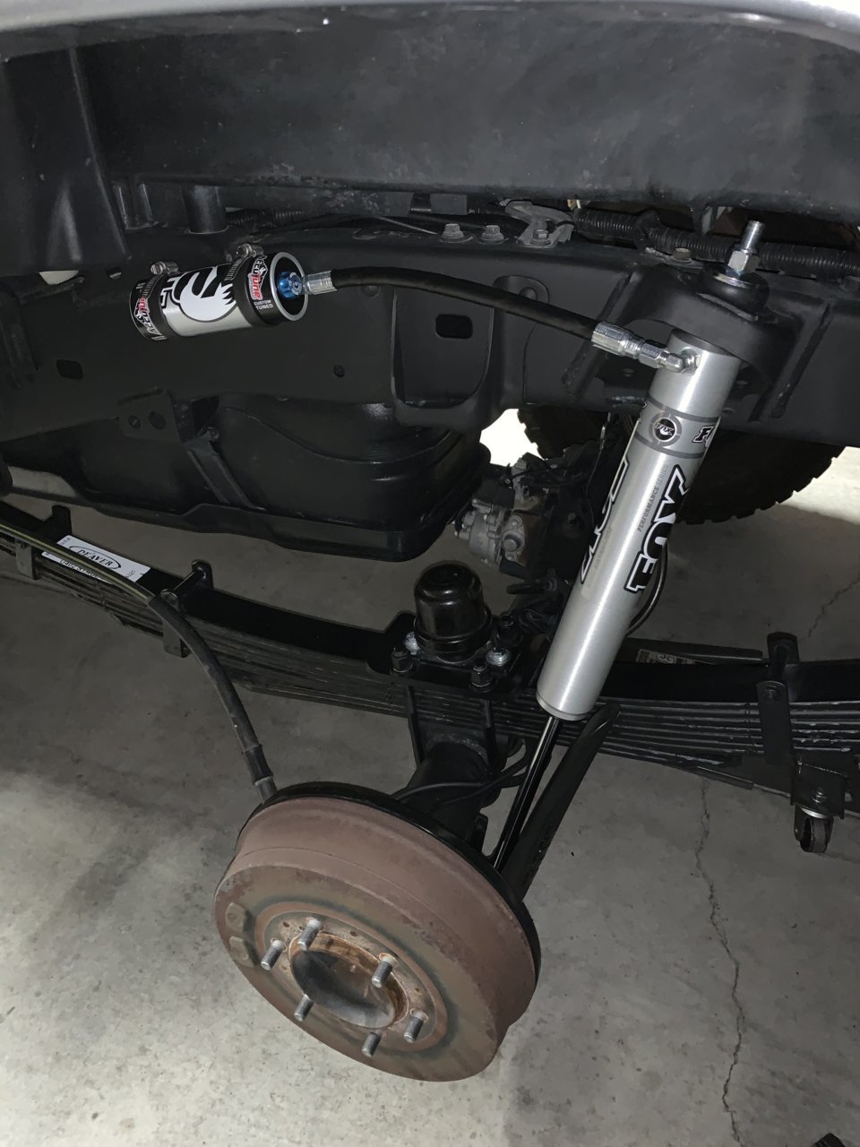

    Install complete, big thanks to @AccuTune Offroad for the custom valving, @TMFF for the great ideas, & Desert Speed Shock Tuning for the upgraded hoses. Loving it so far!!

    Looks awesome.

    That looks like a very clean undercarriage. Also jealous of your hoses, so to speak.

    That's how Fox should be building them for all Tacoma and 4runner rear 2.0's. Every one I rebuild gets the hose upgrade to frame mount them.

    Thanks man :cheers: not a big fan of rust. Always trying to combat it in Utah. Have also been playing with the rear end a lot the past year, spent lots of time to "polish it up".
    Agreed. This just seems to be the answer IMO.
