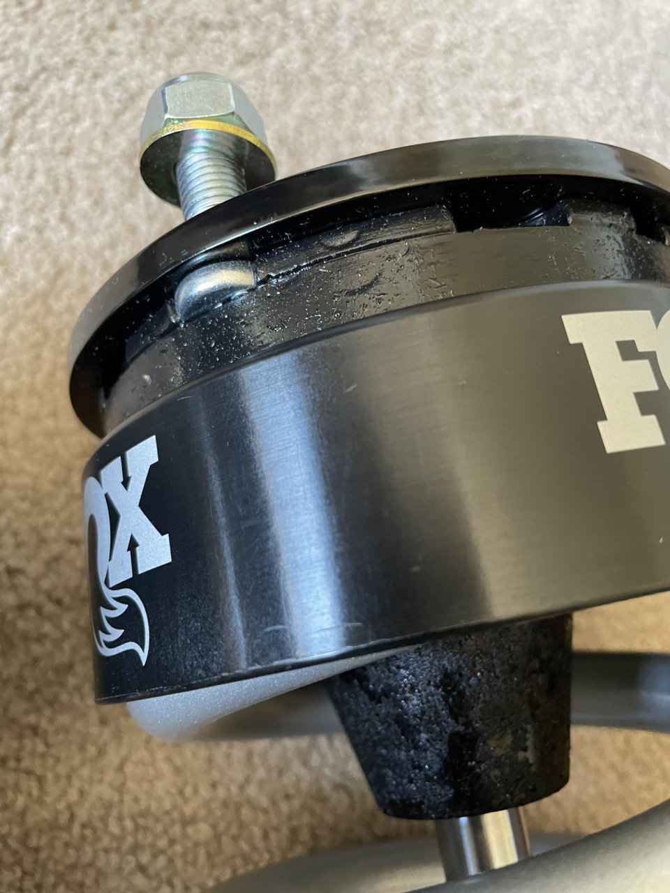

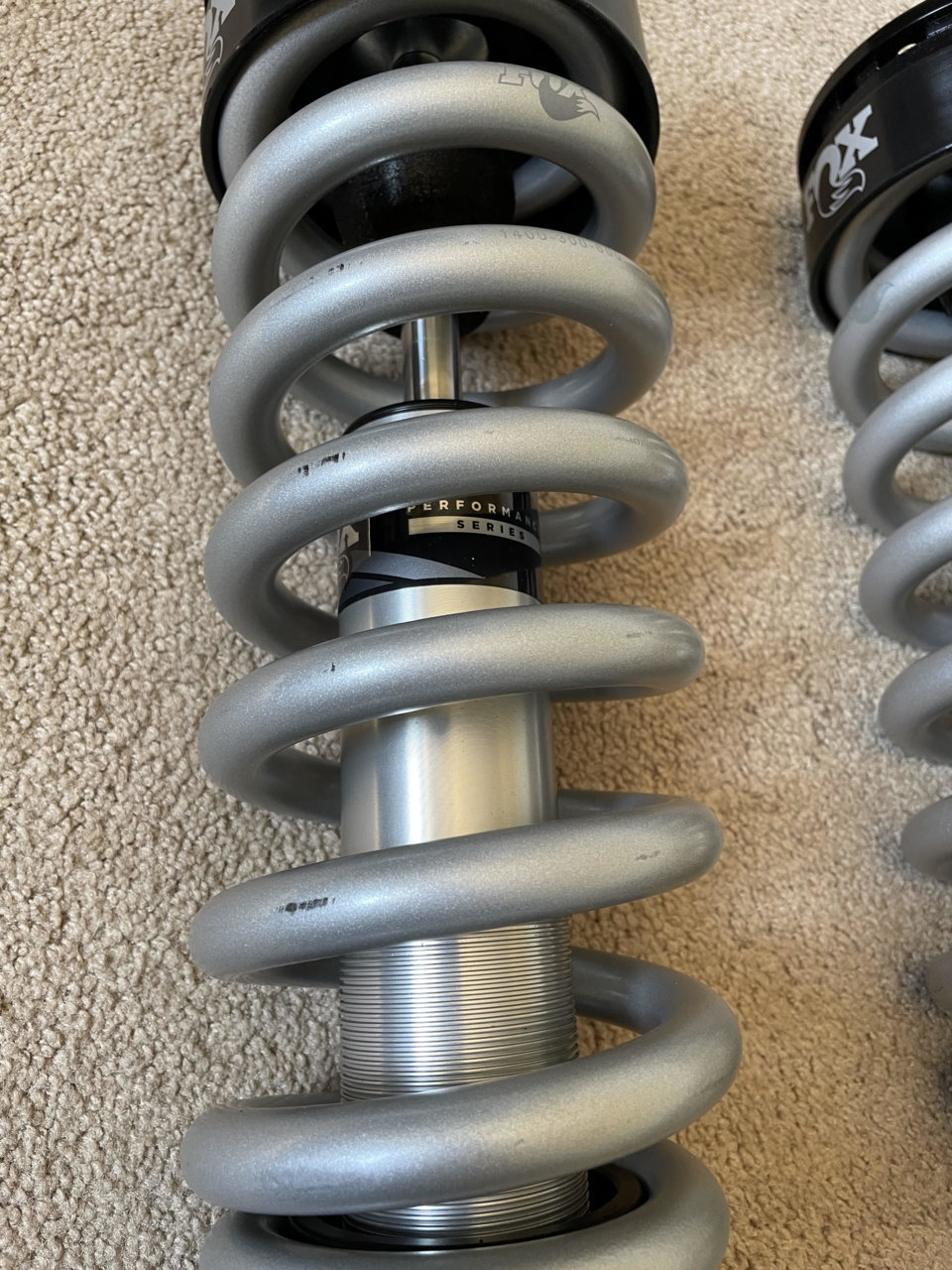

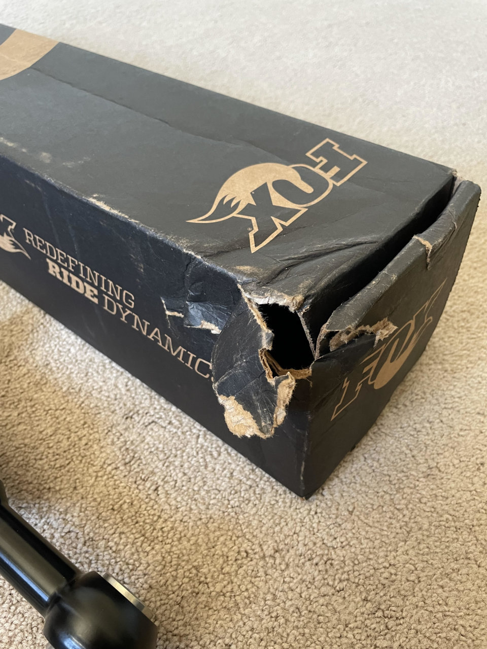

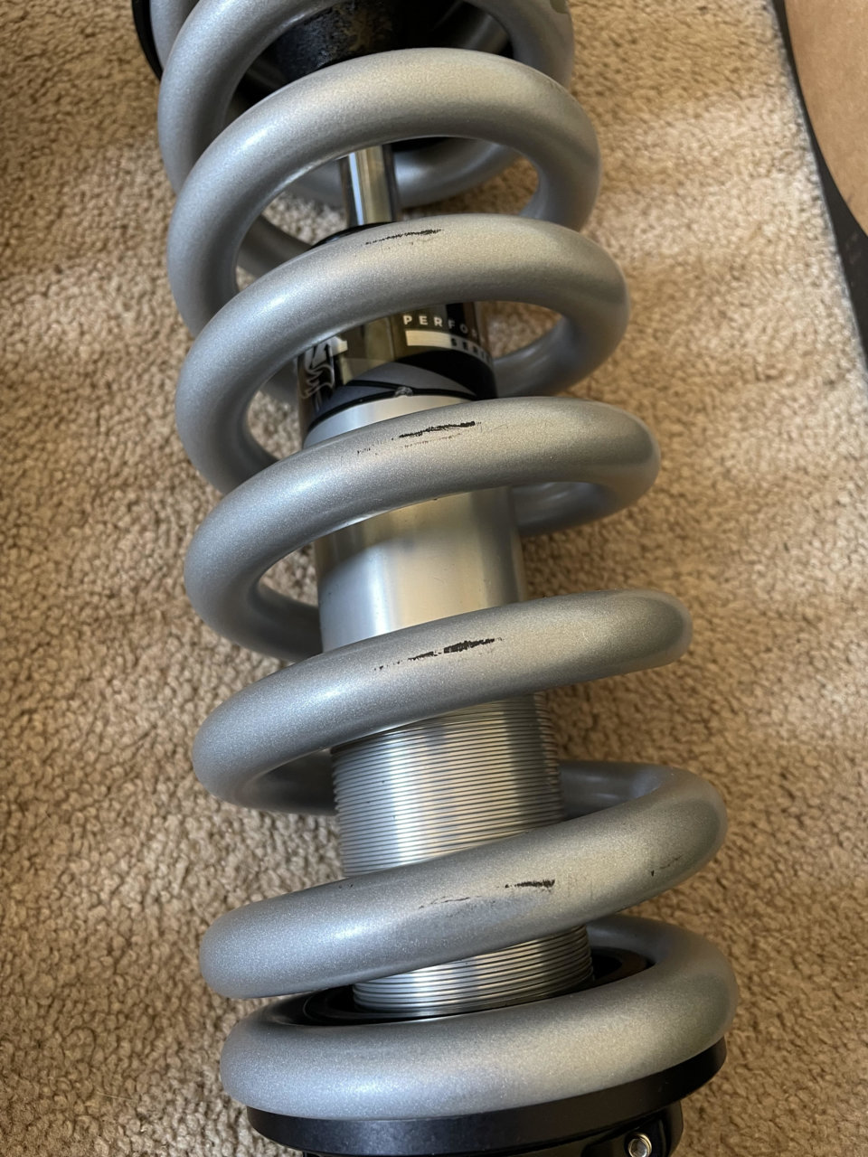

    I just received my order of Fox 2.0 front and rear from Shock Surplus. They shipped the rears in a different package from the fronts. The rears were delivered by UPS on time and without issue in a box that was still in good shape. The fronts were not so lucky and I got them a few days later from FedEx and the box was pretty beat up. One of the Fox coilover boxes has a big hole in the bottom and the main box the coilovers were shipped in(they were both shipped in one large unmarked box) is banged up bad. I'm inspecting the shocks and there are scratches all over the coils and one of the coilover caps(the black things with the Fox logo on top of the shock) has oil on it.
    Is this normal or something to be concerned with? These aren't the highest price or performance shocks, but this seems f****d up. Should I return them and ask for them to ship new ones? Any advice is appreciated.
    It's tough to get a pic of the oil on the cap. The rest are pretty indicative of what condition these shocks are in.

    I ordered the same two weeks ago from ShockSurplus. They want they buyer to pay for insured shipping for damaged or lost packages, which i thought it was their responsibility to pack the item appropriately. Their shipping insurance had horrible reviews so I didn’t pay the extra $ on it. Luckily, I live pretty close to their distribution site so it did have far to go. Even still, one of the coilover boxes looked like it was ripped and torn and re-taped. The coilover was fine as far as I can tell. If your coilover is damaged, I’d hit them up and ask for an exchange.

    I'd be most concerned with the oil and where it came from. Is the shock leaking oil?
    I had damage to my Fox coilovers when I got them a few years ago. I contacted the company I bought them from and they immediately filed a claim with UPS and sent me another set. I had to take a bunch of pictures to send to UPS. In the end, they never asked for them back so I sold them locally. I guess it worked out pretty good for me.

    Ha, I hate money too… that’s why I’m on this site all the time. Looking at your coils, I wouldn’t be happy about it, but I probably wouldn’t return it either but that’s just me. I think they will eventually see some type of road debris rash anyways. Like cmbondo said, I’d inspect it to make sure the shock isn’t leaking. That would definitely be worthy of a return.

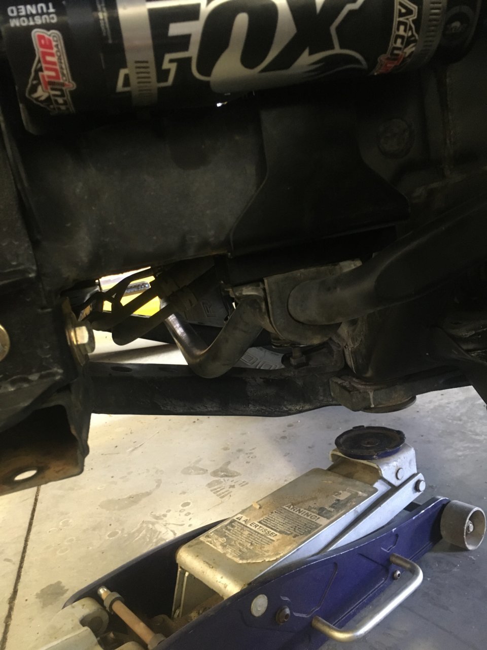

    Got my foxes on… has anyone had issues with the sway bar now hitting the front supports since it got lowered slightly with the new reservoir brackets? I think it’s where my noises are coming from. Are the end links adjustable? Thanks 8F9C8898-36A7-4072-8B65-AC1211BF283A.jpg

    You need the spacers on the sway
    Bar. Should have came with your shocks

    It’s a thing. The end links are not adjustable. I changed my skid plate, that fixed the issue. Then I took the sway bar off completely. That’ll fix it too.

    It may be less of a hassle to try and clean off the black marks on those springs vs deal with a warranty claim. As long as the spring powdercoat is not chipped it really shouldnt be a big deal. Oil that you are showing in this photo shouldn't be a concern since that is the top mounting plate, not the shock body. May just be some oil not cleaned up when putting the studs in. See photo below as reference.

    Fox knows about it. I added washers/spacers to lower the OEM Crossmembers away from the newly positioned sway bar...then 1 month later did the sway bar delete and added TRD skid plate.... and would never go back to having a sway bar.
