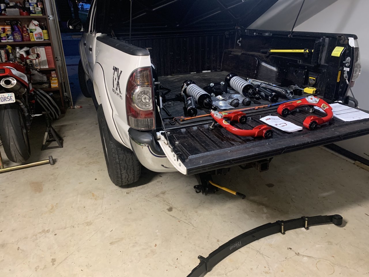

    Just finished the install, thought the job would have been faster, but took time to follow steps required and torqued everything to spec. I’d give this task a 3 out of 5 on the knuckle buster scale for DIY home wrenching. Not super tough, but make sure you have the tool, and prepare to get dirty/greasy…
    Challenges were LCA front cam bolts, get a Diablo blade from HD. Cuts through the bolts like butter. Buy all new OEM LCA hardware and grease them at re-install. Passenger side body was a little tricky to bend to remove the UCA bolt. The sway bar was a pain to reset once putting things back together.
    Thanks to TW folks posting here the tips to make this install straight forward. The ride with the rear RXTs as delivered Stage 1 is very nice, looks that I gained about 2” of lift in the rear (that’s how bad my OE springs had settled). I’m running set of Bilstein Baja kit remote shocks as standby until a new set of Fox 2.0 remotes arrive….hopefully soon.
    For the front those are JBA heavy duty UCAs, which have some additional gussets to strengthen joints. I also installed a set of LCAs sourced from RockAuto. So my truck is riding real nice now. The Fox 2.5 DSCs provided 2” lift up front (600lb springs), need to tweak the drivers side ~3/8” level it off.
    Next stop alignment shop.
    Does anyone have a good recommended initial setting for the DSCs, for hilly country roads, my Baja suspension was great when new, this Fox setup much smoother/damp. Have not run hard on washboard yet.

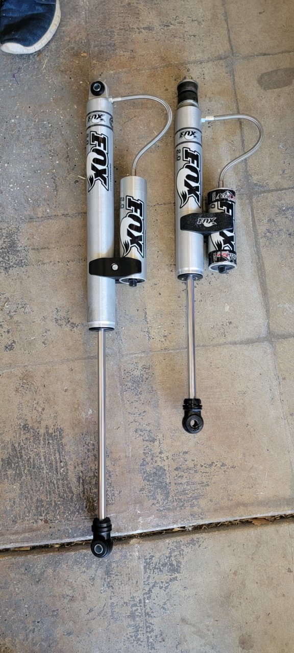

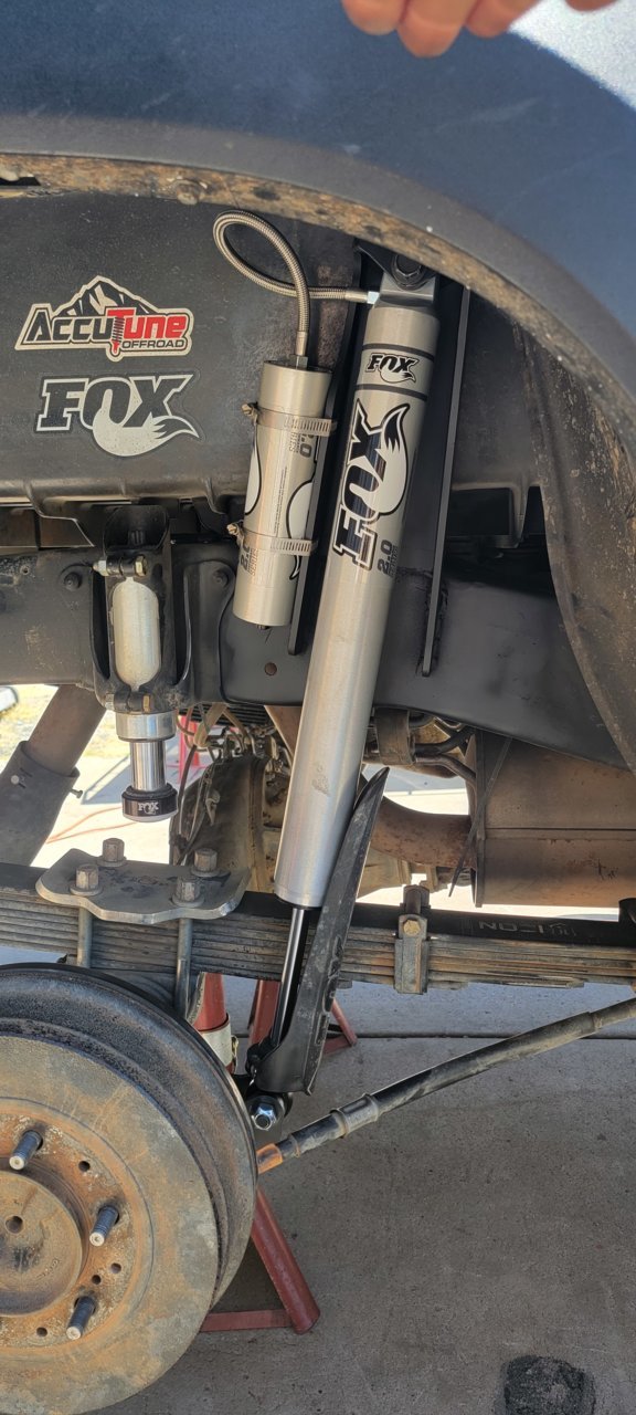

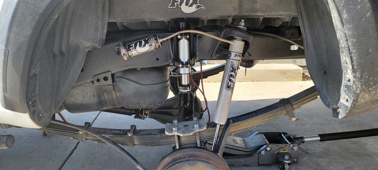

    @AccuTune Offroad i have Fox 12” triple bypasses in the rear. I currently have 7” of the shaft showing. When i installed the shock I removed some of the leaf springs and cycled the suspension to full bump and left about 3/4” from shock shaft showing.
    Been reading y’all’s articles on the ride quality due with the amount of shaft showing. And my ride is a little bouncy in the rear. What’s the best way to fix this with our cutting off the lower mount and welding it back up. Add weight? Remove a leaf?
    Thx,
    Dex
  20. Jul 13, 2021 at 1:02 PM
    #3140
    Vegasstunts
    Vegasstunts Well-Known Member
    Dec 27, 2019
    #314287
    751
    16 TRD sport
    All of them.
    The shock placement sounds perfect if im understanding what you are saying correctly. Seems like a valving issues to me.
