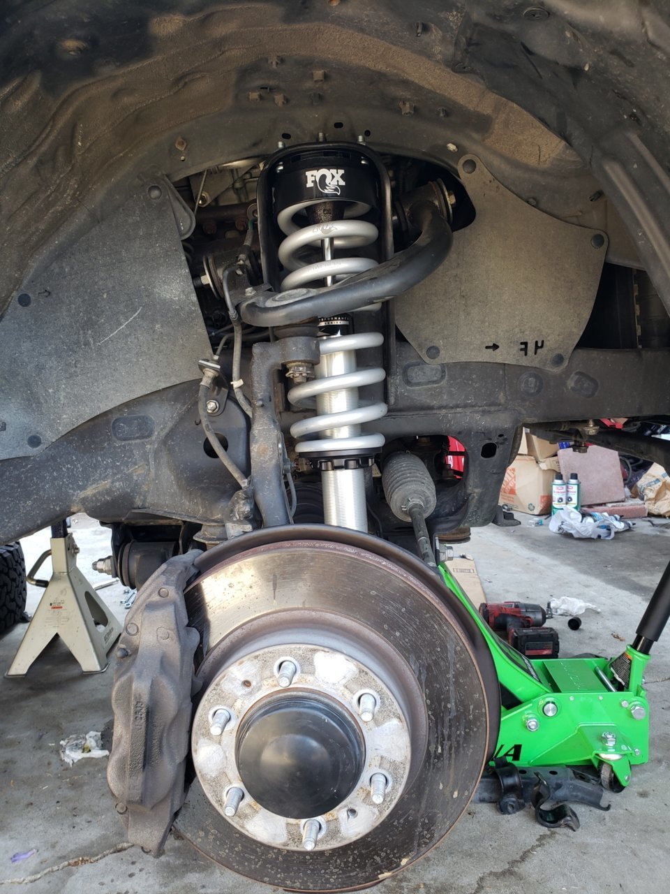

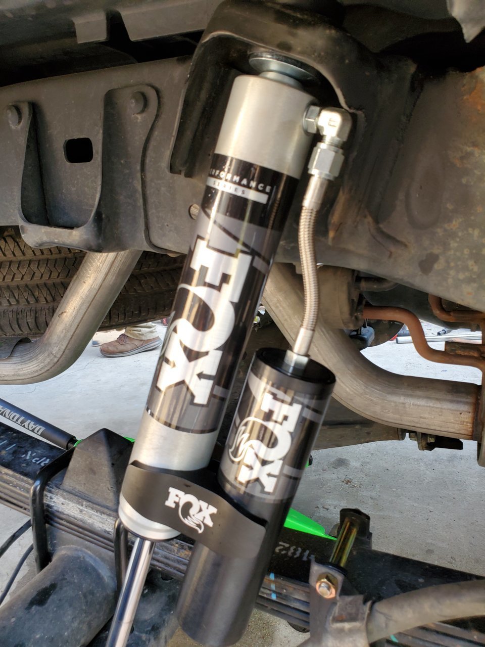

    Looks like you got them at a pretty good price and that is usually the compromise made w customer service. I can’t tell you if they leveled or not because I did a progressive ICON 3 leaf AAL at the same time. The front driver coil was turned 3 turns up to compensate for the lean, and the passenger side of 1 turn down. My center of wheel to bottom of fender is as follows with a full tank:
    DS= 21.75 PS= 22.25
    DR= 22.5 DR=22.75
    *I have a carpeted fiberglass topper (200 lbs?) so it would probably raise the rear by .25-.5” without it.
    Every taco seems to be a little different but that can give you an idea of where your taco might sit. You can definitely turn them. There is another thread specifically on the Fox 2.0s and I think there is a reference for height per every 3 turns.

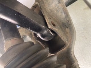

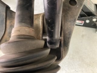

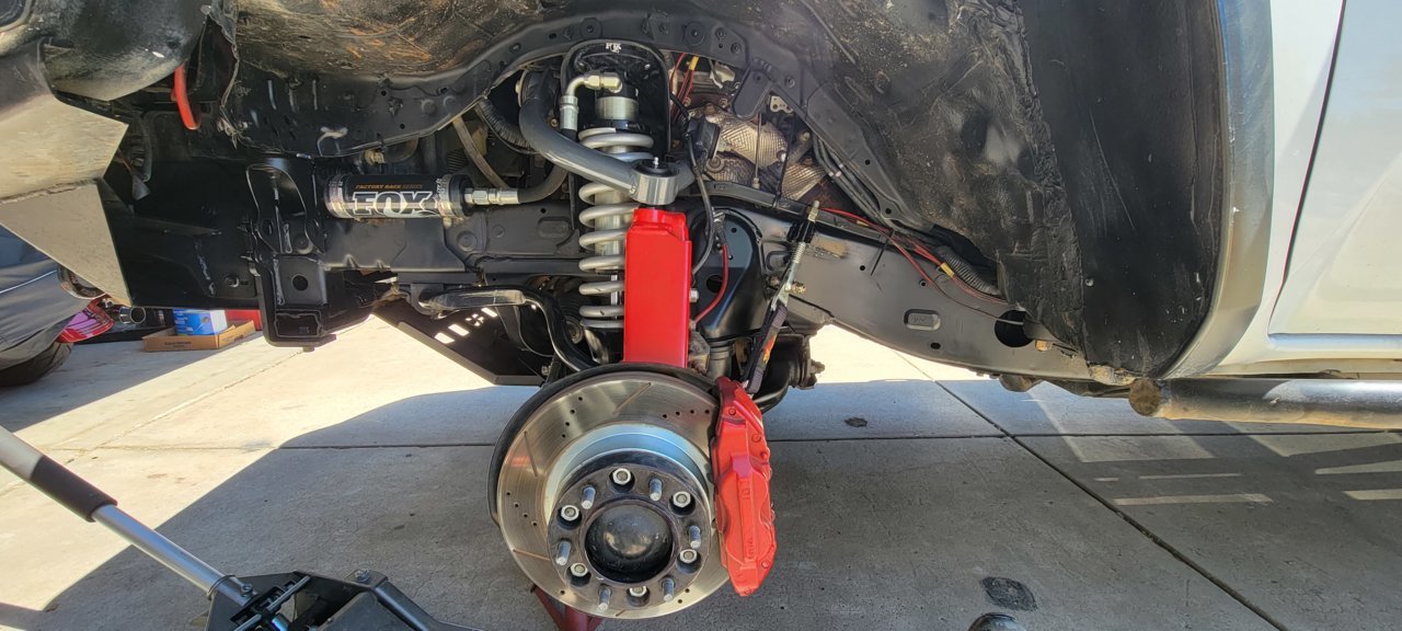

    FYI, one of my lower eyelet spacers were installed incorrectly from Fox. The wide end should face forward on both shocks. Resulted in some minor rubbing/ contact with the LCA mount but nothing crazy. Pulled and re-installed correctly and the coilover obviously sits in a more “natural” position now.
    Other than that, these 2.5s really are amazing. 2AED6766-CD1F-4454-94F9-6365EA4791C6.jpg FC8A758F-192D-46E1-B1CE-77815CAB7F01.jpg

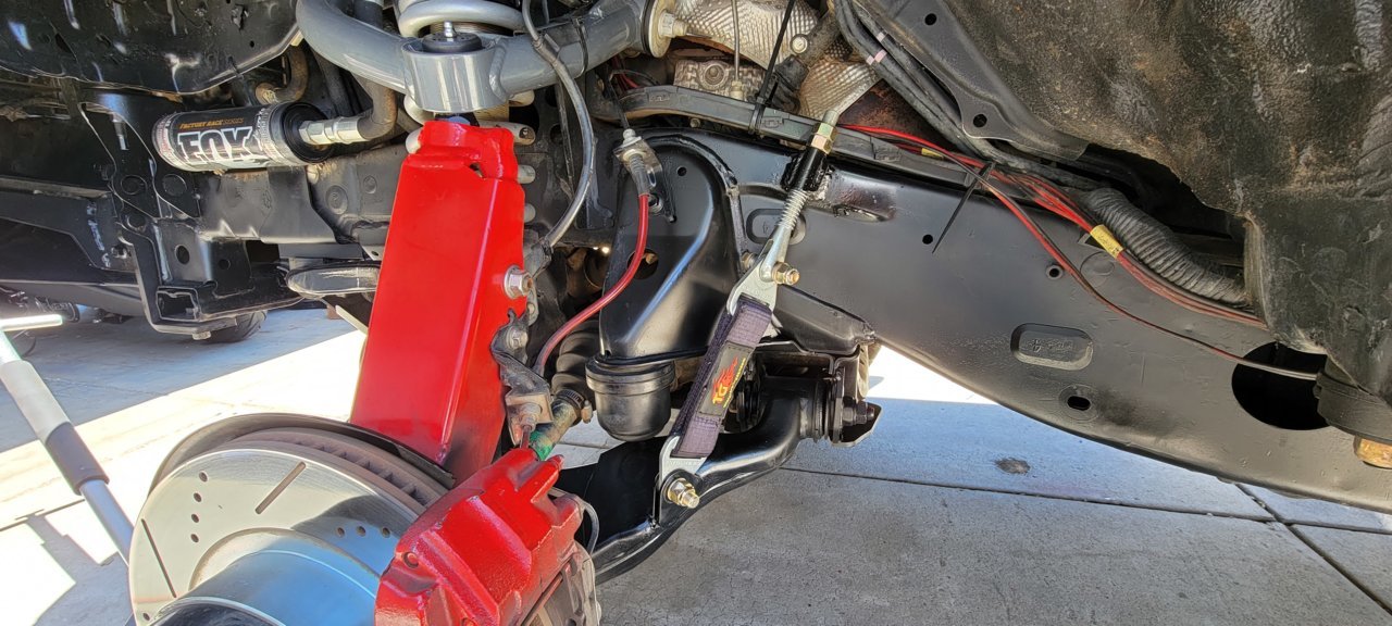

    Burned in some limit straps today to keep the shocks from topping out. Should help prolong the life of them. 20210804_132645.jpg 20210804_132653.jpg

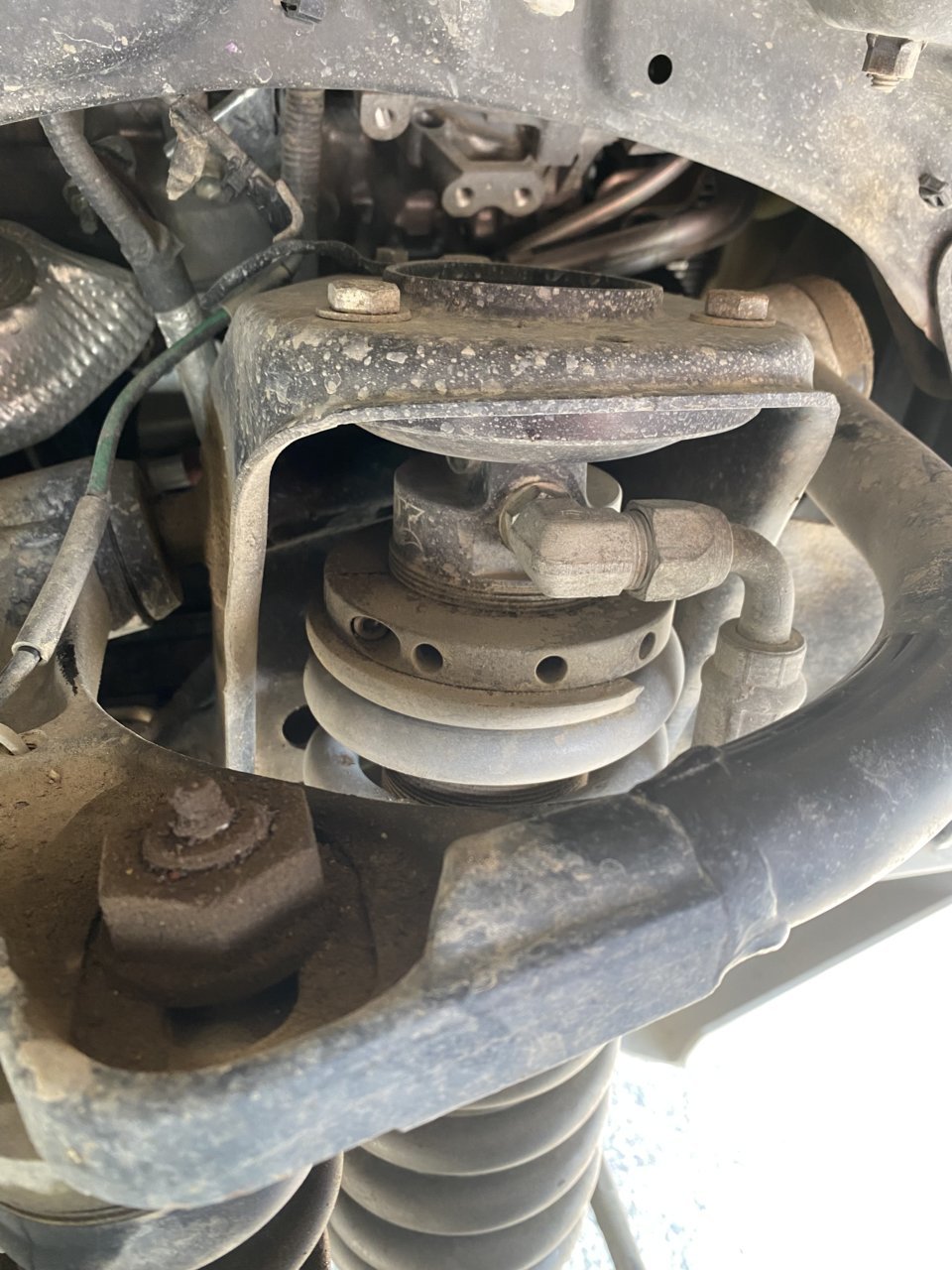

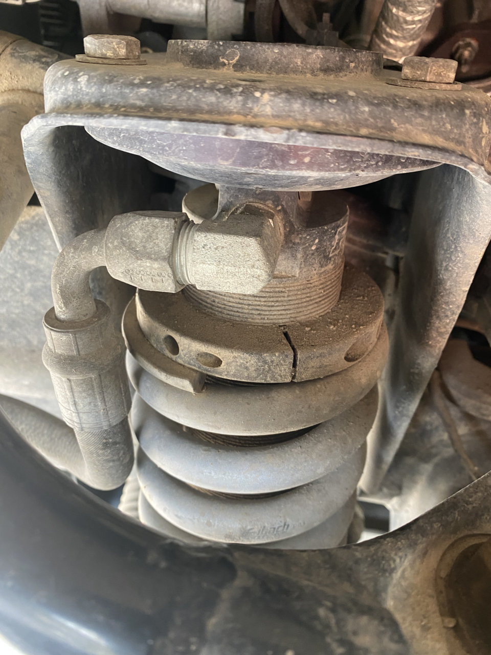

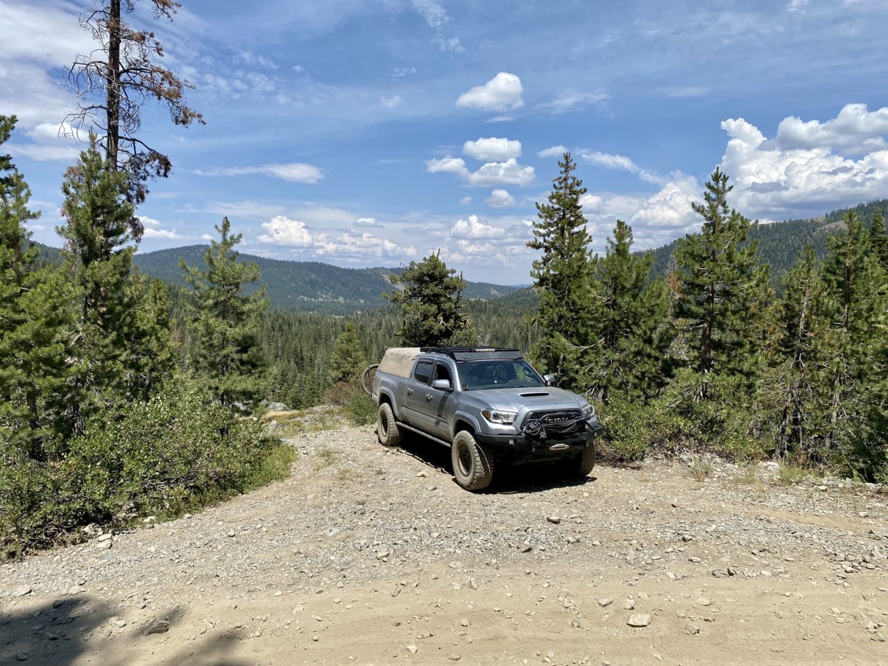

    Honestly, I have no clue what lift numbers are over stock. It never really seemed like I was getting any numbers that were worth a damn to me. But I do have perfect sag setting and stroke up and down numbers for my liking. Here’s pics of the threads exposed.

    @OneNcustdy
    And a pic of the truck with 295’s in case your wondering what it looks like:

    How much front lift do you currently have with the stock Fox 13" 600 lbs coils? How much front weight do you estimate you have added?

    I haven’t installed them yet, they are on back order some I’m in a holding pattern waiting for them to ship. I have my icon billet UCAs and ordering my deaver leaf, but everything will be waiting in the garage until it I do a full day install. I’m estimating the front alone with hybrid bamf bumper and winch is probably around 200lb-ish plus or minus 5-10 pounds. The sliders are maybe around 110 lbs, skid plate is around 70 lbs. That doesn’t include when I do hear up to camp putting the rest of my stuff on.
    So my fear is my desired height is 2.5” with the gear on 600lbs coils I’m wondering if I would have to put a lot of preload on the fox coils. Before I install I’m wondering if I should just replace the coils in advance that way I don’t have to pull them later to swap out for 650 or 700.
